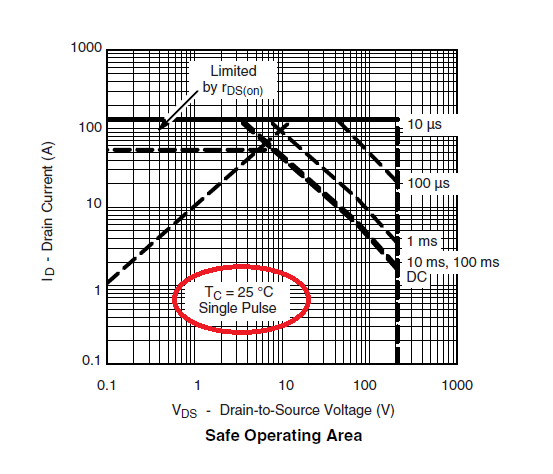

So, I can get 200VDC 57A(here is my FET https://www.tme.eu/en/details/sup57n20-33/tht-n-channel-transistors/vishay/sup57n20-33-e3/ ) but I cant exceed 1500W yes?
About "non contact thermal probes" you mean IR temp. meters(pirometers?)?
Because this I don't have.
maximum temperature is 175C.
This is internal temp. of fet OR temp of fet case, which is readed by LM35?
EDIT: about max voltage, you tell me previously, that max safe voltage is 30V
I would stay within about 1/2 of the DC curve.
I would not exceed 1500 watts unless we can figure out the FET temperature. They smell so bad when they burn. :(
I was thinking IR probe. To can look down at the black case and come close to the FETs internal temperature, then look at the tab and come close to the case temperature.
The 175C is the internal temperature it will be much higher than the case.

You can increase the current that can be set by making R26 smaller. The current should be the voltage on the + pin of the op amp divided by the .13 ohm resistor. But be careful if you test a power supply with a higher voltage you will still be able to set the higher current so the power will be higher.
If the temperature on the fet is 49C and ambient temperature is 25C and voltage is 13.1 volts and 45 amps the power is about 590 watts in the fets. So the temperature rise is about .042C per watt in your heat-sink. From the fet data-sheet the temperature rise from case to junction is .5C per watt or another 30C. So the junction will be 49 + 30 or 79C. About 1/2 of the absolute maximum of 175C. This would make it good for about 1500 watts.
Hmm, It should already be ok for more than 50 amps.
R28=2.7k, R26=68K, R29=5K pot???? If so from ohms law the voltage at the top of the 5K pot should be .79 volts. To drop .79 volts across the .13 ohm would take 6 amps. Times 10 fets is 60 amps.
Maybe you can measure the top of the 5k pot?
