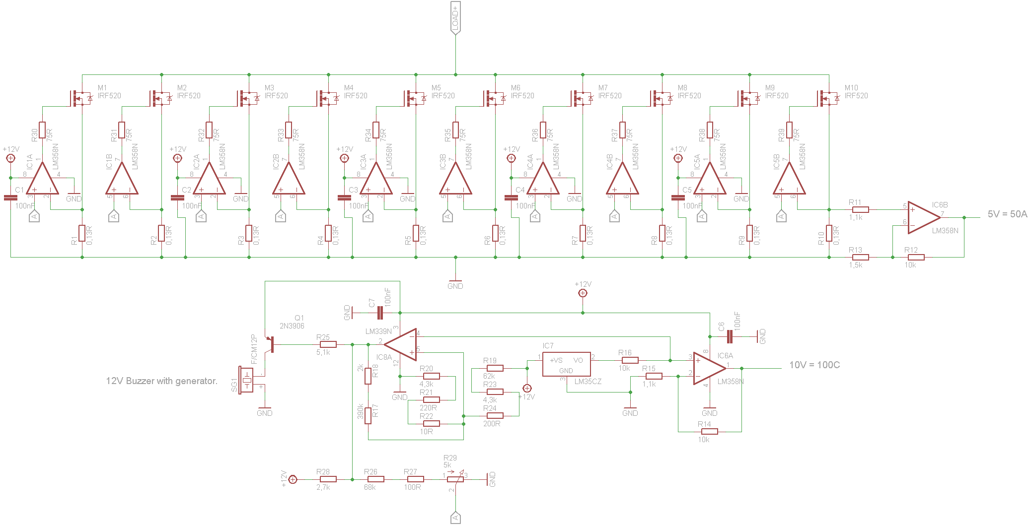

First I draw schematic:

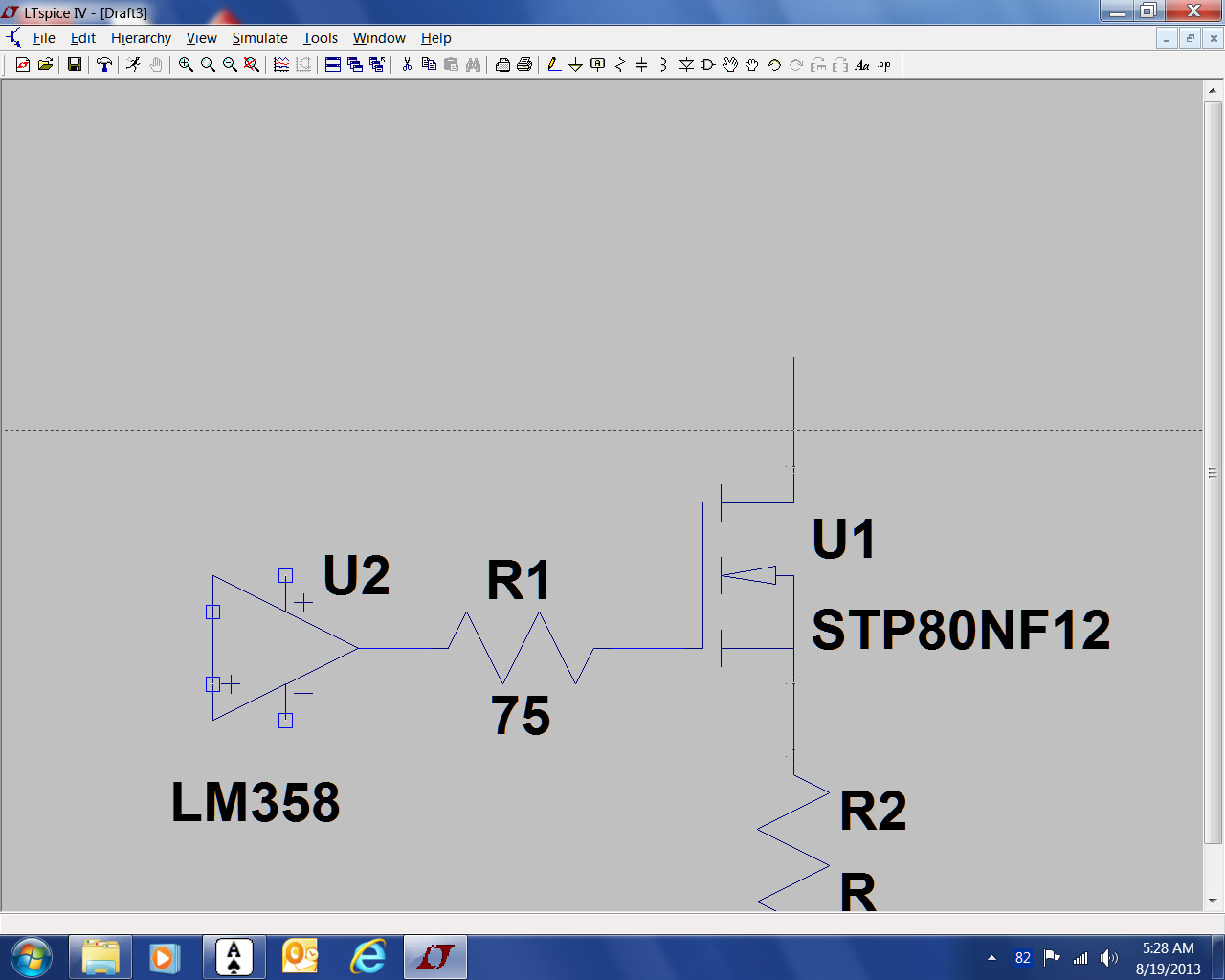

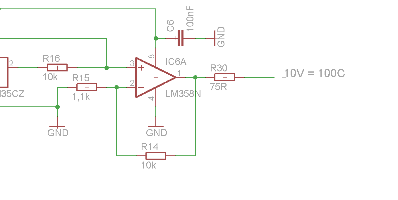

ronv suggest add 75R resistor between the output of each Op amp and the FETs.
Like this?:

Doc, Maybe it would be a good idea to tell us what you are going to do. Sometimes it works better than just going with what is already there. For example are you making a power supply load or maybe a battery load? Why? How many volt/amps?

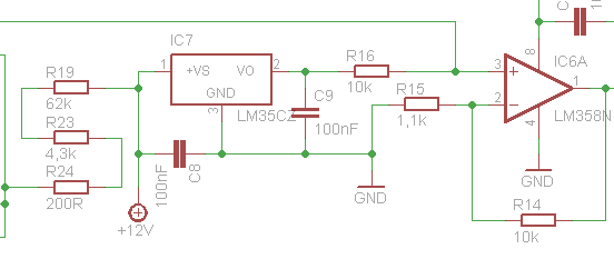

You should put decoupling/stabilizing capacitors from ground to VO and from ground to +VS on IC7, as close to the part as possible.
Linear regulators like to oscillate without stabilizing caps.

Here is where the resistor goes.

Now schematic is 100% complete and good?
Looks mostly good, though you should still put some decoupling capacitors from pins 1-3 and pins 2-3 for IC7.

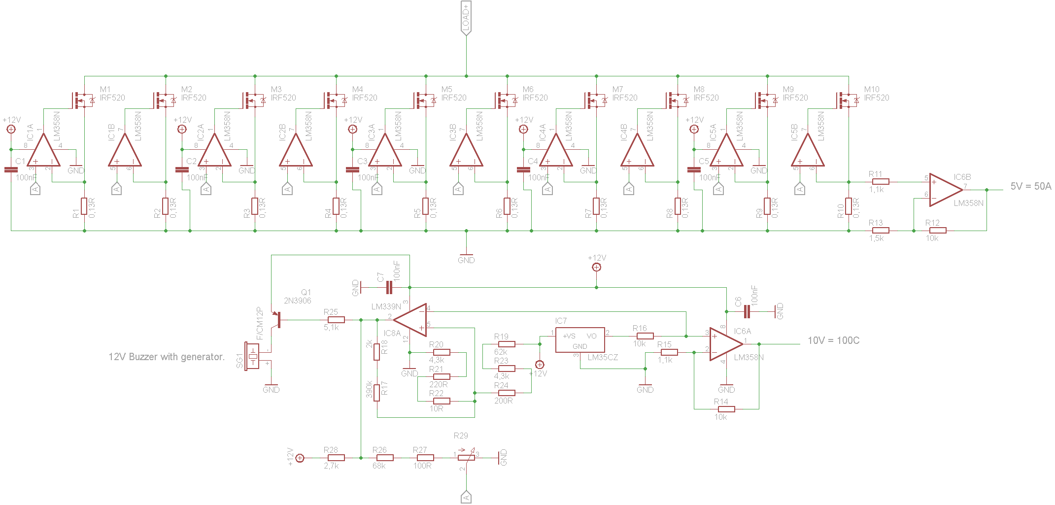

EDIT: Now is good?

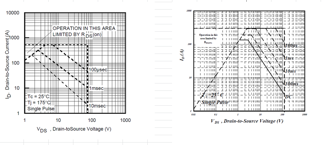

Soa
Here are 2 graphs of safe operating area. One is the 1407 the other the AP92T12 that I posted. Since almost all the power is disapated in the FETs the voltage across them is almost the full supply voltage (25 volts) and about 5 amps. If you look at the curves there is no DC line for the 1407, but if you used your imagination and drew one it might be 1 amp at 25 volts, while the other is good for maybe 15 amps. Big difference. :p
()blivion the block in Doctor's schematic is the temperature sensor not a regulator, so doesn't need the capacitors.

Oh!!!! Temp sensor NOT regulator... i see... i see...
Doctore, the capacitors I told you to add, yeah.............. I'm guna have to ask you to just go and remove those now please :eek:.
I lied, :eek: The last one on your list should work.

Doctore, the capacitors I told you to add, yeah I'm guna have to ask you to just go and remove those now please .
Ok
EDIT: Now is all good?:
