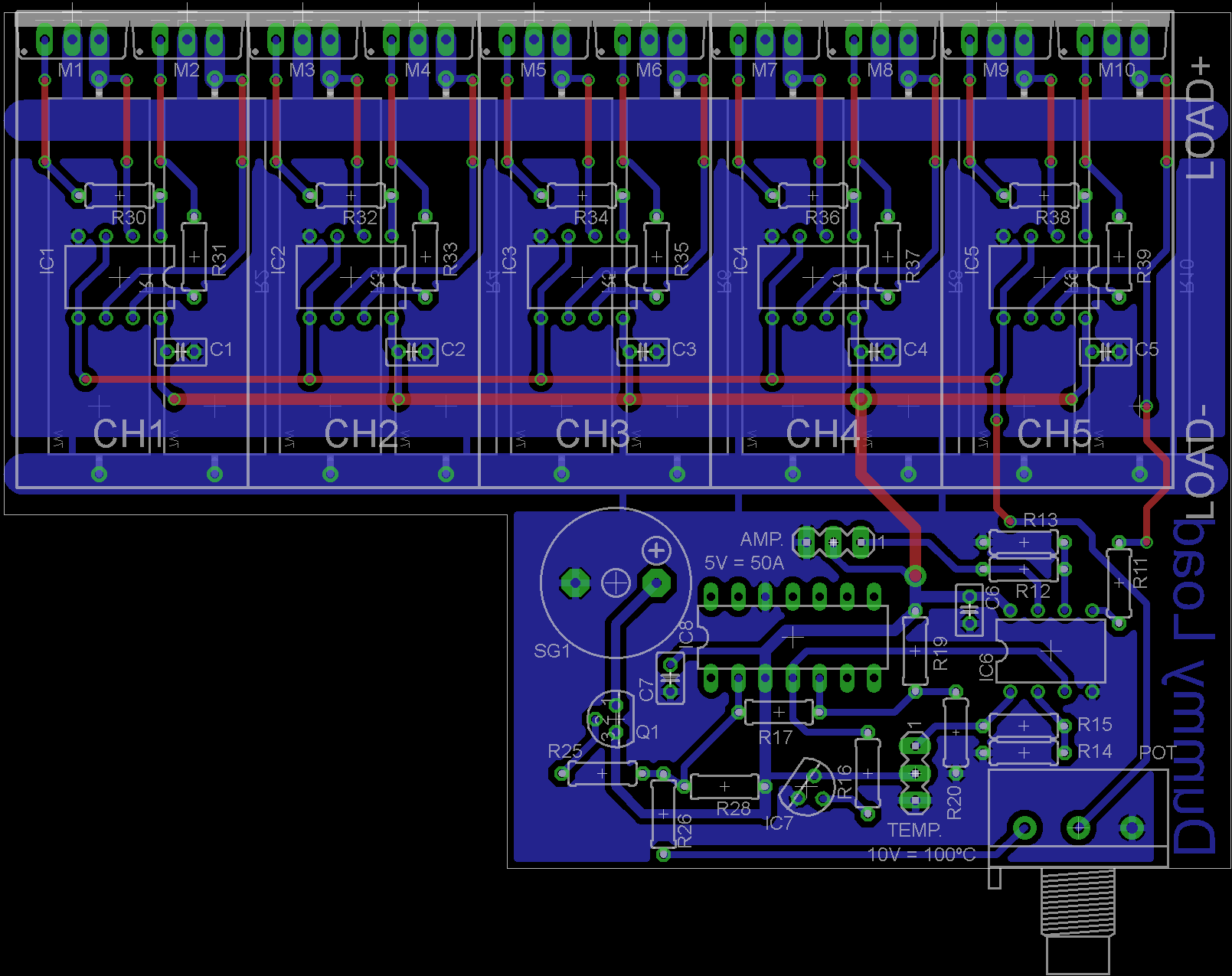

Here is actual PCB:

The meter reads only the current thru M10, so if you use 2 (M9 & M10) the current will be 2X the meter reading. So if it reads 5.0 the actual current will be 10 amps total.

Copper pipe+water, fets soldered to pipe, like in oryginal dl1 :)
So, If I solder only M10 and see on display(w/o dot) 05(0,5V) the true amperage is 10A?
And If I solder all fets, And I get 50 the true amperage is 50A, yes?
The circuit measures only the current thru M10 and converts it to a voltage - 1 volt = 1 amp. So with the dot the meter would read 1.0 for a current of 1 amp, w/o the dot 10. Since there are 10 FETs when the whole board is done if you left the setting the same the total current would be 10 times as high even though the meter w/o the dot would still read 10 because it only measures M10.
If you solder all 10 and the meter reads 50 (w/o the dot) the true current is 50 amps.

Ok, PCB is complete and fets soldered to copper pipe, I must only solder fets to the PCB.
I test PCB and lm35, I heat lm35 and beeper starts at 100C, why?
How to get starting this at 70C?

I have short circuit between LOAD+ and LOAD- when I have power up board, when off I don't have short circuit between load wires, rotating POT does not matter, where is problem?
I'm not sure where load+ and load- is.
With no power supply hooked up to test and power on you should measure .13 ohms from the input to ground. With no current flowing the pot will not adjust because it will try to make current flow.
LOOOOOOOOOOOOOOOOOOOOOL
It turned out that the pot was not a minimum but the max ...
Almost everything works, regulating the load work and load shutdown after exceeding the operating temperature.
The only thing that does not work, it is that pins for AMP/TEMP. metering shows 10x too small voltage, this doesynt show 1v/2A(two fets) but 0,1V/2A.
