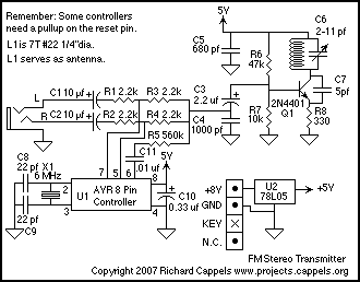

Have a look at this, it uses standard parts:
Same approach as Mr. Lythall's, different execution. No pretension of being hi-fi.
I was thinking of your design in post #8
I have made a couple of your projects mr Cappels, your site is excellent.
Have a look at this, it uses standard parts: **broken link removed**
Hi dr pepper,
Found the 2nd simplest stereo coder by Harry, linked by you. I found all components. I have 4060x2, 4013x2, 4066x4, lots of high speed opamps. One years ago with the help of audioguru, few stages (pre-emphasis, additive mixers) are also corrected. But eventually 4.864 crystal I couldn't get. I searched almost ALL stereo encoder found on internet but all has some limitation for me. But **broken link removed** by Harry looks really great! What can I do?
Wow Dick Cappels!!!
Feeling so nice to see you here on the forum! I am very familier with you site. I said 'the stereo coder by Harry is 2nd simplest' because 'The Simplest' your! I am visiting your site from few years. Few years ago I had talked with you via e-mail too about this. But again what can say....ectually... Here I can find LOTS and LOTS electronics shop but all of them sale parts which can be used on DVD players, TVs and radios. Some shops started to sale whole players, TVs and radio instead of the components because they have lots of benefit. If I bought an IC for FM Rx at $3, China sales entire FM radio at just $1. So components are disappearing. I searched ANY crystal which can be devide down to 38KHz but failed. Simplicity of your device makes me amazing!

FM stereo transmitters are analog and seeing very many home stereo encoder designs that use multivibrators instead of crystals, I tend to believe that the receivers PLL's that generate the demodulation carrier have some capture range and therefore while using a crystal has the great advantage that you don't have to "tune it in" and its drift is negligible, RC oscillators can be acceptable. If you can't find a suitable crystal, then you might want to try an RC osicllator.
For example, using Harry Lythall's circuit, the oscillator on the CD4060 can be connected as an RC oscillator, and the rest of the circuit behaves as before.

The stereo demodulator did not use a crystal and it did not use an oscillator. It simply doubled the 19kHz pilot to exactly 38.0kHz and used it as the stereo sidebands carrier.

I also thought to use any external oscillator like 555 based or like you said RC OSC, but I have no more measurement device than a cheap ($ 5) multimeter. Without an oscilloscope I couldn't tune it to 38KHz exactly. I could tune it by hearing L and R output channel but may be such mechanism wouldn't make me fully satisfied. If I like any device I will keep them with me for whole life. I made a mod 4 simple FM tx by audioguru and I will keep it in my whole life as a symbol of my great project. First time I designed PCB on designer software (ExpressPCB). It looks like a professional because in such work I am so so much careful, so sometime it takes me lots of minutes to bend a normal lead of a component :) . Same way I want to make a better stereo encoder to keep it forever with me. So I wish to make very accurate or controlled by a crystal. :)
