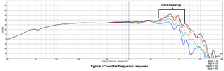

Most people use Name Brand speaker drivers that have a detailed datasheet like most speaker drivers at Parts Express.com. Then the cone-breakup frequencies are shown on a graph and a tweeter that works well at woofer cone breakup frequencies and above can be selected. Then a "speaker zobel network" (look it up) is added to the woofer to make its impedance less at the crossover frequency.
Here is a 5" woofer graph from Parts Express:

Do you have detailed specs for your tweeters to select a suitable crossover frequency> 5kHz is too high since the woofers will have "screaming" cone-breakup at 3kHz to 6kHz.
