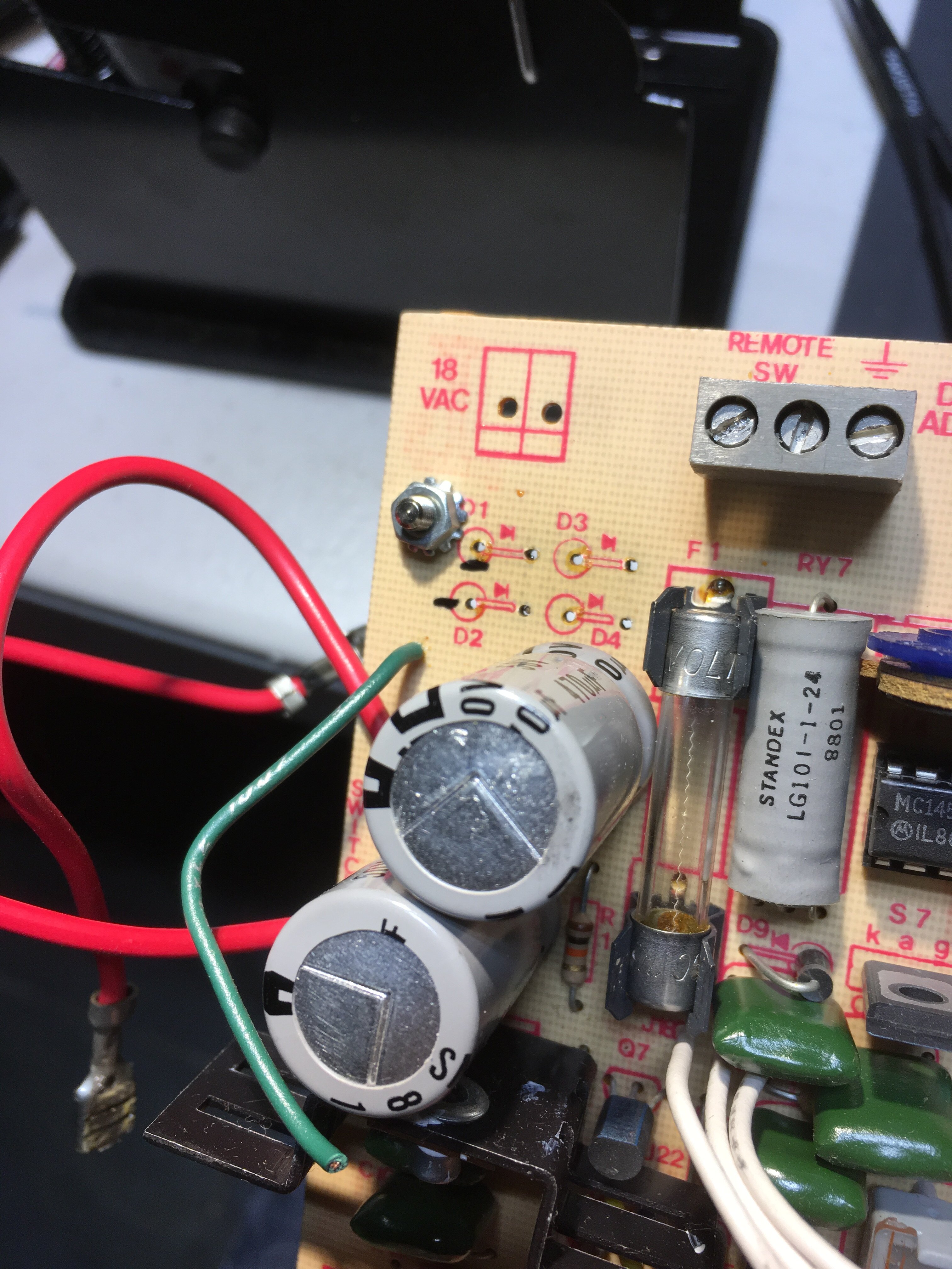

Hi all, got a question where I'm on the fence.
I have an audio system sequencer I purchased used that did not come with a power supply (they never do) and after looking at the PCB while looking for a replacement, I realized the power in went right into a bridge rectifier. Original PS we are sure was 18VAC, and we think the current rating was 2.5A.
After talking with the manufacturer, they were able to confirm that removing the diodes and connecting an 18VDC power source to some locations on the board would work. Positive to the flow side of D3 & D4, negative to the origin side of D1 & D2. After pulling the diodes out, I started thinking about the fuse that I would be effectively bypassing. So then I was thinking should I use jumpers where some of the diodes were and connect to the original power input pads?
It was then that I thought to check out the fuse. It is an AGC 1 1/2A 250V glass fuse. I have never changed something from AC to DC and since the fuse was on the AC side of the rectifier, I have no idea whether the fuse will work for DC. Theoretically it should be fine, but I don't have enough confidence in that to proceed without getting a second opinion. I know that in a lot of furnace control boards they operate on low voltage AC and use ATC fuses, but from my reading fuses seem to generally go DC fuse in AC ok, AC fuse in DC not so ok
Attached are two schematics:
one is the original plan for connection points that I confirmed with the manufacturer
the second is my new thought where I utilize the fuse and add a jumper
Thanks in advance

You can leave everything as is, and run DC right through the bridge. You don't even have to care about polarity. The bridge will take care of that. An 18V x 2.5amp DC power supply should work (RMS). If it doesn't, (If you get some clipping), you may need to go up to 1.414 x 18v (24v) and try that (peak voltage). Either should work because the capacitors were likely charging to near peak voltage since those devices do not run much.
Then you have no worries and the original fuse also works.

Well, I already removed the rectifier assy. because of the voltage drop and because that was the recommendation from the manufacturer. As far as the fuseholder goes, it is already there and I wasn't planning to modify anything to "add" a fuse.
The PS I purchased was a meanwell "tabletop" switching PS, 18V 60W (because of availability and cost at the time) M/N GST60A18-P1J so it has much more capacity than is needed.
I did not cut the diodes when I removed them so I could always add them back in

As you seem to have connected the power after the rectifier, there was no need to remove the rectifier. You have effectively bypassed it by connecting where you have.
If you have an ac device with a rectifier on dc, there are a few ways of dealing with it:-
1) Just connect the dc, either way round. There will be a voltage drop of two diodes. This is what Gophert suggested.
2) Replace two of the diodes with links, and use the original input. That will remove the voltage drop, but there will be no reverse polarity protection.
3) Remove three of the diodes and replace one of them with a link and use the original input. This will leave the voltage drop of one diode.
4) Connect the dc to the output of the bridge. There is no voltage drop, and no need to remove any diodes.

I have not added any connections yet, i have just removed the diodes and the old pin connector for the AC power supply.
I did not want to do this because of the voltage drop. The intent of this device is to allow for specifically timed sequencing on and off of audio equipment and any variance in its operation could damage equipment
RP protection was not something I had thought about but the final assembly of the device was going to have an IEC power inlet on the back of the unit and the power supply installed in a way to where the case would have to be opened to modify how it is wired.
This was what I was going to do (but still remove the diodes at the recommendation of the manufacturer) until I had started looking at the fuse's location in the circuit path which is what brought me here.
The question I still have is whether or not the fuse will be effective or if it should be changed to some sort of traditionally DC fuse like a 32V old auto style because I would like to keep a fusible link in the circuit. I understand that removing the diodes from an electrical standpoint is/was extraneous, but I had already removed them prior to asking for help here (which I absolutely appreciate)

In the original circuit, the fuse is there to stop the transformer being damaged if there is a short. The transformer would have put out 5 - 10 times its normal current if it were shorted, and would burn out if the short continued for some time.
If your new power supply is a switch mode one, the fuse isn't really needed. The power supply should protect itself if shorted. If you post details of the supply that you are using, it should be possible to confirm what it does when shorted.

As the power supply is rated at more than twice the fuse rating, and the power supply might supply up to 150% of its rating, then you should leave the fuse in circuit unless you have carefully considered what could cause an over-current. However the fuse isn't needed to protect the power supply any more because the power supply won't be damaged by overload.
I agree that having a fuse will reduce the damage on the board if part of it fails, but that is only of use if the board can be repaired or something else removes the fault. If faults are permanent, and can only be fixed by changing the whole board, the fuse becomes fairly pointless.
