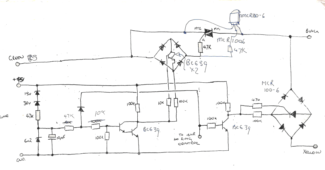

I did this for my INFINITY BUG. It suppressed the first 3 rings so the caller could ring back in exactly 40 seconds and the phone would get picked up by the bug so the caller could listen to what was happening in the room.
