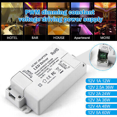

The cables for the LED light are significantly smaller than the mains, is that a problem? If so, how to rectify? Is this what I need? Full Power Led Driver AC110-240V Dc 12V 2a 24V 1a Led Adapter or https://www.ebay.co.uk/itm/164958853389 or https://www.ebay.co.uk/itm/394682169824?itmmeta=01HXCC7AKMR641MM9F4AJ4DYRM&hash=item5be4e3f9e0:g:SEEAAOSwALFki5Sa&itmprp=enc:AQAJAAAA8G7AEIBtOLMDx2cQIM0P1Snp9xttUcmH1+bWyq5e9BfvHFUCrJuh4U2z/QX+jxdxOHBDZjYUqssGA7ebMptODrIcmjba/Qfqb6S2+wN97UN+L3sUSamTXiA7ZTuiL8wlBOBfhh0aZ7+7NwfupjnBHScTcPInZBaMQMRrZUrysJuZhNHZ09bz5fF4jW9okNYk+lllx85HPD2FgTj2oK5l5iw8+wX20l5hK4bcxigx9TP+IZkQdLpq9pwoHkm9CMeQ2of8yQ/wOdMNo69HhTPpZa1bdthNFR8WCf1ObR1lqcLSd7fyFUUbyE/qWKwU5tCJaw==|tkp:Bk9SR_6pnYzrYw ?

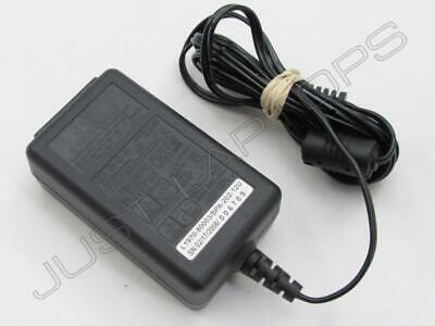

Something like this:

AC 240V to DC 12V 12W-60WAC 240V to DC 12V 12W-60W Dimmable Transformer Power Supply LED Driver Adapter Dimmable Transformer Power Supply LED Driver Adapter

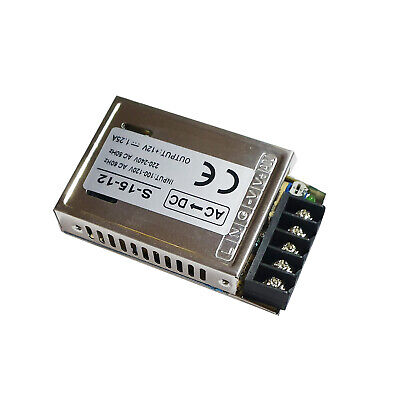

The first one you previously linked to looks ok - it's just a mini 12V PSU, similar to the one from CPC:
The "LED Driver" has a very ambiguous description; it cannot "dim" at constant voltage - that needs current control. None of the modules show seem to be marked dimmable though? It's just not trustworthy, the seller does not seem to know what they are selling - so no guarantees what you may be sent!

(Those are the dubious led drivers - nowhere on those does it say dimmable?)
I've ordered this to drive this:
LED Driver Power Supply Transformer 240V - DC 12V for LED Lighting
