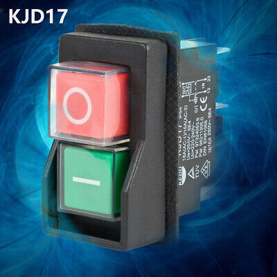

For the machine start/stop, look for a "no volt release" switch on ebay. There are various styles, either surface mounted or through panel.
A couple of styles:

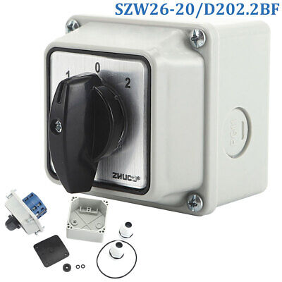

Add a separate (AC power rated) light switch, either a simple on-off and taking power from the motor side connector, or a three way selector switch, with centre off, one way taking power from the motor side and the other way taking power before the motor switch.

I've ordered the first NVR you linked. Thinking of mounting it facing forward on the left side of the machine like this:

Would this work as a three way switch? https://www.ebay.co.uk/itm/254230122628

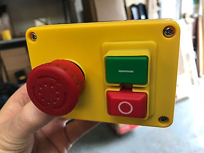

Everything has arrived. Including 1.5mm twin and earth cable.
Could you please explain how this is wired up by adding coloured lines to the images? The original switch had ON / OFF. This one appears to have contacts on the ON / OFF and the emergency off button. This suggests the cable from the socket is connected to this switch first whereas the original wiring goes to the big block and from there splits off to the switch and motor originally.

It should be as the drawing on the slip of paper, for the stop and on/off switch.
For the circuit breaker, connect power in to eg. L1 and L2, take the output from T1 and T3, and add a wire from T2 back to L3.
Connect the earth through and to the machine frame.
