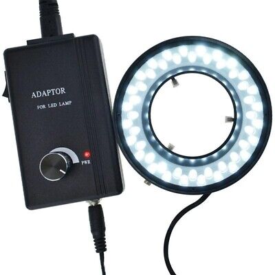

Am I going to need an LED driver (2V 24V AC DC Adapter Charger Power Supply Driver Transformer for LED strip 240v) or AC to DC Power Converter Module 12V 1A Switching Power Supply Board AC 100-240V?

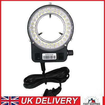

There are numerous variations of ring lights, which are commonly used with microscopes - are any of those usable or adaptable?
Some examples:
Thanks for your reply. I found the ring lights that I bought for this project, it's 12v. I presume the little board is a voltage regulator? That's what I would need to fit to the aluminium ring with a tang right? How is that then attached to the flexible neck piece?
