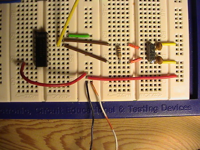

I have tried the trick with a radio, but with no luck though. :? Here is a picture of the actual circuit setup on a breadboard. Using a 7.680Mhz crystal instead of the 4.096Mhz.

You might get that to work if you change the inverter to 74HC04 as suggested, and add a 100nF (0.1uF) capacitor between VCC and GND, with leads as short as possible. You could try it across your power rails (in the center of the picture), but right across the IC , pins 7-14, would be better.
Those breadboards have notoriously high stray capacitance. If you could shorten the wires, you would have a better chance. Stand the resistor on end, squeeze the leads of the crystal close together (you may have to extend them by soldering on some short bare wires), and move the caps so that all the parts go into the pin 12-13 buses (except the other ends of the caps, which you can stretch and bridge over to your GND rail).
A better option is to build the oscillator on a little piece of perf board that has a GND plane (or at least a good GND bus), and make it really tight, with the power supply decpupling cap added as mentioned. You only need 3 wires from the perf board to your breadboard.

TTL has a much lower input impedance, wich might stop the crystal oscillating. CMOS input inpedance is typically very high
The big problem is input current. The one meg feedback resistor won't come close to biasing the inverter in its active range. If you make the resistor small enough to satisy the bias requirements, the resistor will kill the "Q" on the crystal, and it won't oscillate, or at least won't be very stable. There are schemes that use TTL gates to make crystal oscillators:

YES! I got it to work! It's alive! ALIVE! *dancinghappydance* :D
Thanks all. I used **broken link removed** changing the 1.2k resistors with 1k ones, and using a 74LS04 chip despite the 74F04 that have been used there. The cap used was torn from an old powersupply in a desperate effort to make the crystal oscillate when the 22pF and 39pF failed to do so. I also kept the wires as short as possible, and now it works!
