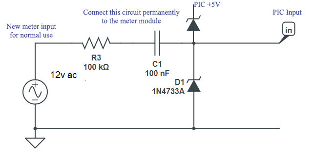

I have prepared the picture you requested in the form of a schematic and block diagram for you to help me, is it possible to measure the frequency of city electricity and the power transistor of switching power supplies with this module and what points should be observed so that the module is not damaged؟
The "pulse input" does appear to connect directly to the PIC, as augustinetez thought it may.
That needs over voltage protection and a very high impedance feed to avoid damaging the PIC.
I'd add two schottky diodes from the input pin to 5V and 0V, so they conduct if the voltage goes beyond the PIC supply rails.
Then a series resistor and capacitor directly at the module input, eg. 100K and 0.1uF, to limit the current to the input pin. That should work fine for low voltages, 5V peak to peak up to a few tens of volts.

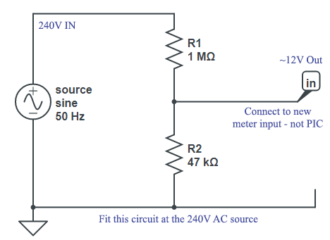

For measuring 240V power, use an additional resistor divider, eg. 1M from live and 47K to AC ground, directly at the point you want to measure.
Connect the above protected input from the junction of the two, so the added meter input circuit only sees around 12V RMS.
(Hypothetically, with the voltage divider plus the 100K series input resistor, the PIC input protection diodes would only have a fraction of a milliamp through them, so the schottky diodes should not be needed - but I'd rather not risk damaging it for the sake of a couple of extra diodes).

Those are the two sections I meant, or near enough - but the second one would be permanently connected to the meter, and the output of the high voltage one (about 12V out) would connect to the input of the low voltage one.
(Also, another schottky diode from IN to the meter +5V to protect it from anything higher than the PIC supply voltage, in addition to D1 protecting it from anything below 0V).
The meter PCB photos show two different versions, with different input pads as well as extra components; if you have one with the crystal tester components fitted, you may need to remove whatever of that connects to the PIC input to prevent it interfering with the external input.

I did not understand what you mean, if possible, draw the circuit for me
OK:
This part converts the PIC logic level input so it's safe for general use at low voltages, so should be permanently connected to the module; fit it in whatever casing you use for that:
And this attenuator part, to fit at the 240V source being measured, reduces the voltage so it can connect to the above circuit:
If you are going to probe different AC sources, build the attenuator in to something like an old ball pen casing to use as a handheld probe and use screened cable to connect to the meter part.

In this question to measure line frequency , one simply needs a low freq amplitude into an ac coupled CD4001 inverter With R feedback for self bias and ESD protection if desired, or similar at PIC logic levels, power supplied by PIC to drive the input port. It measures down to 1 Hz, so you won't get high resolution, maybe +/1 Hz.

verify below before doing above . 5.1V Zener and Vf reverse may be too much
5.1 V @ 47mA using this model with 12V rms you actually get 10% more typ. with no load on transformers so assume exact input V output is 13.2rms no-load.
Then with this Zener model due to 100k Vp,Ip are; +5.01 V and -10 mV at -155 uA pk sine so Good.
I like using simple Falstad's browser simulator OR any tool you know how to specify exactly.
Once you have verified and understood diode VI response, you can do this approx in your head.
What if you had no 5.1 Zener diodes? Could you use Schottky diodes? yes, Silicon Diodes ? yes, No diodes? yes but only if very low current xx uA as the internal ESD protection shown below in all CMOS devices (within wide R tolerances) say even when you see almost +/1V on the input ,the two stage std CMOS ESD protection will PREVENT SHOOTTHRU FAILURES . The ABS.MAX assumes low impedance on 300 mV overshoot.
Also Note in datasheet above the RESET low drive suggests adding 100 Ohms is series necessary to dampen high Q LC resonant undershoot due to trace L = 1nH/mm and Cin 3 ~6 pF typ. This is because CMOSdrivers in 74HCxx 5V drivers are ~ 50 Ohms +/33% typ which still cause over/undershoot, while adding 100 Ohms guarantees most traces to not be underdamped.
This shows that the dual Zener method works best yet, no diodes also works safely when you understand the current limit and ESD internal protection.
