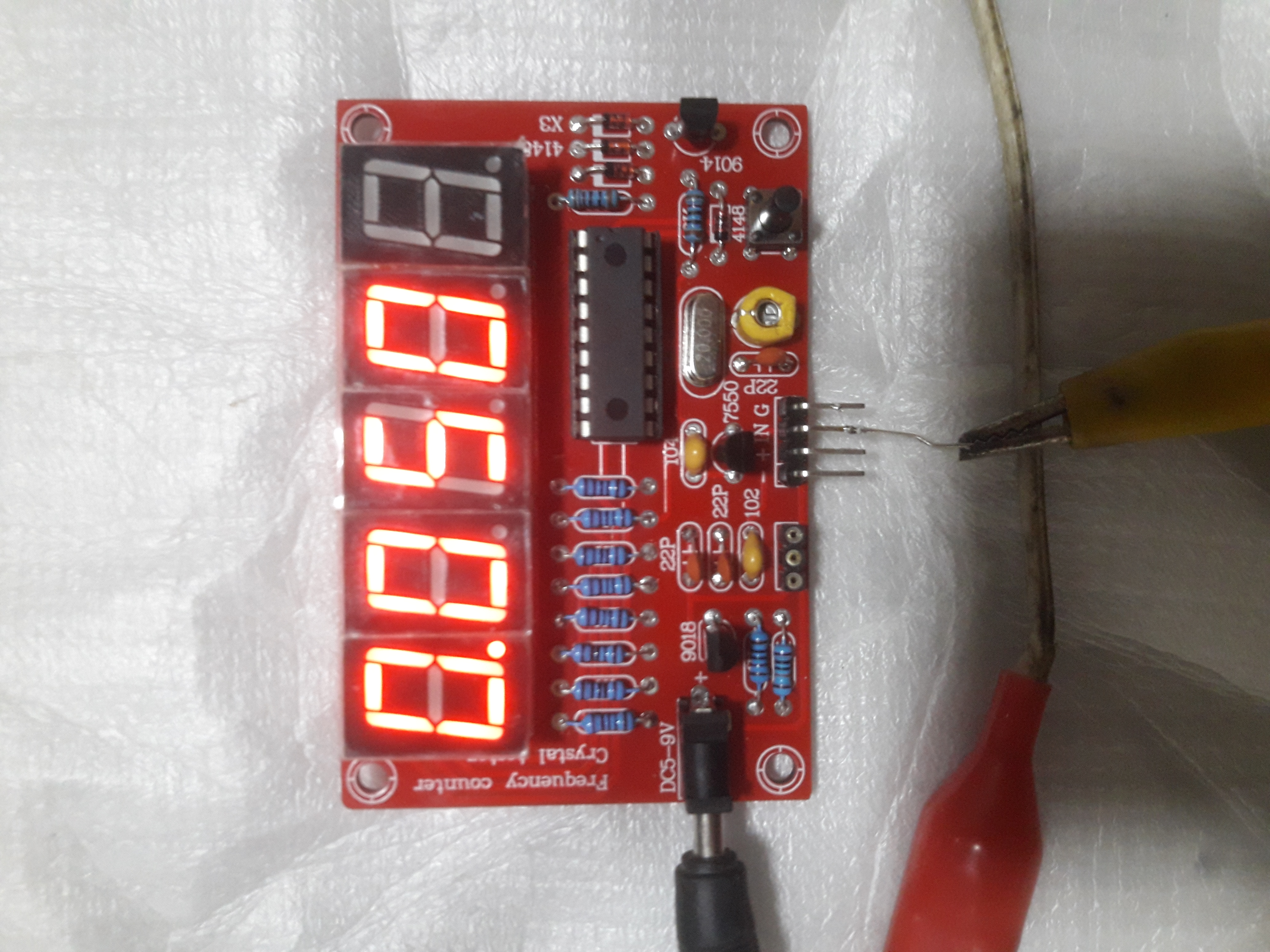

Is it possible to measure city electricity frequency and pwm peak of power transistor with this module? How is it possible?

I am implementing the circuit test and check on the board, are both zener diodes?
D2 goes to which IC pin? And can I put D2 fast?
They should both be Schottky diodes, not zeners. eg. BAT48 or any schottky signal diode.
Schottky diodes conduct at around 0.4V, compared to normal diodes conducting at about 0.6V
The top of D2 connects to the 5V supply somewhere on the module - it goes to Pin 14 on the PIC according to the diagrams of the module that you posted earlier.
It's a very common circuit used to protect IC input pins from excess voltages. If the voltage is negative of ground or positive of the positive supply, one or the other extra diodes conducts and stops the voltage getting to the point the IC input circuit can be damaged.

I implemented this schematic and sent the result in the form of photos
%DB%B2%DB%B0%DB%B2%DB%B4%DB%B0%DB%B1%DB%B0%DB%B7_%DB%B1%DB%B7%DB%B1%DB%B5%DB%B0%DB%B4-jpg.144036
The photo above shows the yellow test point wire from the collector of the 13001 transistor leading to the primary of the Chinese 5v 0.5A charger transformer.
The purpose of the experiment was to measure the high voltage pwm frequency

I did the test, I sent the video, you can see, for a moment, the display shows the number 0.001, then it goes back to zero, is that number pwm switching frequency?
10khz?
Or is it a filter number related to noise?
which is it

I proceeded according to your circuit, but the result was different, as if the module and source were shorted, I sent the video of its review below
test and analys this video
Go back and read posts 12 - 14 again.
The 100K and diodes circuit is protection for low voltages only.
You need the extra part with the 1M and 47K divider wire before the low voltage part for high voltage inputs such as the SMPSU primary.
How have you isolated the AC supply to test the SMPSU?
Note also that breadboards and long open wires are not good at high frequencies.
I really went ahead with what you said, even my reports and results are not abstract, I sent them all with pictures and videos, I implemented the circuit on the board without a single error, but I could not achieve the work and what I wanted.
I bought this module so that when I don't have an oscilloscope, it will be my tool to measure switching frequency and pwm voltage and high frequency with this device.
So where is the 1M : 47K divider, prior to the 100K and diodes?
Unfortunately, I don't understand without a circuit diagram
12 volts ac is not important, it is important to measure the high voltage that comes from the collector and drain and the base and gate of the transistor for each of the activities, I do not know what I should do to achieve the desired demand and the frequency can be shown by the module
It was a resistance division for city electricity voltage, are the same resistance values suitable for the city electricity peak which exists as pwm from the drain and collector of the transistor?
