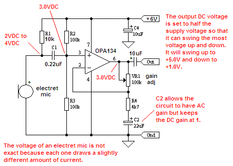

check this schematic...the power supply is 6V and this op amp has half the supply voltage mixed with the signal of an electret... this probably means a DC offset of 3,1V! at it's input pin :rolleyes: what do we expect as an output after the coupling capacitor? let's say the gain is 20...do i expect 20 times the electret voltage? if yes...probably there is a DC offset in that voltage that's way there is an output capacitor, what's the outcome after the capacitor?

The opamp has a DC offset of 3.0V as explained here:
