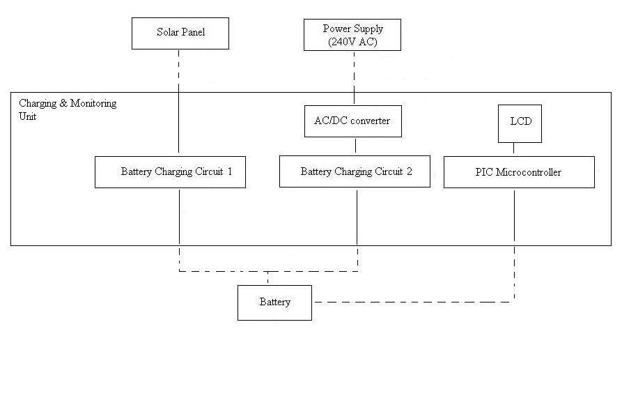

Try telling us EXACTLY what you are trying to do, with what voltages and currents, and why - it's been so long, and so many different threads, I'm losing count :lol:
Sorry, hope you're not mad. As shown is what I intend to do.
(Dotted lines indicate detachable while the box shows the Charging and Monitoring Unit)
All this while, we have been talking about Battery Charging Circuit 1, which is the Boost DC/DC Converter. Was thinking to develop this circuit in such away where one can use different types of solar panels. Meaning, as long as the panels are needed to be boost to a certain level, it can be used. Thus, I was thinking to develop a circuit that takes into the consideration of preventing overcharging as well. I thought there are certain panels that are capable in doing overcharging this 12V 1.3AH battery? Thanks.
And just to reconfirm about the circuit posted on page 7, entitled Boost Converter. Can I implement that, with the changes such as a MOSFET, a zener diode and the PWM from PIC?
I would suggest that's not a good idea, trying to design your solar panel charging to accomodate any panel size is going to require comprimises - the worst point of which is that you are going to waste much more power than you can afford with the small panels.
MicroChip do in their PICKIT1 programmer, have a look at it - it even generates 13V which is pretty close to what you want!.
You could prevent over charging with the PIC as well, monitor the battery voltage and if it gets too high then reduce the charging rate via the PWM.

Did you ever decide what your panel voltage and current were going to be? I missed that.
Sorry for my late reply. Thanks for that advice. I will now stick to one panel, at this moment, most probably the one with output voltage 7.5V.
At this point, it would be an output voltage of 7.5V with the load current of 40mA. Thanks.
Say you want to use the average, optimum 40mA from the panel. If you have a 20mA peak-to-peak ripple due to a small inductance, the current will vary from 50 mA to 30mA. Look at the i/v curve for the cell. The voltage will drop to next to nothing if you try to draw 50mA, the power output is low. At 30mA you're not using the capacity of the cell. Now an input capacitor will help this to some degree, but it's not a magic bullet since the ripple voltage is much less than the current ripple due to the i/v curve of a solar cell. Caps are not as effective in this scenario.
