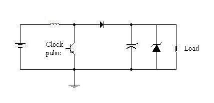

No, the current THROUGH the zener diode, as I've no idea how it's connected I can't suggest what that might be?
Sorry, I was thinking to contruct the zener diode in this manner. I tried simulating without the zener diode but I couldnt get a constant output, so I was thinking to add on the zener diode.

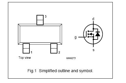

:?: Would like to ask regarding MOSFET. Mind to briefly explain the purpose of the diode found in the MOSFET? :oops:
Thanks again.
This isn't a good idea! - the whole point of the switchmode supply is to make the most of the limited available power, this zener on the output is going to waste most of the power that the panel provides!. To regulate a switchmode supply you apply feedback to the switching circuitry, this then regulates in an efficient manner.
Thanks for "saving" me. Thanks a lot. But I tried simulating the boost DC/DC converter without the zener diode and I couldnt obtain a constant or steady output. Is this simply because of my wrong selection of capacitor and inductor? Mind to give some hints on how should I determine the capacitor as well as the inductor value?
