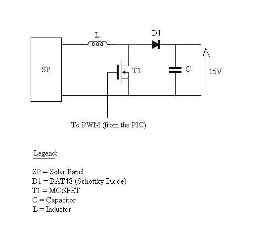

Hi there,
After all the guidance and teachings from you guys...As attached is the present circuit which will be used for the Charging Circuit 1.
In the meantime, I hope that this would be a great news as we are now given a better solar panel for this project. The solar panel will reach our hands by next week and I run a test on it to plot the IV Characteristic of it. However, according to the datasheet of the solar panel, its output voltage is 7.5V whereas the current at load is 150mA.
(The one earlier was: output voltage = 7.5V, current at load = 40mA)
:arrow: With reference to the attached circuit, the value of the inductor and capacitor is still under consideration. Is it true that proper selection of the inductance and capacitance value can only be done through testing to see the ripple? Or calculations can be done? :oops: Nway, I'm working on it to get it done as soon as possible, thanks.
:arrow: I'm still searching for the appropriate NMOS transistor for the MOSFET.

Hi there,
I would like to ask about something that I've miss-out in developing the DC/DC converter. Recently, I come across something called operating the converter under continuous mode or discontinuous mode. But I don't really get what is/are the differences between these two. Do you guys mind to brief me on this matter? Please?
Thanks in advance...
Need advice...
Hi, hope you guys don't mind to throw me some opinions.
Now it seems that my boost DC/DC converter is not practical or "not being a useful device if manufactured" as I obtain advice from Klaus that I shouldn't do this, which I think his words are very true.
