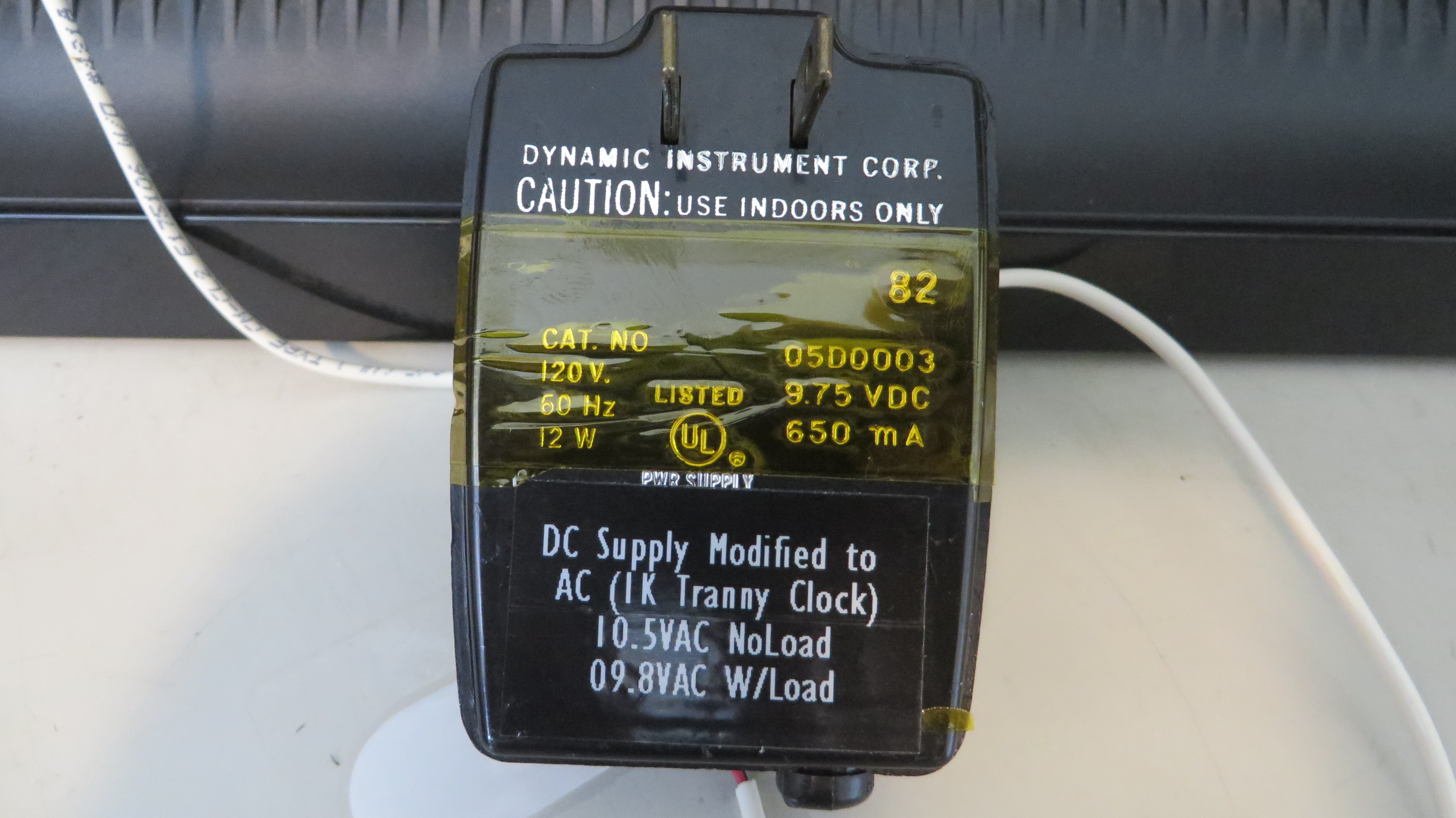

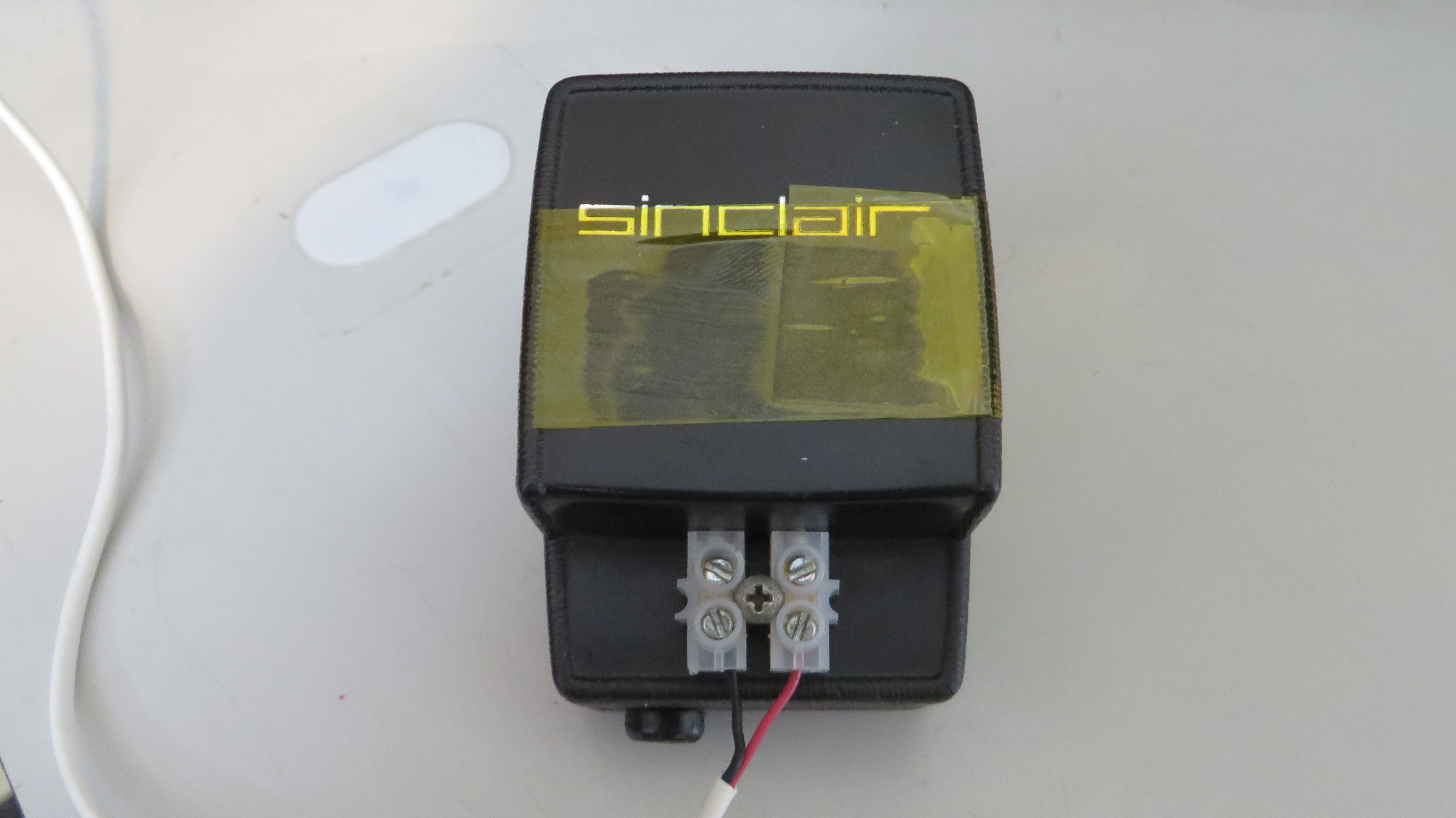

It seems I have no shortage of DC power adaptors - at all! Occasionally I need an AC version; for example, clocks requiring 60Hz for time base.
Given a needed AC voltage, which DC power adaptor voltage rating would you experts select to break open, pull out all the DC conversion components, retain just the transformer, and then glue the whole thing back together again?
Should you try to match the desired final AC voltage exactly? Or select one that has a higher or lower voltage than the target?

You can also measure the open circuit voltage. If the open-circuit voltage is maybe 40% higher than the rated voltage, it's almost certain to be a linear, unregulated supply.
Switch-mode supplies are always regulated so the no-load output voltage is very close to the rating. There are regulated linear supplies which will also have a no-load voltage near the rated voltage.
In either case, the weight is a dead giveaway :D
Measuring the resistance between the mains input pins will also tell you if it is switch mode or one with a normal mains transformer. Switch mode ones will read a few megohms. Ones with a normal mains transformer will measure a few hundred ohms.

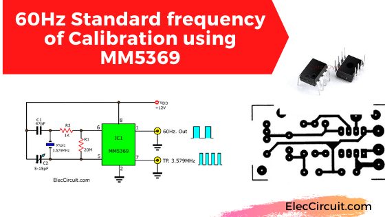

In 1978 I had a clock used in factory automation that uses 60hz from the power line. The clock did not keep time well. I tracked it down to every time the elevator motors turned on there was an extra pulse added to the time.
60hz See link to a good stable 60hz without the power line. I made the circuit in the link and disconnected from the power line. The IC is not made now days. I found then on ebay.com just now.
