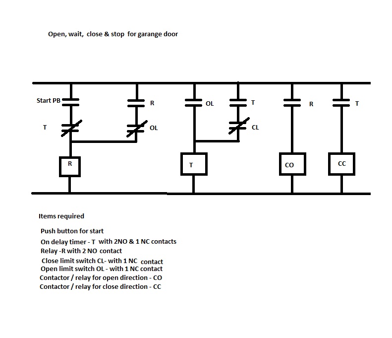

this can be done in different way too, if you are interested i can post you the schematic. as i understand you just have to press a button and wait, it will go, stop wait and return to the same position and stops. then you press again to start the next cycle.
No wait at start.
I have attached another way to do it with relay and timer. for timer you can find it ready or still you can make one for you. i hope you will understand this diagram.

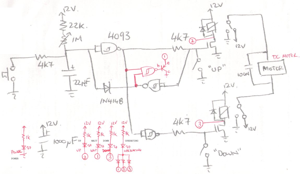

Dougy83, I really like your diagram and have some more ideas. LED lights for stages of program.
power on the board = red LED
amber LED = control side of relays has power
green LED = on when a circuit is active
a row of amber LEDs showing what stage board is in.
What additional components will I need besides LEDs?
You can add an LED across each relay to signal UP and DOWN states. The spare gate in the 4093 can connect to the output of the upper gate and the output of the middle gate to provide the WAITING indication (active low). The green LED will go on when any of these LEDs are on, which can be accomplished with three diodes forming a diode OR function of each state. The red LED connects across the power supply.
Each LED you add will need a series resistor, e.g. 1k for 10mA LED current. You'll need a buffer PNP transistor, such as a BC557, 2N3906, etc. to drive the WAITING LED and the three diodes, e.g. 1N4148, 1N4004, etc. for the green LED.
If you're using AC reversible motors, then you'll probably need to upgrade your relays to DPDT or add another SPST or SPDT.
Thank you again Dougy83. Would you be able to add these to the diagram? I do not have a clue where to put or what order to put the components you mention.
The motors I will be receiving, some are 12volts and others are 110volts.
Here's the schematic with the LEDs for the DC motor controller. Wiring for the AC motor depends on the type of AC motor you get.
what will happen if the PB is pressed in the middle of "down" travel? the response has to be inhibited.
If you press the button during the down travel, it will restart the cycle and revert to travelling up. If this is a problem, it can be inhibited by rewiring the switch ground connection instead through a diode to the output of the top inverter.
quite possible to work so, and there may be another issue with your schematic during power up, due to capacitor it may trigger a start.
Yes, good point. I guess the circuit needs a bit of reworking.

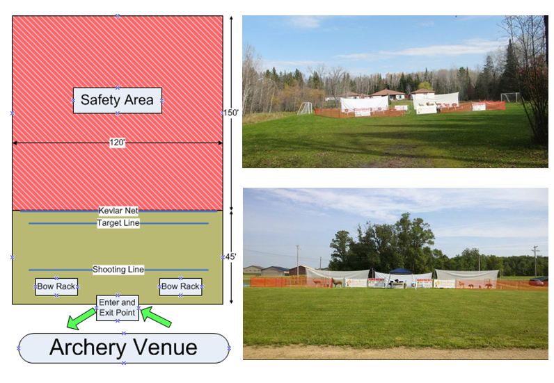

At Broken Arrow Ministries we use the life skill sport of archery and share the gospel of Christ to at risk youth and families at festivals, concerts and family events we promote. We are a non profit with little to no finances. (Facebook/Broken Arrow Ministries Inc). My wife and I support most of the events and archery classes I teach, these monies contribute to cover the costs.
**we are not asking for money, and do not ask for money. we are only asking for assistance with ideas to make the events stand out to attract the teens and young adults.**
We have an archery venue with 15 stations, 100' wide and 45' deep. persently these 3D targets are stationary. Sometimes we use a rope and pulley but this has proven to be very labor intensive. We would like to have them move, similar to a garage door opener to open and close. These targets would move up and down. The use of a garage door system is about 250$ per unit and keeping track of all the remotes will add frustration. So I thought of using a popup system and and using a PLC to control trigget times for each target. Using a PLC for each target is more costly then the garage door systems. (even used).
