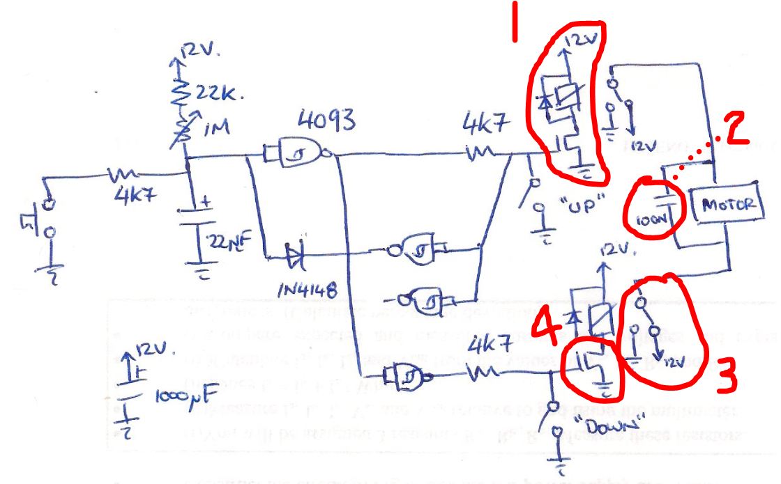

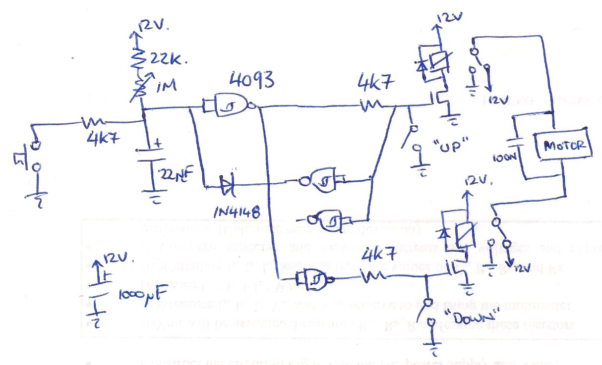

If you just want to use a generic geared motor with limit switches at top and bottom, the attached circuit should do the trick. The switch on the left can be remote. The 22k + 1M variable resistor can be replaced by a rotary switch and discrete resistors if you actually want discrete time steps, alternately DIP switches can be used in the same capacity. If you keep the variable resistor, you can have any delay from aprox. 0.4 - 22 seconds.

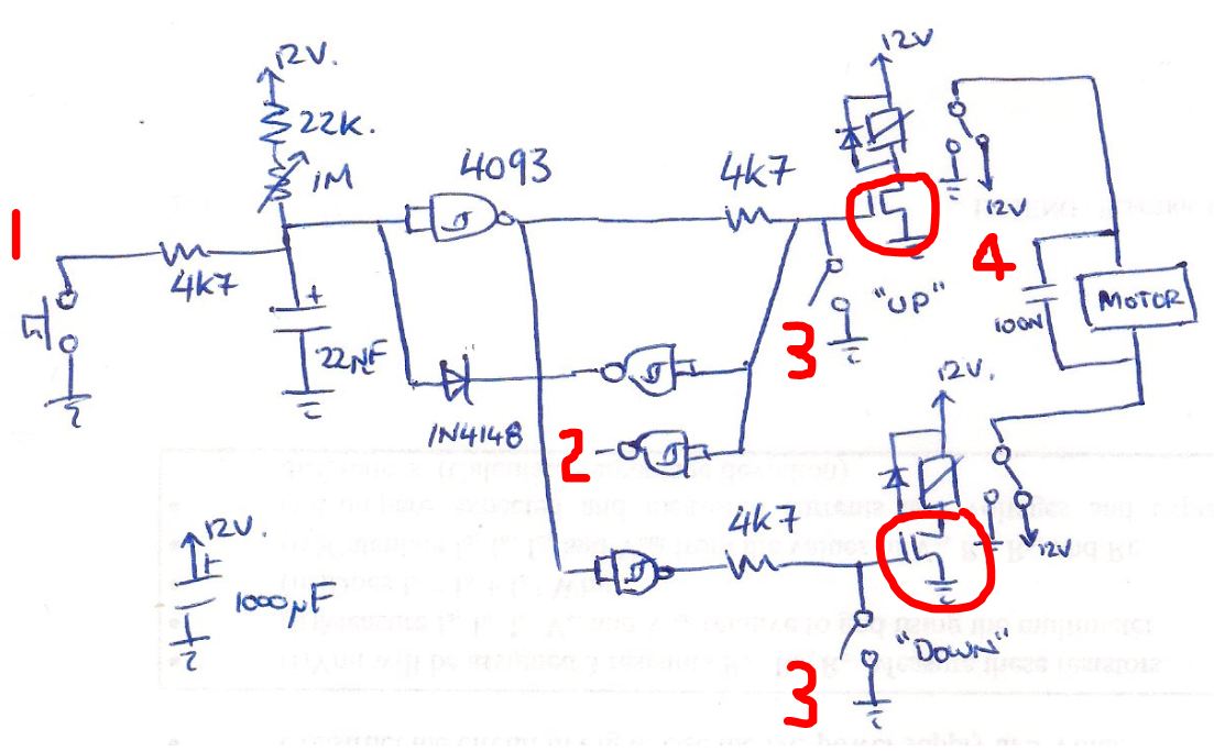

Can you clarify a few questions please??
1. Can this switch be a presss once for on?
2. Where does this pin connect to on the cirsuit?
3. Are these two the limit switches?
4. Is this a 100uF capacitor?
5. Not sure if this a switch before the relays!?
You commented about a DIP switch... where is the best location?
Thanks again for you reply.
Are you really going to use a garage door opener with its limit switches and single button open/close switch?
It might make the circuit easier. Add a switch on the far end where you want the timing to begin to trigger a 555 timer and have its output wired in parallel with the stock open/close switch to bring it back. You can use switches to select different resistors for your timing intervals.
1. Yes. Just a short press will start the cycle. If you hold it down, the target will be held up until you release the switch (and the programmed time has expired)
2. This pin is unused and not connected.
3. Yes, the one marked "UP" is the upper/top limit switch and that marked "DOWN" is the lower/bottom limit switch.
4. These devices are FETs (transistors). You can use 2n7002 or similar, or probably any other you have.
5. What do you mean?
The DIP switch and its eight resistors replace the 1m potentiometer and 22k resistor; i.e. between 12V and the positive of the 22uF capacitor. You might just want to use a pot. or just a resistor first.

Please describe 1, 2, 3, 4 in attached jpg. I apologize, trying to understand.
1. A relay coil in parallel with a diode and a FET
2. A 100nF capacitor in parallel with the motor (optional)
3. The contacts of the lower relay
4. A FET that drives the lower relay coil
