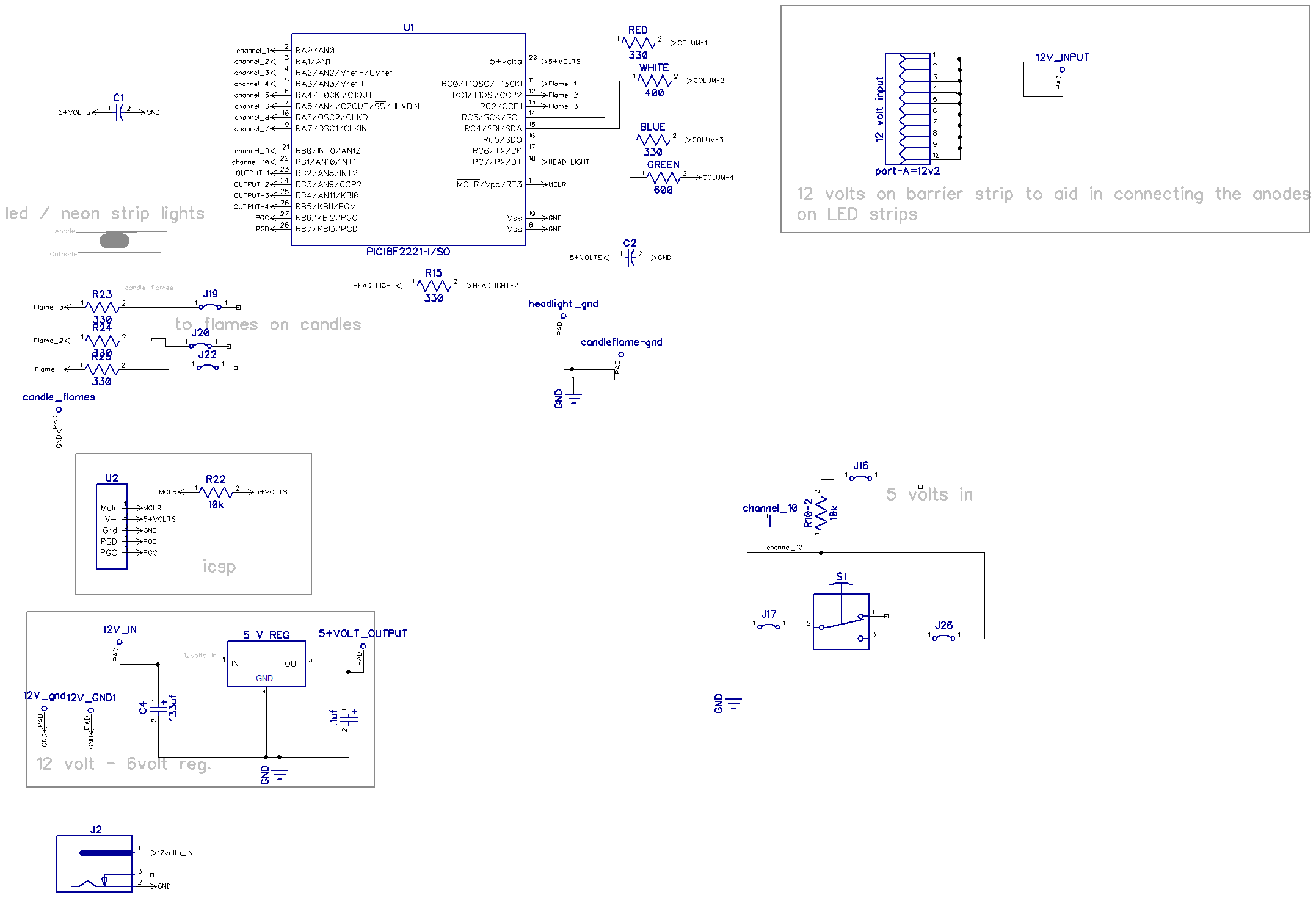

According to your last schematic, PORTB.1 is channel_10 output, which has a 10K pulldown.
Please show all the components currently attached to PORTB.1, including the toggle switch.

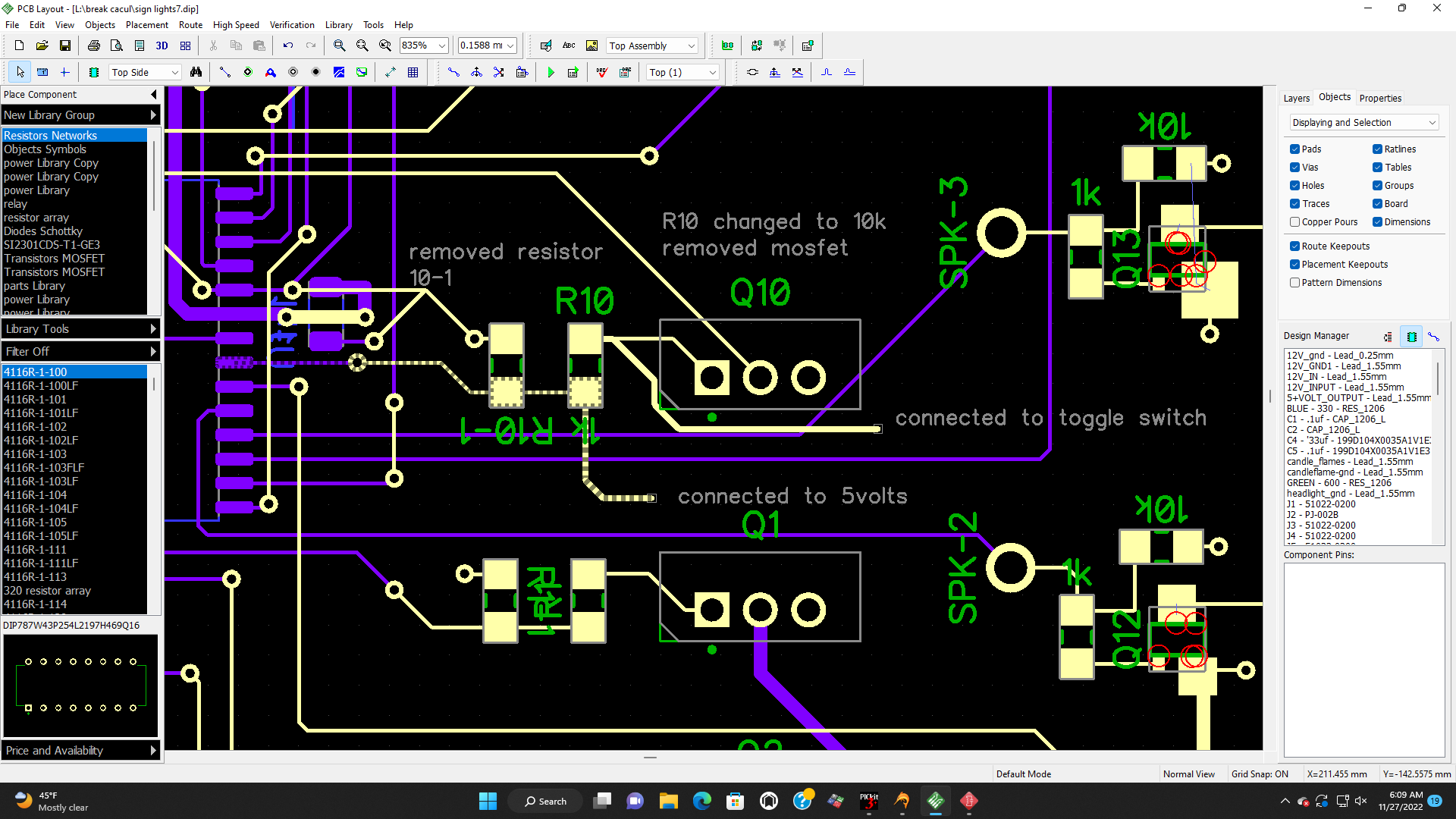

here is the schematic and screenshot of PCB revisions

42 is the answer ti the Ultimate Question of Life, the Universe, and Everything, but posting the same schematic that nobody can make sense of 42 times still doesn't make it clear.
Would it be possible for you to draw an accurate schematic in the conventional and customary way with lines showing connections of the "LED matrix" showing the micro, the LEDs and their series resistors and whatever and everything that is connected to B1?

Without an understable schematic showing the parts involved and testing to see if you can ACTUALLY control EACH and EVERY LED (show your code), this thread could go on 11 more pages and it still wouldn't work.

Your PCB shows 5V connected directly to pin 22...
The switch goes to pullup resistor R10. That's all. The other end of R10 (labelled +5V) goes through to pin 22.

Although I find MrDEBs schematics very difficult to follow, switch 1 seems to be correct. Pin is held high by R10 (assuming "5 volts in" is the 5V net) and pulled low by the switch. Or, (and it's very likely) did I miss something?
I don't think he's verified that the LEDs turn on/off by whatever means he's using, and the logic in the code is really not discernable. The switch isn't controlling a single LED on/off (which is a good test of switch function) but instead does something else entirely.
My mistake! one big mistake!
AFTER I posted #202, did the dishes, cleaned the kitchen before my wife woke up then started watching tv and rethinking WHY my circuit doesn't work correctly.
I looked at the screenshot of the PCB I realized I have the 5volts and the ground connections backward.
Will correct it in the morning and hopefully, all will work correctly.
yes, the board is generated from the schematic.
In post #202 I made a slight change as I discovered I made a design error for the candle flames and wanted the pic to control when and how the candle flames are enabled instead of just turning on the ground to enable the candle flames.
In post#202 I removed the Q10 MOSFET since it was not needed and when with the revised schematic in post#202 BUT
when I made the revisions on the board I made the 5volts and ground (to the switch) backward thus prtB.1 will never go LOW. Later this morning I plan to remedy the issue.
If you look at post#202 you will see I have the net highlighted. After I highlighted and thought about the issue for several hours it dawned on me that I had the pullup resistor and switch to ground wrong.
I wanted the pic to control the candle flames instead of just the switch.
board corrections are coming.
QUESTION? in post#184 how with all the lines going everywhere is it easier to read? It was suggested to use labels instead of a mass of lines. And yes Diptrace highlights the connections.
Make sure your connections have net names (not just text labels) and are shown on the schematic.
Be consistent if you add labels... for example, in post 202 you have "5+VOLTS", "5+VOLT_OUTPUT", and "5 volts in" all used for (presumably) the same net.
