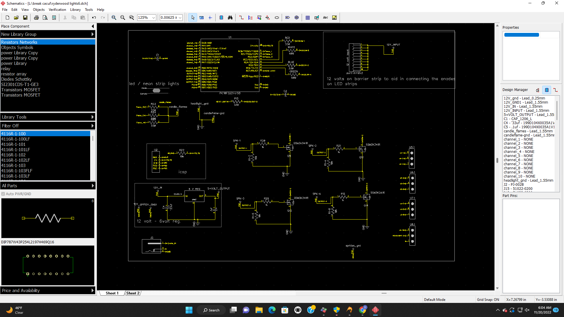

a schematic should help. Trying to toggle the rows while C-3 - C.5 (colums) are left HIGH
The rows are B.2-B.5 these have the P mosfets. Yes I checked for grounded Drain pins no grounds but 1.64 M ohms to ground.

Well I figured out what was wrong with row_4 and now it works but none of the rows are toggling.
I swapped out the 1K GATE resistor for 150ohm resistor.
Going to check the IRF 520 mOSFETS

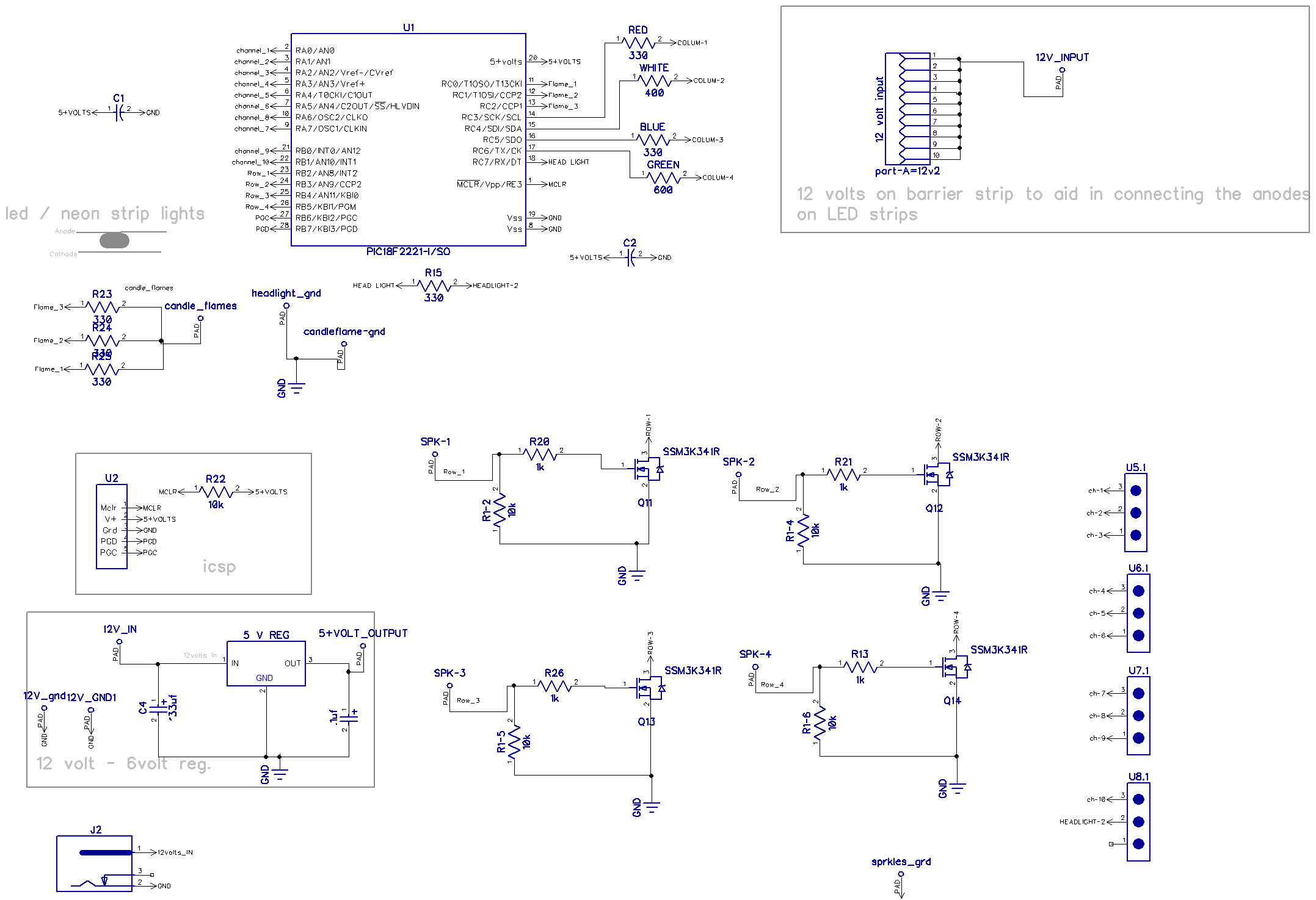

The SSM3K341R mosfets seem like they are shorted https://www.taydaelectronics.com/datasheets/files/A-5944.PDF
The DRAIN TO SOURCE still will not turn off measured the gate resistor as well as the Gate to ground 10k resistor.
All measure correctly. I measured the voltage at the gate/10k resistor junction (this comes from the pic) It measures 0 except about every 10 seconds it jumps to 4.95 volts brieftly then back to 0.
Contemplating removing the mosfet and wire in one of the IRF520s (bush fix just for testing) to see if it then will toggle the Row_1.
Maybe a wrong mosfet or?
I took some time away from the MOSFET issue (the SSM3K341R) and got other parts of this "ART" project completed but now back to the issue of the MOSFETS (ALL 4 OF THEM). I checked for shorts (none)
The MOSFETS are ON with or without any voltage on the GATE.
When I place an LED on any row that row voltage drops to .495 volts (no real surprise)
The voltage on any row without any LED is 0 volts
I checked the test points marked SPK_1 - 4 when the desired row is enabled and it has 4.95 volts
The test points are 0 when OFF
I changed the MOSFET but no difference
What am I missing here?

Please do the matrix properly,
Use an array to hold the 16 LEDs state.
Place 4 column values on the column pins.
Take ONE (the relevant one) of the row pins low.
Delay a suitable amount.
Take the row pin high.
Repeat for other three rows.
This way each LED has a 25% duty cycle rather than a 6.25% duty cycle.
I may have got rows and columns mixed up as I can't follow your schematics.
Edit, I assume Swordfish can easily do interrupts so this could be done automatically. Yes?

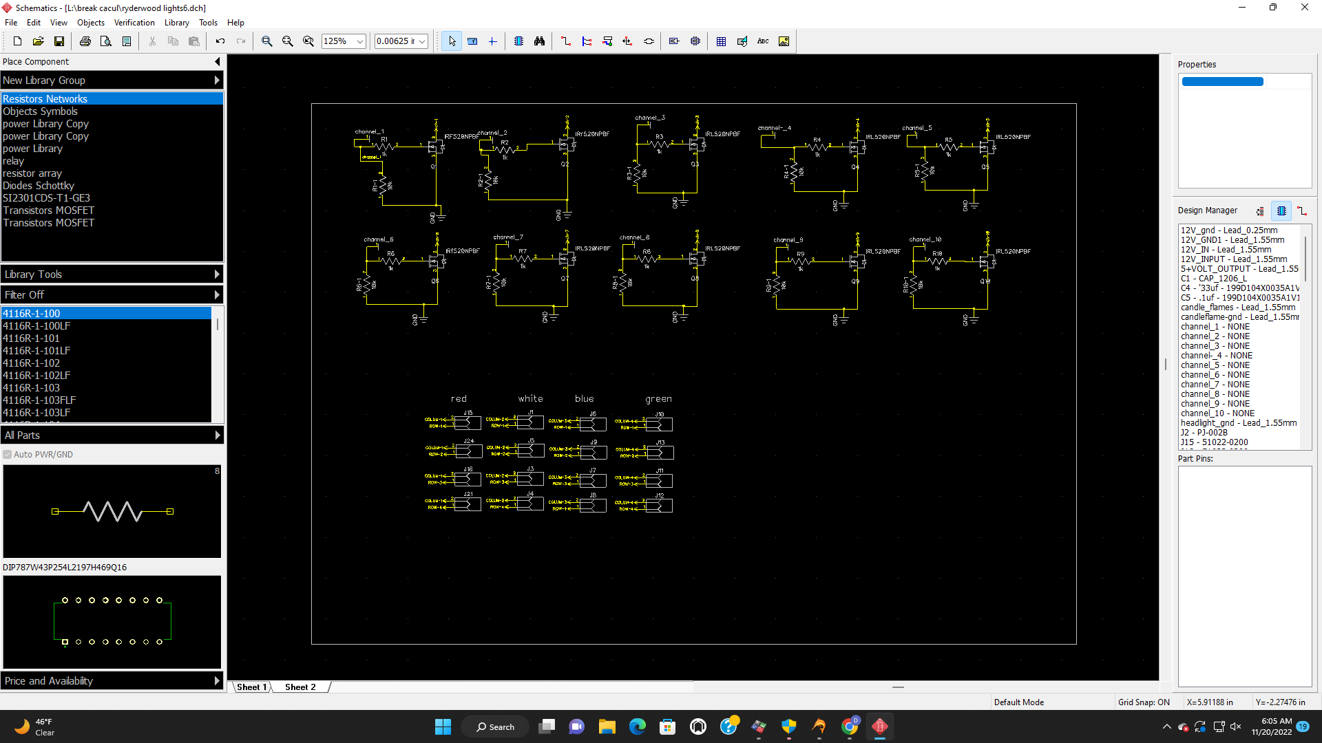

Do you have a schematic that shows ALL the parts?
The last one posted doesn't show the LED matrix or the IRF520's.
Yes it could be done Mike, but that ain't gonna happen here!
