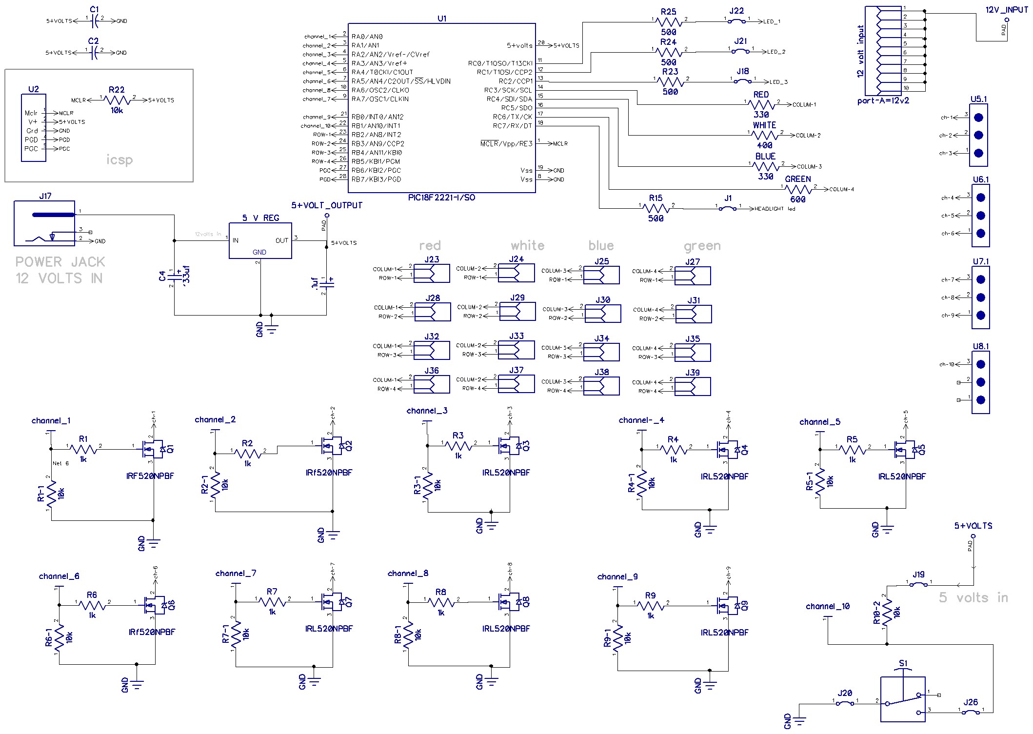

here is the revised schematic with corrected connections on the PCB.
If the Mosfets draw very little current then the 7805 should not get hot. Maybe when it got hot it destroyed the 18f2221?

Sorry, I can't tell a darned thing from your exploded parts diagram.
If you could please draw out the complete circuit of one LED, showing all connections, resistors, mosfet(s), power, ground and port pins, somebody might be able to understand what you're doing.
If you need more current at 5V than the 7805 can provide, there are small DC-DC converters that have the same pinout and can drop into the pcb to replace the 7805, like https://recom-power.com/en/products.../switching-regulators-sip/rec-s-R-78-0.5.html
There are a number of different mfgs and sizes. Available at digikey and mouser.
I think we've probably mentioned them in one of your threads, maybe even this one somewhere.
If the Mosfet gate resistors are 1K then the GATE is limited to 5ma at 5volts so more current may not be the issue.

And just to reiterate what tumbleweed said, the GATE current on a mosfet is effectively ZERO. Take the resistor out, and it will still be effectively ZERO.

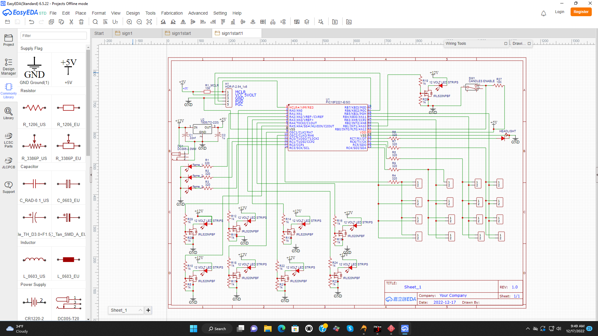

here is the same basic schematic done using EASYEDA. IMO it is a rats nest trying to follow the wires.
now how to post a schematic? tried exporting as easyeda file as well as pdf
All the FET gate to source resistors should be vastly higher value, eg. 100K.
With equal resistors you are halving the gate voltage and drawing unnecessary current from the PIC outputs.
The way you changed the resistors around the IRL520 you now have a voltage divider that pulls about 2.5mA. You used to have a larger pull down, which would be fine. You're lucky... at 5V it's still high enough to meet the min Vgs threshold (2.5 vs 2.0v).
Stop just randomly changing things.

Thank you for creating a readable schematic. The point wasn't to use EasyEDA – the point was to draw a readable schematic. You could have done it on a piece of paper with a pencil.

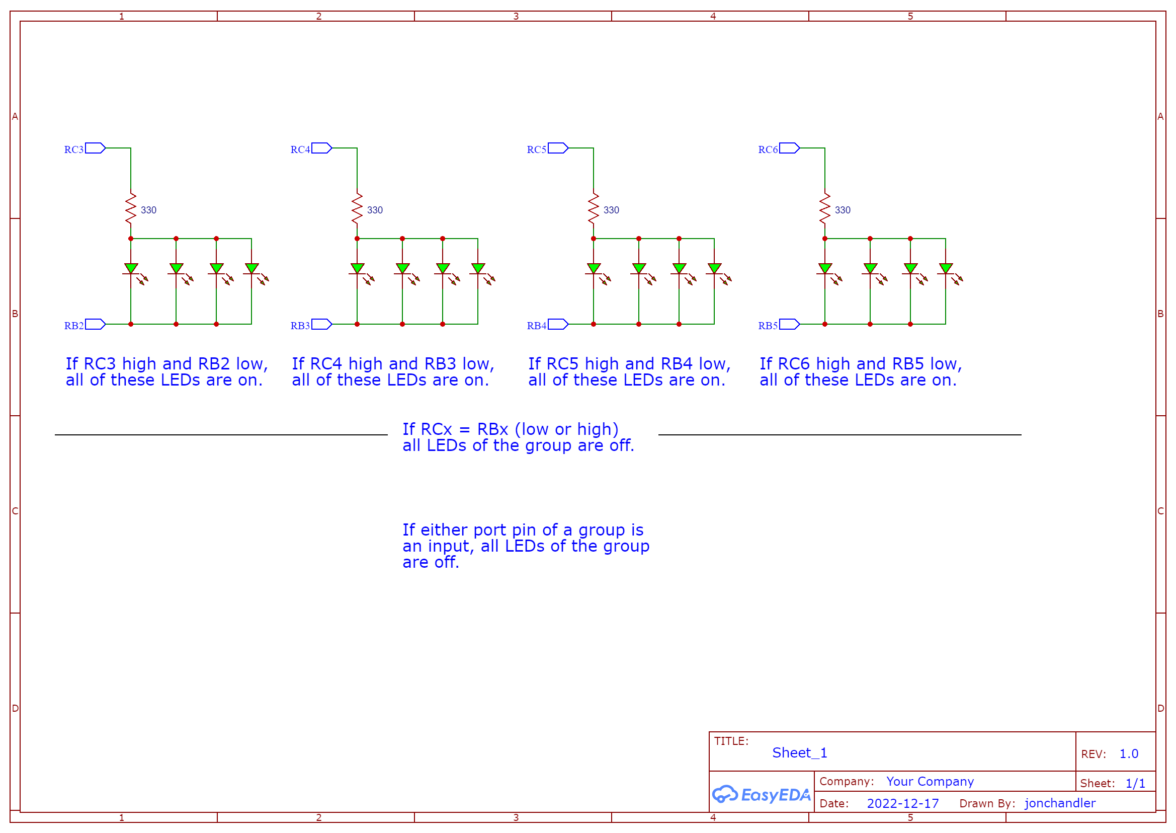

I must say, if your schematic is accurate, your groups of 4 LEDs aren't doing what you thought they would.
The attached schematic shows what you have: 4 parallel LEDs with one resistor connected between two port pins. If one of the port pins is high and the other low (can't say which is which because you don't show the LED polarity), all 4 LEDs will be on. If both port pins are high or both are low, all 4 LEDs will be off. Also, if either port pin is an input, all four LEDs will be off. All 4 LEDs of a group are on or off. You can't control the LEDs of a group independently.
You could have accomplished the same thing with a single port pin per group.
