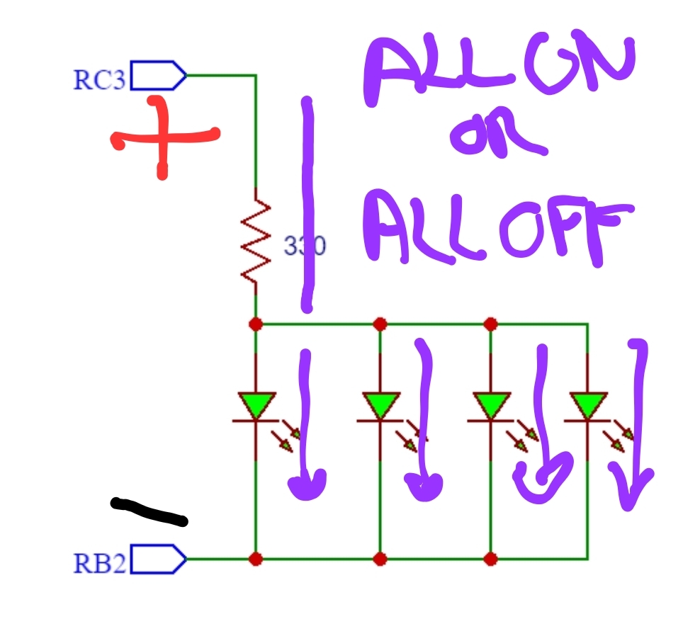

That is exactly opposite of what I have explained twice already. YOUR ROWS ARE EITHER ALL ON or ALL OFF if your schematic is correct.
Since you're not going to even attempt to understand replies to your numerous problems, I'll stop wasting my time.
The rows are individually controlled by portb.2 - b.5 so ALL THE ROWS are not all on or off.
Unless you or I are missing something, but I have an actual board where the rows are independent of each other.
There are four separate COLUMNS - but there is no X-Y matrix, no rows.
All four LEDs are connected in parallel in each column, with both a colour and a "row" connection linked vertically to each column, rather than the row connections being across the columns to give the matrix connection.
That's how they are in the EasyEDA screen grab, anyway.
THIS is what YOUR schematic shows. The ONLY OPTIONS are ALL ON or ALL OFF. So either your SCHEMATIC is WRONG (imagine that) or your UNDERSTANDING OF THE CIRCUIT is wrong.
LOOK AT YOUR SCHEMATIC, you know, the "corrected" one after I explained and drew you a picture of what it showed. Trace the circuit. Explain how it can possibly do as you claim (HINT: IT CANNOT).
You haven't taken the 30 seconds to understand what I posted over 10 posts ago.

I'm afraid MrDEB has missed the point. IF his schematic is accurate, then what he wants to do is impossible. If it is possible to turn on a single LED in a row, the schematic is incorrect.
In either event, nobody can keep with the code as it's either:
● Not possible to do want he wants
Or
● Nobody knows what's actually connected to what, so any comments on the code are useless.

You need to turn the rows off after each step to have a single LED illuminated.
As it is now, you'll have:
Step 1: 1 red LED illuminated
Step 2: 2 white LEDs illuminated
Step 3: 3 blue LEDs illuminated
Step 4: 4 green LEDs illuminated
Your 4x4 matrix can be turned on from a 16 bit variable and 4 LEDs can be illuminated at any one time via interrupt (very fast so it looks like all lit LEDs are on permanently). That way your main code can simply set the bit in the 16 bit variable. Plus your on time is 25% instead of 6%. You do realise that with 5V and 330Ω resistors and an on time of 6% the LED current will be ~0.5mA - not very bright. Dropping the resistor to 33Ω will increase it to 5mA .
