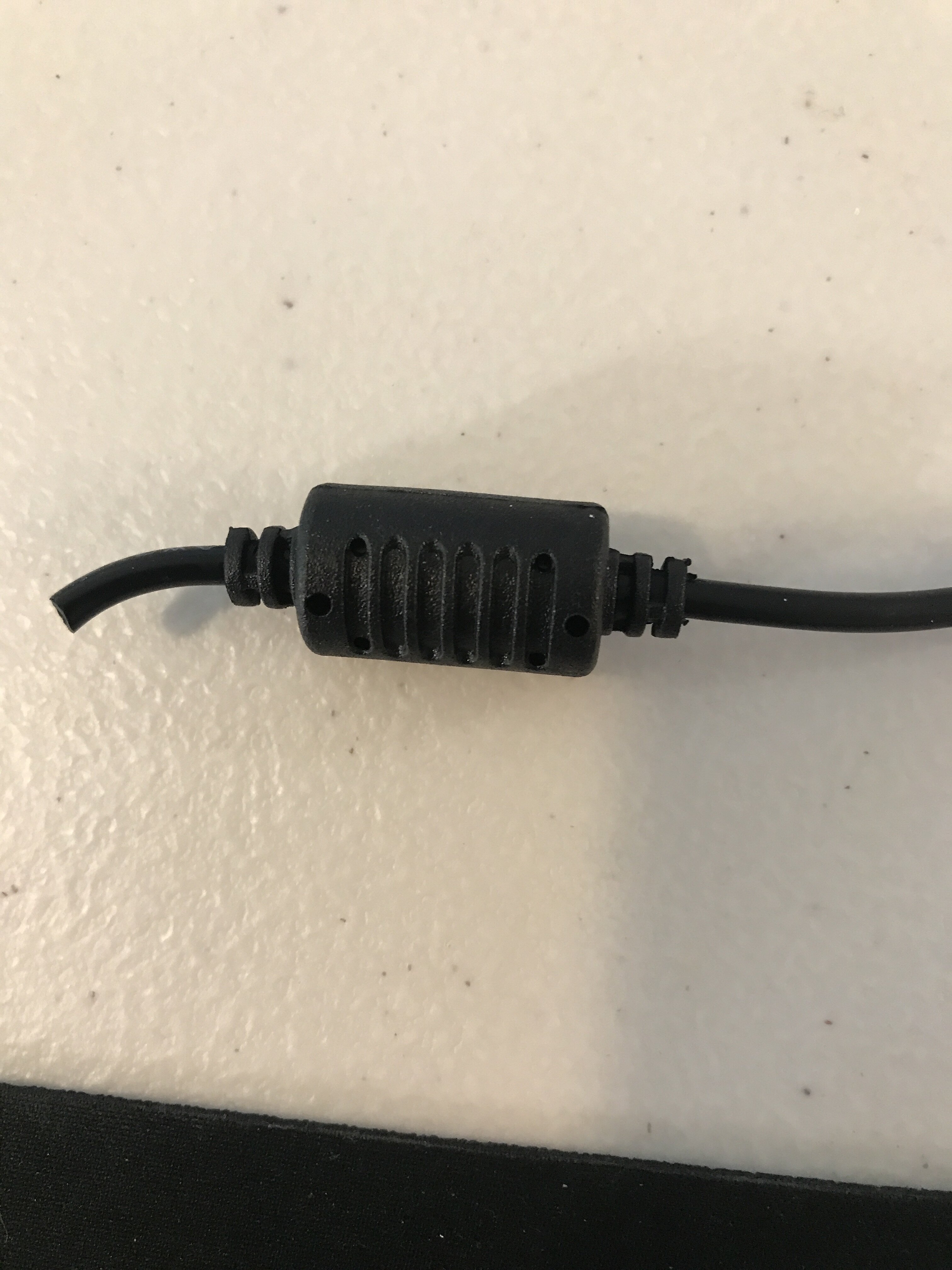

The "thing" in the power cord is probably a filter to prevent the high frequency switch Mode Power Supply from causing interference to nearby radios.

The lump on the old cable is a ferrite sleeve, with a moulded strain relief over it. It's to reduce any possible radio interference, to help with compliance with EMC regulations.
Something like this type of thing:
