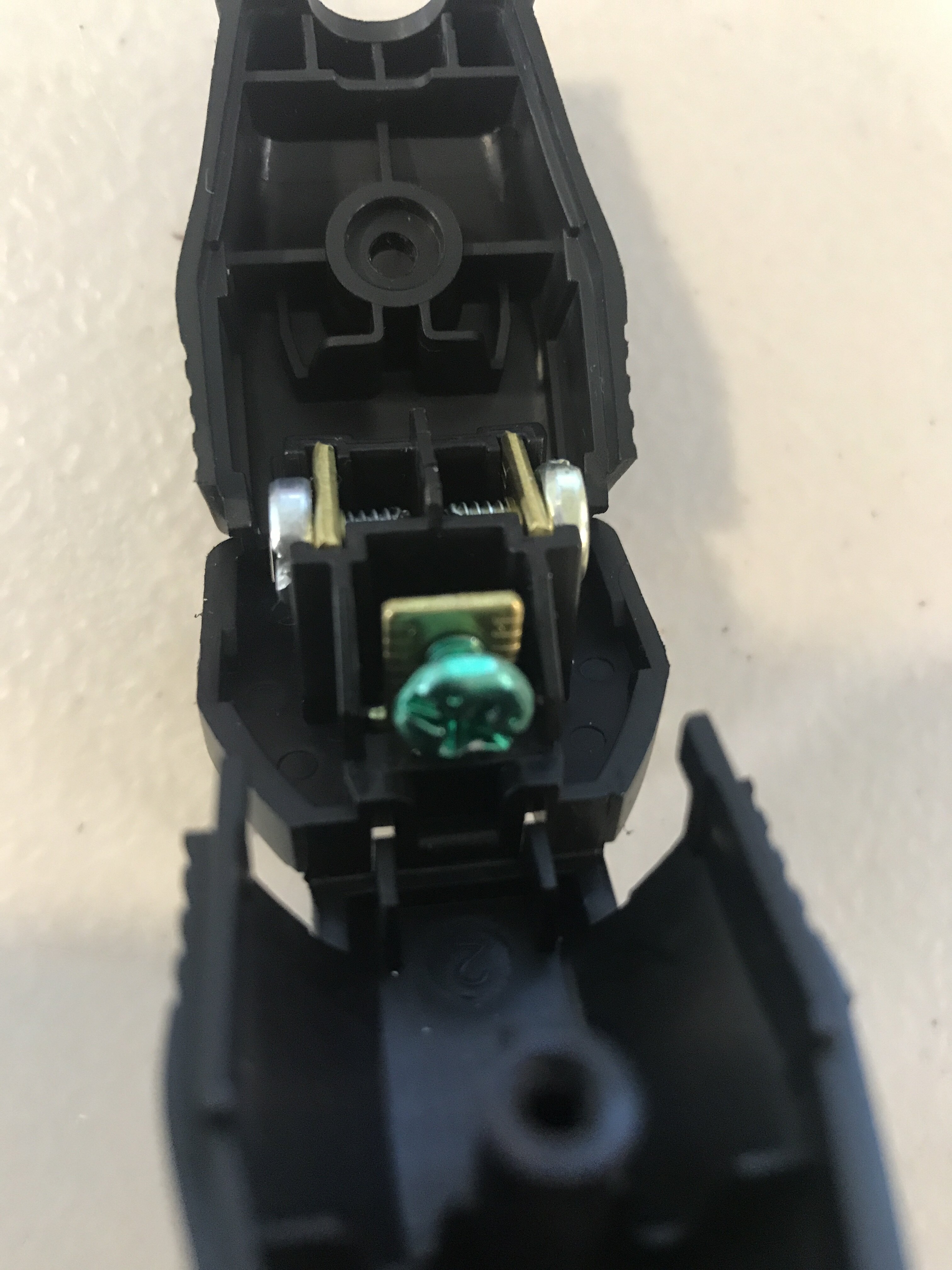

This is what I purchased:
I'm assuming this is a power adapter with a trailing AC lead. If so, I'm assuming I can save an outlet by slightly modifying the current setup. I can buy another one, (this time keep the RF choke in place :) )change the plug to the one I purchased, send positive and negative to the appropriate screws, then split the other end of negative, sending one wire to the amplifier inputs, and the other to the ground pin of the plug.
Wow, I'm having fun with this.
Please confirm that this alternate plan would work, as I believe it is what you are describing, however, there is no amp ground plug.

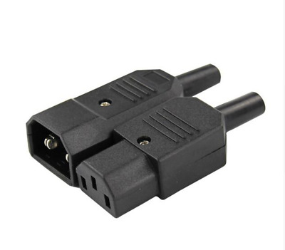

OK, you could either change the plug on the AC cable and add the ground wire to that, or get a pair of C13/C14 connectors and make a very short link cable to go at the PSU block end, with the ground wire added in to that - slightly more expensive but neater, as no extra wire at the wall plug end.
eg.
Having cut the ferrite sleeve off the DC power cable should not matter, just join the ground anywhere on the DC negative side.

My writing is a bit convoluted sometimes. This should explain my plan better:
Take my current setup:
Remove the existing wall wort PSU completely and remove the set of positive and negative wires that were going from the PSU into the master end of the terminal block. Take my Leviton out of the outlet, and remove the negative wire from the grounding screw. Cut off the plug end of this (https://www.amazon.com/dp/B09CKTJ96N?ref=ppx_yo2ov_dt_b_product_details&th=1) and replace it with the Leviton by wiring the positive and negative wires from the lead wires that came with the above linked PSU to the positive and negative screws in the Leviton. On the other end of the leads, connect the positive wire to the terminal blocks in the same fashion that I use now, which gets sent to the power positive inputs of both amp boards. Do the same with the negative lead, but use a second terminal block to make a second split, and from the output of that negative, connect another wire and connect it to the ground screw of the Leviton. Then, plug the Leviton into an outlet. I already have a second terminal block which I use for the current negative split. Please see the attached which shows the setup without one set of wires connected. Currently, I use a second wire to go from positive to positive between terminal blocks, before getting the other two positive wires to the power positive inputs of the amp boards.
I thought this would work, as I'm just replacing a PSU end negative wire going into a separate plug's ground screw, with a different PSU's negative end going into its plug's ground screw; the only difference is that in this plug I'll already have positive and negative wired to the appropriate screws.
So, assuming I explained my plan clearly enough, is the workable and safe?
See the terminal block on the right. I'd connect power positive to the red slot on the right, and then on one of the left red slots, connect a short wire to one red slot on the other terminal block. This gets to the power positive inputs of both amps. On the terminal block on the right, I'd connect power negative to the blue slot, then on one of the left blue slots, connect another short wire to the blue slot of the other terminal block. This gets to the power negative inputs of both amps. On the second blue slot on the left side of the terminal block on the right, I'd connect another wire, and then connect the other end to the ground screw of the Leviton, which would already have the positive wire of its own lead connected to the positive screw, and the negative wire of its own lead to the negative screw.
I think I described my plan clearly enough now to get a definitive answer. Will this work and be safe? I have no problem keeping my existing setup; I just find it a little odd to have a second, dedicated plug just for ground, and if my proposed solution works, I'd prefer to use it.

I'll rephrase:
Cut off the plug end of this (https://www.amazon.com/dp/B09CKTJ96N?ref=ppx_yo2ov_dt_b_product_details&th=1) and replace it with the Leviton by wiring the positive lead into the Brass screw (hot/live) of the Levitron, and then wiring the negative lead into the silver screw (neutral) of the Levitron, and then wiring the second negative lead info the green screw (ground) of the Levitron.
My Levitron, as shown, doesn't have different colored screws for hot/live and neutral, but with the ground pin facing downward, the screw on the right is associated with the pin that would plug into the narrow slot in the wall, so that one must be hot/live.
Is this correct?

I'm more awake now then when I composed my last reply, so I'll try and get all the terminology correct. The cable to my power supply only had two wires. I don't remember the color convention, but it was easy to verify with my multimeter which was live, and which was neutral. When I plugged the power supply in, and I touched the red multimeter lead to the live wire and the back multimeter to the neutral wire it measured 12.25V. Reversing the connections resulted in a measurement of -12.25V. So, this is what I'd like to do:
Connect the live wire to the hot/live screw of my Levitron. Connect the neutral wire to a conductor terminal block. Connect two wires to the opposite same-colored side of the terminal block. Connect the other side of one of those wires to the neutral screw of my Levitron. Connect the other side of the other wire to the ground screw of my Levitron.
Is this workable and safe?

I wired it up with the last known working no hum configuration, which has power negative split between power negative inputs of both amp boards and the ground screw of the Levitron plug, with nothing else connected to any of the other screws in the Levitron plug. I'll have to live with the oddness of having two plugs for the setup.
I do remain confused regarding my proposed alternative setup but have given up trying to fully understand it for now.
I very much appreciate all of the diligence and concern for safety, as well as all of the informative replies.
