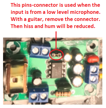

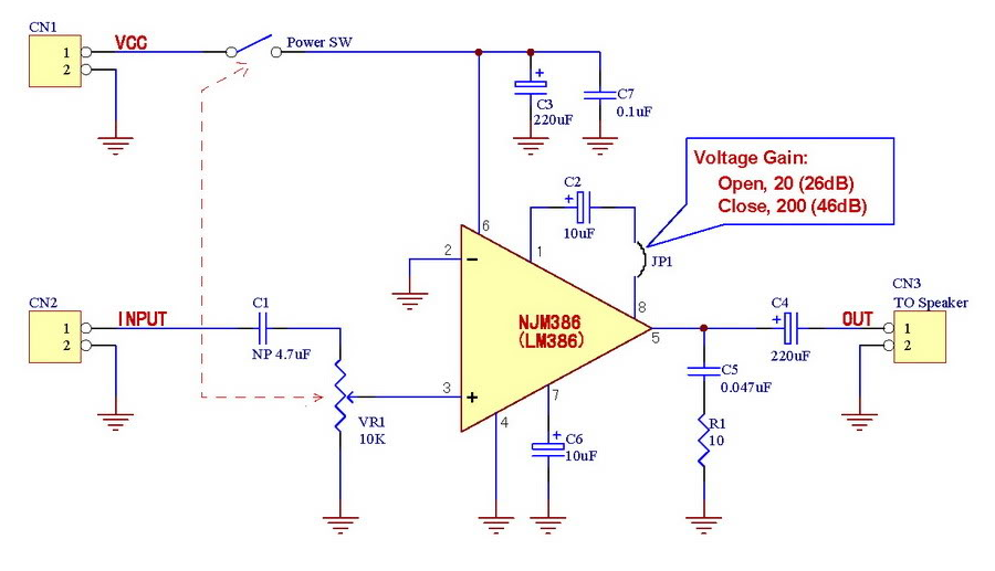

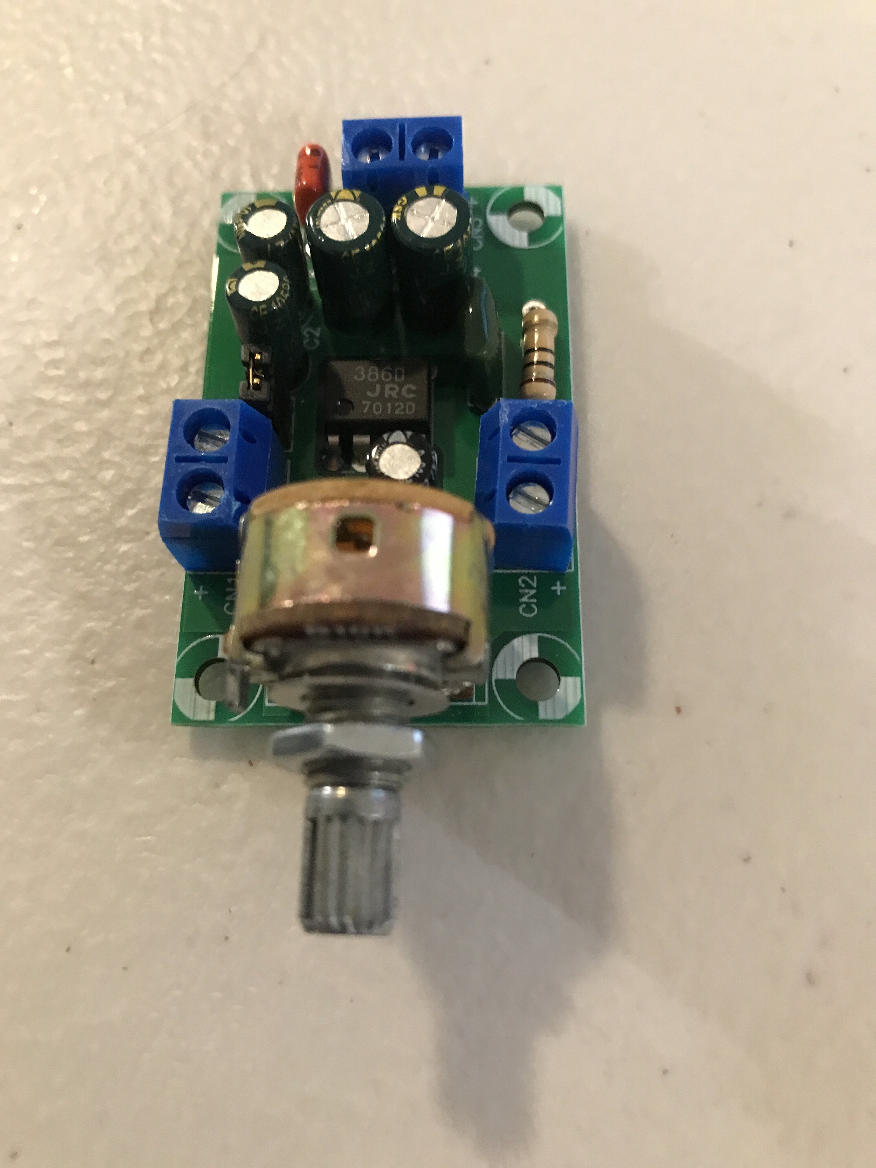

Your photo has a pins connector on the amplifier that is used when the input is from a low level microphone.
With a guitar, the connector should be removed because it increases the gain then hiss and hum are increased.
With a guitar, the connector should be removed because it increases the gain then hiss and hum are increased."
I have some familiarity with the board, and if I remove the jumper, this decreases the voltage gain from 46 dB to 26dB. I just removed both jumpers and I much prefer the sound with the extra gain. With the jumpers disconnected and the system powered on without the Bluetooth unit powered on, the hum is still present. It may be a tiny drop less, but irrelevant to me.

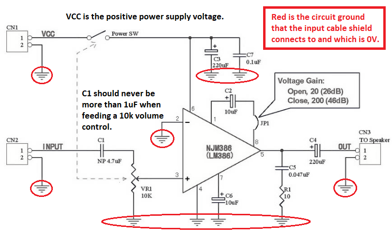

Connect the metal case of the volume control to your circuit's 0V.
I'm still a relative "newbie" at all of this and don't know where my circuit's 0V is. I've attached the amplifier board schematic, as well as a photo of my circuit, and a separate photo of one of the amp boards. The only parts of the circuit that aren't pictured are the power supply, and Bluetooth receiver + 3.5 mm audio cable that sit outside the project box.
Please let me know where my circuits 0V is. Also, where specifically on the potentiometer would I make one end of the connection? I do have some basic soldering skills but would prefer not to have to solder anything. Could I just wrap some wire behind the washer and secure it by tightening the washer?
The hum doesn't go away when I touch a volume control knob, it gets worse. Does this indicate something else is the main problem?
OK, that likely just means the metalwork is not connected to 0V, so it's coupling to the input.
A proper mains ground is still the answer.
For info, the power and input negative terminal is the PCB "ground"; they have an "Earth" symbol on the schematic. (It should really be "chassis" symbol, but a lot of people don't seem to know the difference).
That negative / PCB ground is what signals within it are referred to. You can add a wire from power negative to behind the pot washer on each amp.
Usually an amplifier is in a metal box as a shield which is connected to the circuit 0V. Then the metal case of the volume control is bolted to the box and 0V.
You probably cannot solder to the metal case of the volume control but try soldering a 0V wire to one of its washers.

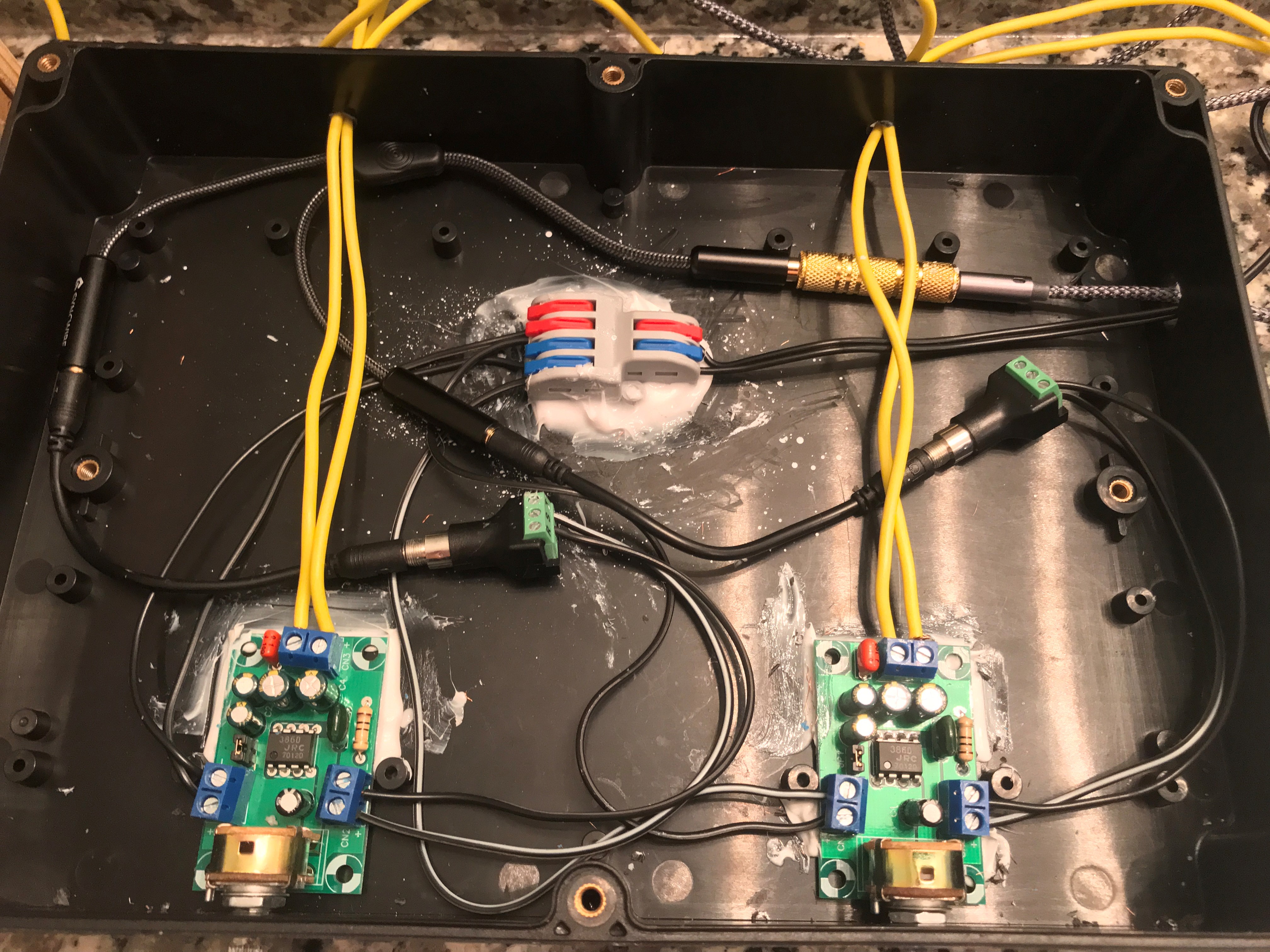

Your ebay "cigar box amplifier" is missing important shielded (screened) audio input cables.
Then the ordinary audio input wire is an antenna that picks up interference hum from electrical wires all around you.
I replaced the sets of 22 AWG input wire with shielded audio cable, yet the hum persisted. I ended up putting the original wiring back in place, because the shielded audio cable is too thick to comfortably fit in both sets of screw in connectors.
I also tried grounding the potentiometer base, but nothing I did eliminated the buzz. One of the attempts was a connection from 0V to the potentiometer washer nut. I also wrapped wire behind
the nut and tightened the nut around it.

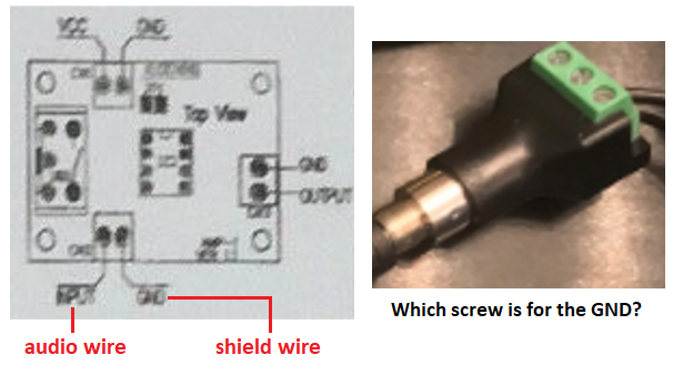

Are the audio and shield connections wrongly reversed?
I think that the Bluetooth receiver is a high impedance when turned off or is not paired then the audio wire from it to the amplifier is an antenna that picks up electricity hum and other interference. Then when the Bluetooth receiver is turned on its output becomes a very low impedance that shorts the hum.
I know these amp boards and the other components well, and my wiring is correct. The middle screw of the 3.5mm Stereo Female terminal block panel is ground. I haven't tried, but not sure if I would get sound from the speaker if I reversed ground and one of the channels. Please see my attachment.

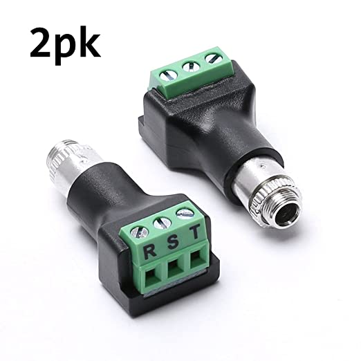

TRS (RST) connectors are frequently used with low impedance headphones that do not have shielded cables.
