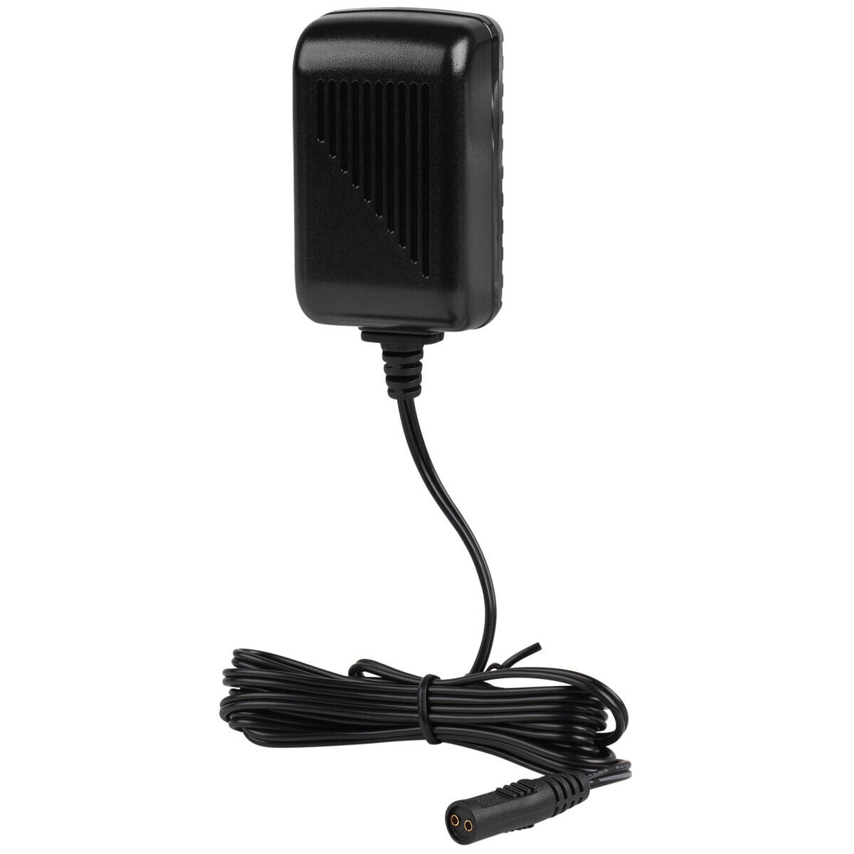

I'm using this power adapter:
USA - normal 3 prong grounded power plug. It's in the same power strip as the rest of my appliances in that room are connected to. I may try some of your suggestions.
OK, that is an ungrounded power unit.
Try an earth from the amp [audio] input common "ground" to a true electrical ground, it may well cure the problem.
