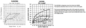

The datasheet of the NJM386 Japanese copy of the American LM386 does not show it with a 12V supply.
The American datasheet shows it heating with 0.8W with a 12V supply when the ambient is air conditioned which will overheat the "DIP8" IC that is rated with 0.7W maximum allowed heating.
It produces almost the same 0,5W of maximum undistorted output with a 9V supply as the 0.6W output with a 12V supply. Use a 9V supply instead.
