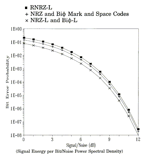

I have been going through some graphs, and I have a question about the graphs that shows the Error vs Eb/No.
Now Eb is Energy per bit.
Error is number of errors.
What is No? is it the Gaussian white noise of zero mean?
Why the Eb/No axis is measured in dB? what is the reference here?
for example the error probability graph for the NRZ digital data looks like a low pass filter graph. But somehow I just cannot understand it very well. Does that mean if my bit has more energy there is less probability to have an error? why? (a pic is shown).
so No is constant?
Does this graph give me any information about the bit rate? like if I have a faster bit rate ill have more error?

That graph appears to show that the louder you shout the fewer errors you will have.
Actually, the x axis is SNR (signal to noise ratio), not signal. This should be intuitive. The stronger your signal is with respect to the noise, the lower the error rate.
Think about having a conversation on a busy street vs in a quiet room. Clearly the quiet room makes the words easier to understand and you get fewer errors. On the noisy street, you have to raise your voice to be heard properly. You have thus increased your SNR and decreased the error rate.

I'd say no, which implies that the bit error prob. is independent of the bit rate and only dependent on the S/N ratio.

Ok this explanation makes it sound easy. But..
How do I calculate No? I mean, if I am generating my digital signal, and I want to calculate the energy Eb, I just integrate my bit over the interval. But how would I know my No so then I would know on which point im standing on the x-axis?
Also why dB? what is the reference here?
You to need to compute your system noise figure.

To answer your question why dB? and what the reference is... dB is commonly used to represent a difference between two power levels. It is a logarithmic unit of measurement that allows exponential changes to be represented as linear. dB by itself is dimensionless. +/- 3dB indicates that the power level has increased or decreased by 1 power. For instance if voltage A was 10V and was increased by 3 dB it would be 100V. A 6 dB increase would give you 1000V. There is no reference point with regards to dB by itself. However other measurements exist. For example dBmV is commonly used to measure RF. O dBmV = 1mV. Different numbers that serve as references for different measurements derived from the dB are chosen with different factors in mind but are all arbitrary to a certain extent. Here's a formula for dB ---- dB = 10Log(v1/v0) Where v0 is your start power and v1 is your end power. It's 10Log because a decibel is 1/10 of a Bel. Some measurements use 20Log, but I don't recall why.

I still need a clue how to calculate my No if I know my Eb so I can know on which point on the x-axis I am standing..

I am just simulating right now i have no tools. I could simulate gaussian white noise (which is some random data with mean zero) and add it to my digital data using C programming language. Now I moved into simulating into verilog so I can apply the whole thing into FPGA.
So, using C, I can know Eb by integrating my digital signal squared over one period. How can I know my No of my bit? coz im adding the noise in a complete random manner.
So I need a way to know No so I can simply divide Eb/No and know which point I am in on the x-axis. Unless u have a better way ofcourse..

My digital levels are 5, -5. I added simple White Gaussian Noise before I generate my digital signal so im actually receiving values like 4.9, 4.8, 4.7, 5.1,5.2 ... etc when HIGH (3.5 ~ 6) and -4.9,-4.8, -5.2 .. etc when LOW. (-3.5 ~ -6).
Now u know that, my transmission medium is the wireless RF.
Now if I receive a HIGH bit, I know its supposed to be around 5v. So I can simply integrate 5*5 (squared) over the bit period (around 100ns if im receiving 10Mbps). This way I can know my Eb. I still need my No..

Ok, my experience designing digital circuits is very limited (at best) but I think this may help you. Like I was saying in my last post, noise begins at any temp above absolute zero (and maybe at absolute zero too I'm not a physicist, but generally..). I found a formula that I think will be of great help. It's from wikipedia:
https://en.wikipedia.org/wiki/Noise_spectral_density
It said right on that link that that No = kT. where k is Boltzmann's Constant in joules per Kelvin and K is the systems noise temp in Kelvins. I'm afraid I may not be of any help as far as explaining how to use this, but it feels warm, if you know what I mean so check it out.
However you did give me some numbers above basically saying that the noise was +/- .1V for high and low. And the both high and low are ideally around 5V or -5V. You're basically saying that 5V is your signal and your noise is .1.
However the chart says the s/r is the energy of the bit divided by the spectral density of the noise. Unfortunately I've never dealt directly with such a problem, but now I'm interested so I'll keep you posted. I've been sitting here with my scientific calculator giving it a wing but I haven't come up with anything.
I think the key is going to involve you getting some temperature info about the circuit as I beleive the noise in question here is thermal noise. Check out that link and some of the others that link to it and let me know if that was useful at all...
