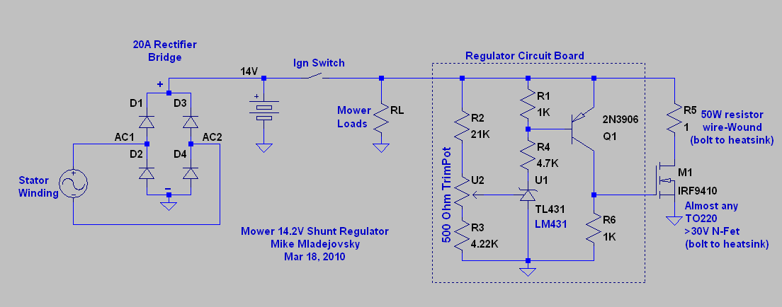

I have Burnt out my Ride on lawn mower Regulator and I would like to make one to replace the burnt out one.
The motor has a built in Alternator that supplies 40 V AC 10 Amp Max But the Regulator I have drawn up using a LM317K reg can only supply 1.5 amps
I would like to deliver more current to the battery When it is required.
I know that there can be transistors placed in the circuit to increase the current but I do not know where to place them in the circuit. What transistor would I use
Or is there another way.
I will try to add a attachment.
Can you help
There is only 2 wires coming out of the alternator.

I'm thinking that your alternator has a permanent magnet field, and can only be regulated using a "shunt regulator". Here is a previous thread that dealt with this.

What's the battery voltage?
The trouble is the LM317 is only rated for a maximum Vin-Vout of 40V but it might be all right if there's no chance of it being short circuited.
You can add a current booster to the LM317, which should enable it to provide 10A but you'll need a large heat sink.
What's the voltage from the alternator when fully loaded?
It's possible that the voltage will drop a lot so it won't need to dissipate the full voltage at the maximum current.

I have red a previous post . Could you tell me what components to use for my project and a circuit drawing,

Is the rectifier intact, or was that inside the regulator you removed?
I would use the circuit that I posted. It will give much tighter regulation than the Zener.
regulator is burnt out and sealed including rectifier but it is a external unit.
Is that the circuit in the other post.#13
In that post you have written 1hom 50W resistor. have you inserted that resistor into the Circuit diagram what is Rint in post #15.

I updated the schematic specific to your mower (14.2V). You will need to procure a 25A 200V Full-wave Rectifier Bridge to convert the AC output from the alternator stator winding to DC. This is wired between the stator winding and the battery. All of the mower loads, including the lights and ignition, etc, must be connected downstream of the ignition switch. The regulator is built in two pieces, a hand-wired circuit board, the power resistor, and the NFET, which must be bolted to (but electrically insulated from) a large piece of metal.

Is there another shunt regulator to use in Place of TL431 as I am having problems obtaining one here in AU
or building the regulator with other parts.
Is it possible to make the bridge rectifier from diodes as I have plenty of different diodes.
The place where I obtain parts has a reasonable range but If I require any from other companies I have to have a business and open up account.
Can you help me with the above
The TL431 (Texas Instruments) or LM431 (National Semi) are widely available and multiply second sourced. I cant believe you cant get them in OZ. I just bought 10 of these the other day at $0.18 ea.
The diodes in the bridge should be rated >20A and >100V.

In the circuit there is P channel Mosfet IRF9410 Could I use a IRF 9530 220AB body
