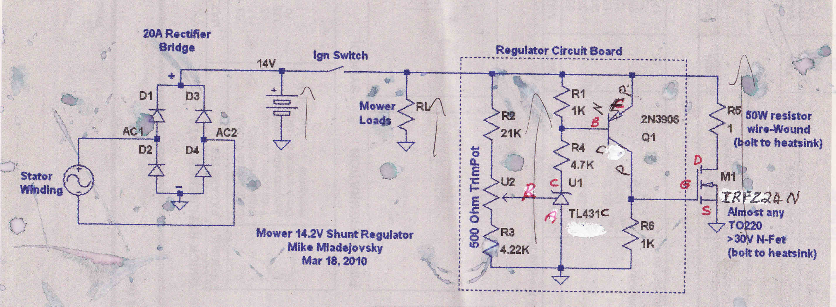

The circuit requires an N channel MOSFET. (Not a P channel).
Any of the ones **broken link removed** would work.
I missed that, forget what I said earlier.:o

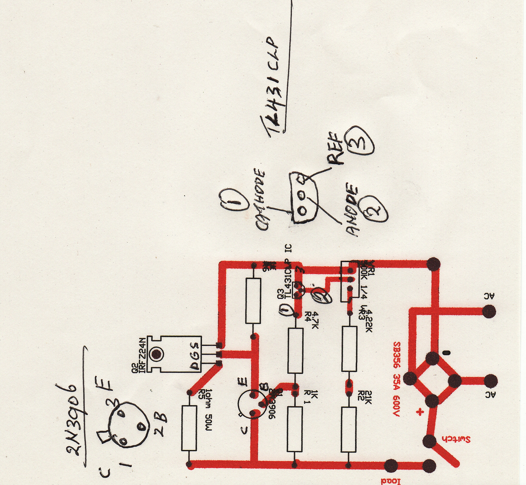

Could you check out the placement of the Components on the board layout and change the layout if they are not in there correct place or Pin out
Greg
Greg
The trim pot must be between R2 and R3, with one end of R3 grounded (see my schematic).
I cant tell if I am looking at the bottom of the transistors through the layout? If so, it looks like you have two of the pins on the TL431 swapped. One of the outside pins should go to the pot wiper. The middle pin should go to ground.
On the 2n3906, if you are really using the TO-18 metal can, the pin closest to the tab is the emitter. Check the pin out. **broken link removed**
On the FET, I cant tell if I'm looking at the top or the bottom; it matters.
The 1Ohm 50W resistor should not be mounted on the board; it should be the kind that mounts on metal for heatsinking, like this.
Thank you for picking up that I had made a mistake in my board Circuit .
It was late when I finished the Board layout.

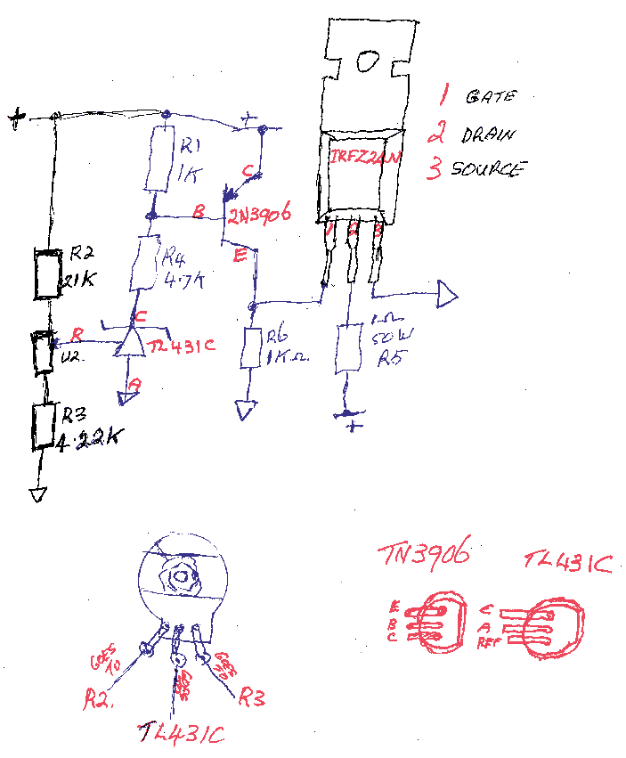

I am not shore what pins go where, could you check the attachment and let me know if they are correct or inform me where they should go with a diagram. The 2N3906 is a TO-92
I am still learning .
Thank you for your help.
sorry I am a pest.

It looks fine to me.
Just beware that you need a huge heatsink for the MOSFET and power resistor.

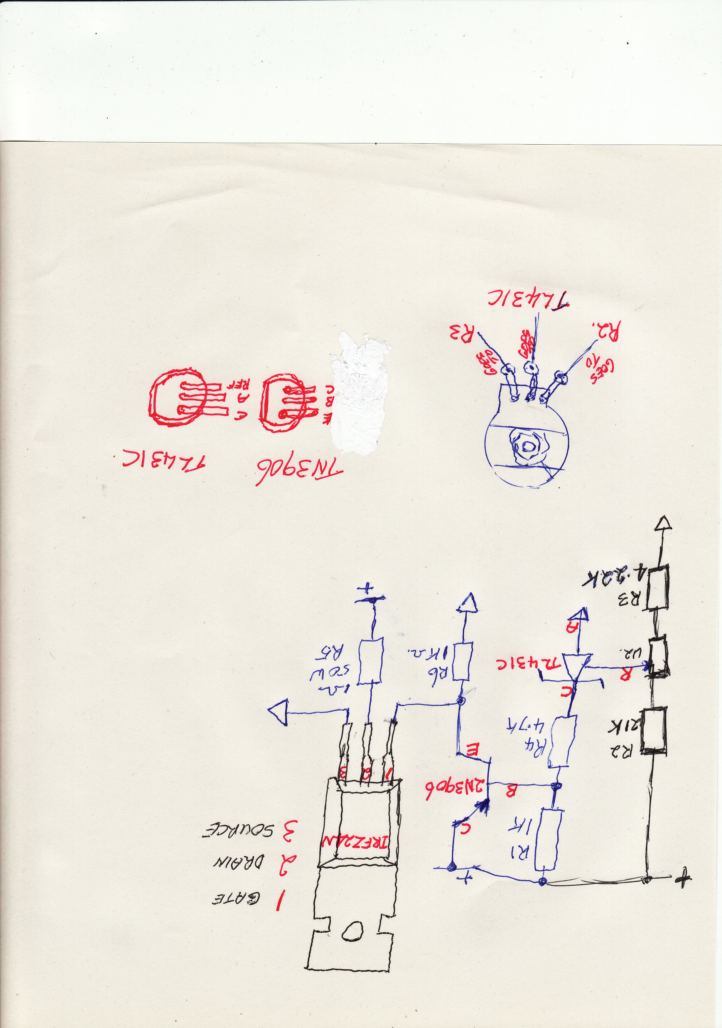

I have gone over the Circuit diagram I thing on the previous Circuit diagram that I drew I have the E, B, C 2N3906 the wrong way around but the one that I have attached to this post is correct Could you advise me if the E,B,C is correct.
I have made the board and I have placed the components on the board.
Just going through the final check.
Will place a photo of the finished project as soon as I am convinced that every thing is ok.
