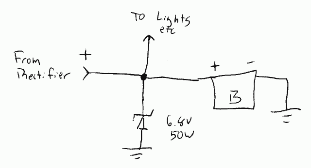

I have an old motorcycle from the early 70s with a 6V electrical system and no regulator -- as engine RPM rises, so does the alternator's output voltage. I would like to add a 6.8V, 50W zener diode shorted directly to ground, after the rectifier output, to keep the alternator from overcharging the battery.
I understand this is the same principal used in modern motorcycle regulators, but wanted a sanity check on the actual implementation. I found a NTE5247A zener which can be bolted to the frame, which would act as a very large heatsink.
Thoughts?
I would rather use a LM196 regulator set to 7V and advise against the zener.
The NTE5247A (6.8V +/- 5%) can have a knee voltage anywhere between 6.46 and 7.14 volts. 6.46 is too low and will prevent your battery from charging. 7.14 might be about right.
The one NTE5247A that I found is $27. You can build a better regulator for a lot less.
How about using a smaller zener and boosting it with a few large BJTs?
This was the system used on many 60's and 70's motorbikes, with a large zener diode on a heatsink mounted between the fork legs.
As suggested, a smaller zener feeding a large transistor would be a cheaper and easier soloution, or even an opamp feeding a transistor, where you could adjust the exact voltage.
As a matter of interest, it's called a 'shunt regulator'.
What's going to limit the current through the shunt device?
The available current from the alternator. Essentially with the headlight ON the alternator only just provides enough current to drive the headlight (at reasonable revs) and to trickle charge the battery. During daylight running (without the headlight ON) the zener dissipates the energy the headlight takes, minus the current the battery is charging with.
Motorbike alternators are generally permanent magnets, so there's no way to control it directly like a car alternator.

Thanks for the feedback. The thing I like about the zener is the dead-simple installation, so a complex IC-based solution is rather less attractive. If it will cost less, I suppose I could bolt a large transistor or two to the frame and feed them with a little zener, but I'm not sure what part to spec -- any suggestions on what transistor(s) would be appropriate?

FYI I ended up using a 7.5V 50W Zener, but it doesn't work: system voltage exceeds 8V when the engine is revved up. I don't know if I installed it wrong or if I got a bum part or what. Ah well.
It may be that the impedance of the diode at the breakdown knee is high enough to that that voltage increases to 8V with the excess current going through it. You may need diode with a Zener voltage of about 6.8V.
