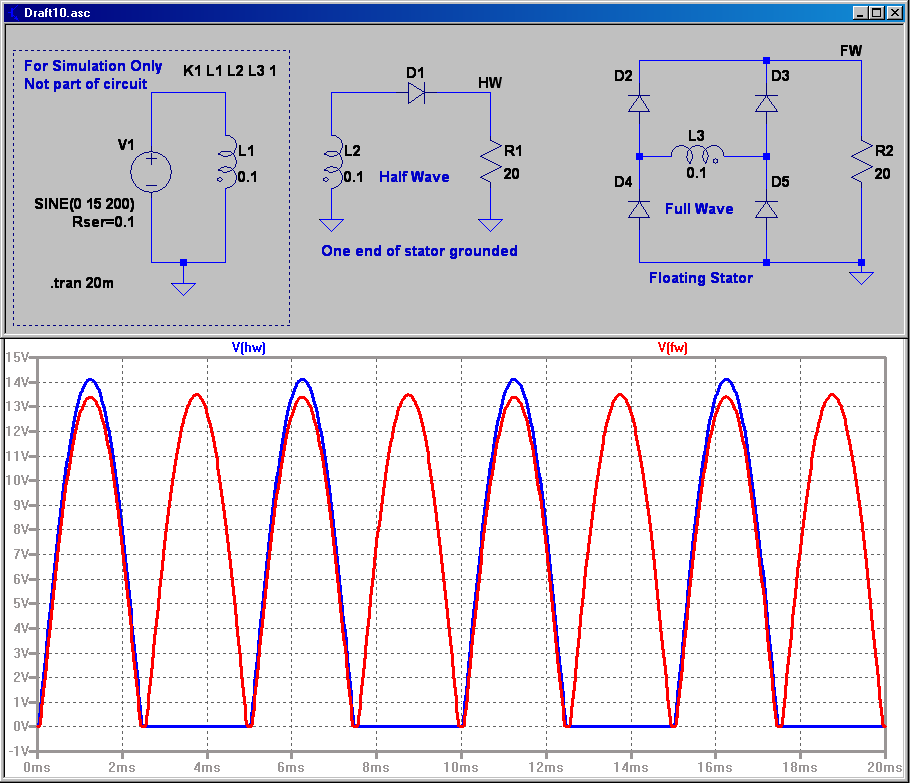

A three-phase alternator takes a six-diode full-wave bridge rectifier similar to what an automotive alternator has in it. I think you should dig into your single phase winding to see if you cant unground the winding and bring out both ends of the winding. That would enable you to use a full-wave four diode bridge, and get twice as much power out of the winding.

No center tap required. You just need access to both ends of the stator winding. You said there is only one wire coming out of the flywheel area of your motor, which means the other wire must be grounded. If you can un-ground it and bring out two wires (both ends of the winding, so the winding is floating with respect to ground), then you can connect the two wires to the AC terminals of a single-phase full-wave bridge rectifier and have twice the effective current with much less ripple.
So, grounding effectively saps half of the current? Wow. I am not sure if it is in an oil bath or if it has a dry magneto. I may attempt that.
Here is a sim showing a comparison between running with a stator one end of which is grounded (allowing only half-wave rectification) vs a floating stator (allowing full-wave rectification).
The load is the same. Look at the voltage across the load.

The voltage for the grounded side is slightly higher? Does that mean there is less current?
That is a consequence of having two forward diode voltage drops in series in the full-wave bridge vs only one in the half wave. However, the power delivered by the FW circuit is 4.2W while that delivered by the HW circuit is 2.4W.
