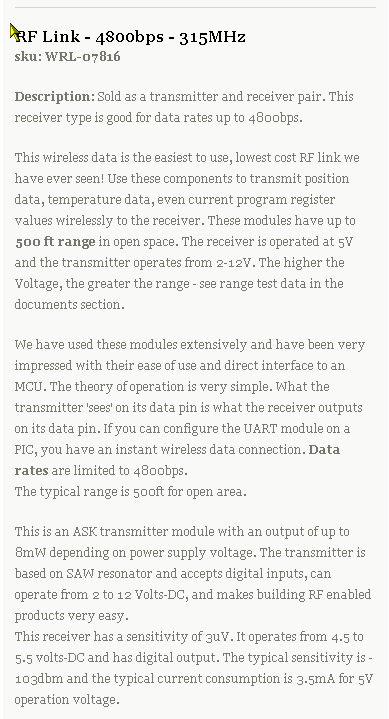

Attached a clip from the sparkfun tX data.
EDIT: added this tutorial link for sparkfun
https://www.electro-tech-online.com/custompdfs/2008/08/KLP_Walkthrough-1.pdf
They look like normal simple plain none encoded ones?.
Are they AM ones?, if they use simple ON/OFF modulation, that may well take care of the hardware inversion problem?.

Read the tutorial that sparkfun have produced regarding the direct connection to a PIC's uart it can't be any plainer than that.:p
