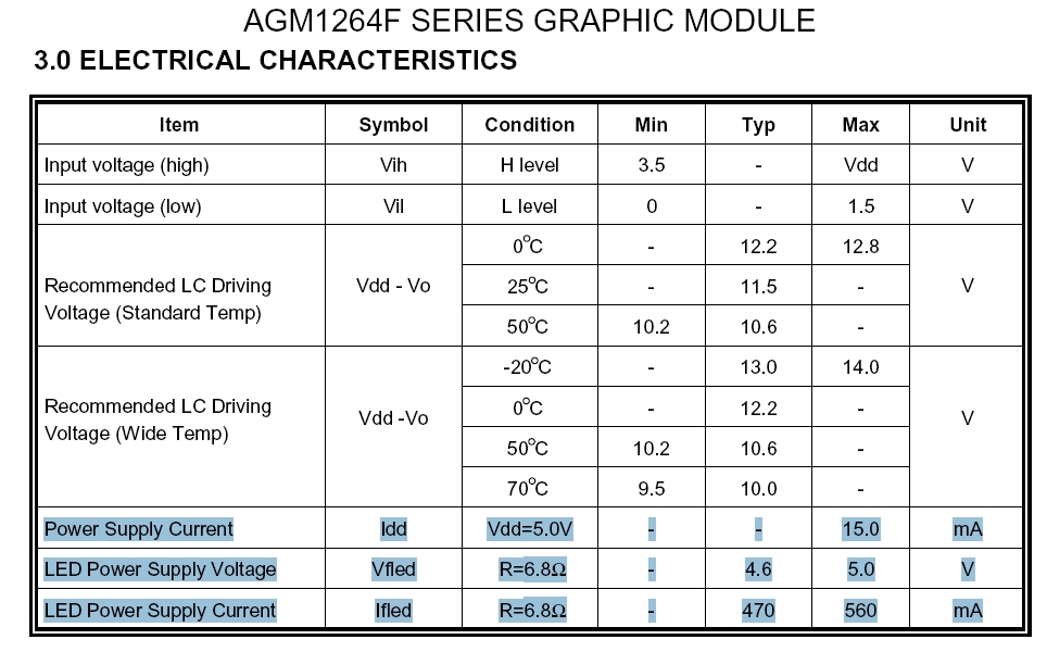

GLCD:
Power Supply Current 15.0 mA
LED Power Supply Current 470 to 560 mA
so thats a whopping 815mA max current:

Would i use that from the uC datasheet?

Pins can't both source and sink current at the same time and you're not going to be using all the I/O pins at the same time so you can ignore it, it's an absolute maximum rating for the :mu:C not what it uses. In reality the power consumption of the :mu:C will depend on the clock frequency and what you're doing but it won't be much, let's just assume 10mA.
That just leaves 40mA for the LEDs but I'd run them at 10mA each so the last longer giving just 20mA.
What do you mean 15mA for the power supply, is this the quiescent current for the linear regulator?
This leaves a maximum of 605mA.

For the "What do you mean 15mA" look at attachment. I will try measuring how much actual current the glcd draws at this moment.

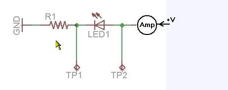

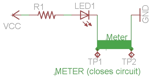

ok now im lost with measuring lol How would i measure a glcd? what points? I made a simple schem of a LED and a resistor. Would i measure at tp1 & tp2 ?
cur-jpg.21382
if so from a actual circuit i got (using a 1.2k ohm) 2.71mA
hi atom,
If you are asking me, I would set my test meter to current and measure the current in the +V lead to the GLCD.

yeah i was looking at my breadboard wrong lol
but ohms law says i = v / r which would be
5.18v / 1.2K (1200) = 0.0041mA
Which should be 4mA why do i read 2.7mA ?
EDIT:
I see without the led its 4.3mA. How would i account for led?
And when i add led why is it showing less current?

If you want a precise measurement, as I dont know the value of your meters internal shunt resistor, at the same you measure the current, measure the voltage on the circuit side of the ammeter.
OK.
Measuring on either side of the ammeter 'A' and then 'B', will give the value of the ammeter internal resistance... [ for future calculations]
EDIT: I would always, where possible., measure in the circuits +V input lead, not on the low side as you have shown..

Its drawing less current with the LED, because of the forward voltage drop across the LED.!
