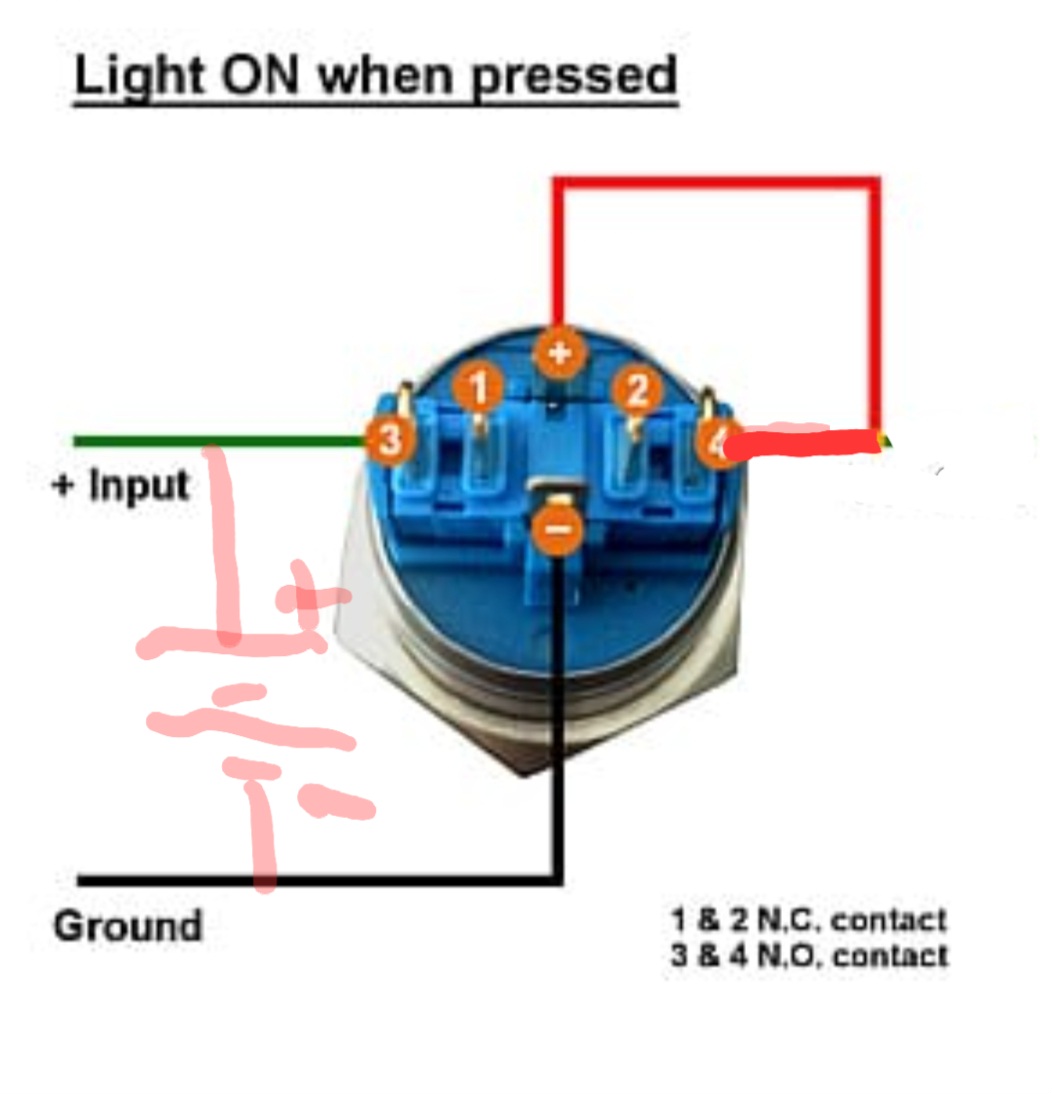

I'm having difficulty following the wiring in the photos.
The connection on each switch should be:
Battery positive to one switch contact (eg. Common)
Other switch contact (eg. Normally Open) linked to LED positive
LED negative to battery negative.
One or two 9V batteries should probably be enough; the LED illuminated switches of similar styles I've used are not at all critical on voltage.
If you want the switches to only work in sequence, feed the common of the next switch from the normally open contact of the previous one.
For a 9 volt battery to blow a hole in the side, there must be maintained dead short someplace.
The LEDs may need series resistors. Some switches include them, so don't.
Those switches aren't all wired the same, but this seems to be the type you have. V+ goes to the COM terminal. The NO (Normally Open) terminal goes to the LED + terminal. The LED – terminal goes to battery –. No other connections should be made.

Will this do for a wiring schematic. I found that I dont need 24 v to work one LED switch, a single pp3 pattery will do it but no idea on the resistor needed, both what ohms ansd should it be one resitor for all switches on the ground or power line or should or be one per button or switch? See the attachments. Note that normally these buttons would operate somethgin like a light or gadget etc. ive bypassed this stright to ground as only need the buttons to light up

Reinterating, this type of switch usually has the resistor built in. If the switch is sold as a "12 volt switch" or a "24 volt switch", this should be the case.
All of the switches will be connected in parallel across the battery – try a single 9 volt battery.
Battery + to switch COM
Switch NO to LED+
LED – to battery –

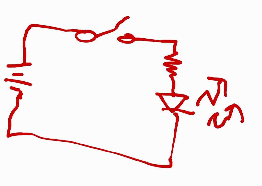

Excuse the crude drawing. It's the best you get at 2:50AM.

In the drawing in post 11, you're connecting battery – to battery + when the switch is on. Bad things happen
Let's try this again. The picture is different, but the words are the same.
Switch NO to LED+
LED – to battery –
Prototoypig with one pp3 battery got one switch lightign up so guess that will work for all. WOuld 2 batteries in parllel mean logner lastign batteries? BUt need to sort the resitor issue
I think I've said this already – to have a battery blow up, you have a direct short from + to –. Some of your pictures look like this is the case.
I believe your switches have resistors built in. If you blew holes in the battery, but all of the LEDs still work, resistors aren't the problem.
Wite the switches like this, and they will work.
Switch NO to LED+
LED – to battery –
Thanks not sure what if the switches did have resistors but ecperiments shows one swithc works with a 2 k resistor that does not get hot, 500ohms did so hve been attaching 2 k resisotrs to each swithc and been solderign it all together. not fully tested it yet
If that works, go for it.
Connect the resistor between switch NO and LED + instead of a jumper. Make no other changes or connections than shown.
