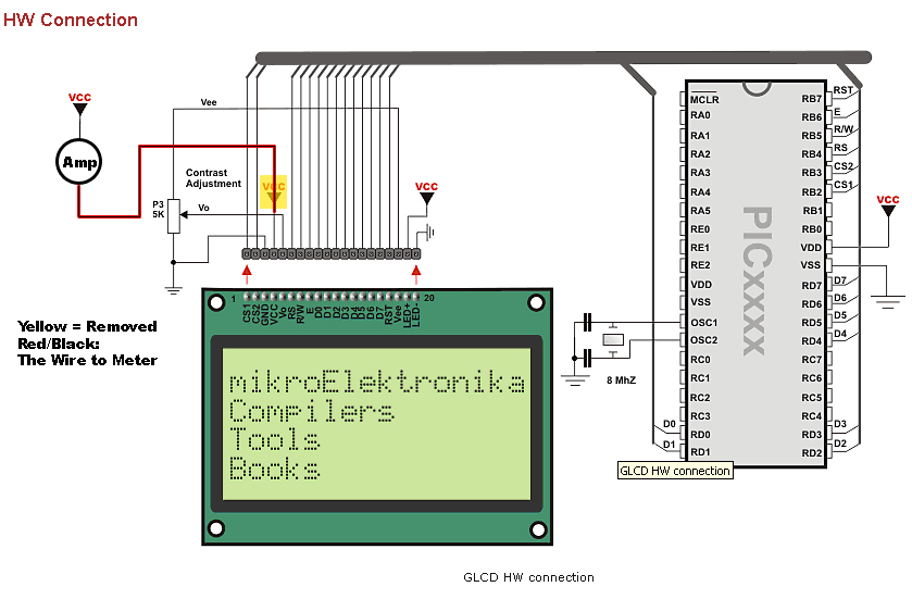

ok Erric. I disconnected the +v and closed the circuit from v+ supply to +V i disconnected and i measure .003A (3mA). Would that be correct? Below is a image of what i did.
gcurr-jpg.21385
EDIT: I forgot 1 wire lol i fixed (re-read above)
I did it straight to power like vin is closed by amp meter and its shows 160mA

That looks better.
What about +/-Vled you dont show a series resistor.?
Also whats the voltage on the circuit side of the ammeter.?

Ok:
AMP Meter = .003A (3mA)
Volt. Meter = 5.09v (testing from gnd to circuit side of amp meter)

I would expect the GLCD on its own to be a 2 or 3milliamps,[ as you have measured] thats not including the 8R and Vled backlight current or the PIC shown in the picture.
Do the same current test for the 8R and +V backlight and repeat it for the PIC.
Adding all these different currents should give a total current value.
Once you have that total current value, you can start thinking about batteries.
If you want to maximise battery life, you only need the backlight when someone is viewing the GLCD.!
A simple push button for the B/L would be OK.
Current For Project:
GLCD = 3mA
GLCD_LED = 143mA
Pic (uC) = 25mA
Total = 171mA
