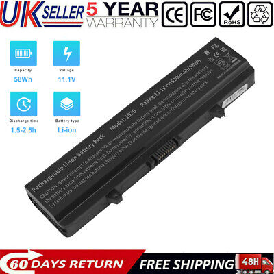

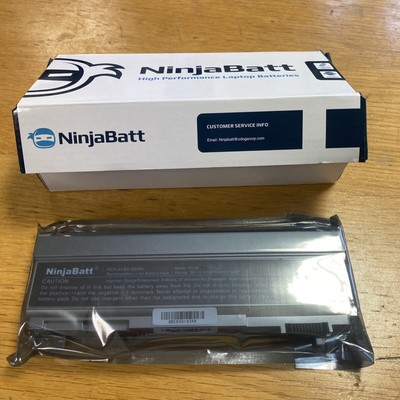

Look at laptop batteries from ebay, amazon, or some supplier that has some kind of warranty (so you know they won't knowingly sell bad stuff).
eg. You can get a battery that contains four or six decent quality cells for around £15 or less. They are generally easy to split open and the cells have link strips you can cut, or tags, making soldering easier and less likely to damage the cells.
eg.
Four 2.2AH cells for £13.99:
Six 2.2AH cells for £12.99 !
Also, most cheap cells claiming to be over 2.2AH have fake markings - I've never found one yet with genuine high capacity. Unless they are original Samsung etc., they are usually scams.

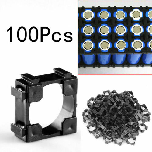

The original cell interconnecting strips are cut near the centre then the ends folded back to keep them inside the cell end area.
The grid clips for making up blocks of cells are available on ebay, such as these:
