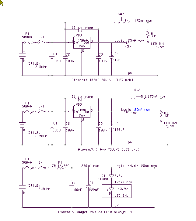

If lets say i wanted the project to last minimum of 6-8 hours on a charge Would 5 batteries do it?
5 x 1.2v = 6v @ 2500 mAh
If im using about 170 mA (if BL isnt auto)
2500 / 171 = 14.61xx (14 Hours)
If i make a auto back like turn on, on interrupt that would make it 71mA total when off
2500 / 71 = 35 Hours
would that be correct?

The sums look OK to me, looking at the discharge graph of your cells, assuming good fully charged cells,
whats the cell voltage after 8 hours at both discharge currents [ with/without LED B/L]
Looking at the graph it looks flat at 1.2V for most of the 0.2C rate.
Next step would be to run the project for 8 hours, from fully charged, note the voltage
then keep the test going until the cells goto 1.1v [ 5.5V]
Type of Vreg, it must be LVDO +5V rated at least 250mA
You can get LVDO's with a 0.45V drop out.
Do you follow OK.?:)
EDIT: I would estimate 12 hours with the B/L ON and about 24 hours with it OFF.

hi atom,
Look at these two options.
The 10/12R resistor for the LED B/L could go before the Vreg if you use the 150mA version or after the Vreg if you use the 1Amp version.
I would connect the B/L before the Vreg.
hi atom,
Some circuits to consider.
Cct1 is a 150mA LVDO +5Vreg, with the B/L connection before the Vreg, push button for the B/L
Cct1 is a 1Amp LVDO +5Vreg, B/L on the +5V line, push button for the B/L
Cct3 is using the B/L LED's and an extra diode as a shunt regulator, giving a +4.6Vnom for the PIC logic, B/L must always be connected... its the el-cheapo version.:)

Ericgibbs:
i think i would use the 1amp mostly because i know i will be adding things to this like at least:
1 LED
1 IR LED (Maybe some zigbee wireless)
and maybe something else
