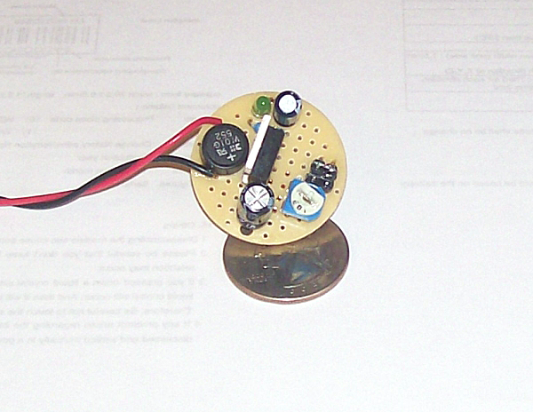

ok just made my variable power supply lol. So small and simple. Rectifier and all. I will try what you said before about testing minimums. Here is it(the psu):
Normal 162mA @ 5v
120mA = Barely viewable. V = 4.7v (kinda jumpy since using a pot)
I guess once the hits 120mA needs recharging also @ 16mA the PIC is still running! Cool.
Around 2-3 mA the pic turns off(resets). The only issue is the screen needs plenty of power. 5v @130mA min
Neat looking little psu.
With the measurements you have got it should be possible to work out the best battery for the job.

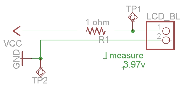

Whats the voltage measure across the LCD backlight leds, between the junction of the 8R and the LED's to 0V.???? Use +5V as normal for the test.
Like this? I measure 3.97V from those points.
I think the 1R0 must be a dwg error.? 8R thru 12R.??
Reason for asking was regarding the lower voltage tests you did.
Below about 3.9Vsupply the B/L leds should not be lit, so the current drawn from the psu should be the current only required by the PIC.
yep i didnt notice i forgot the "0" lol its a 10 Ohm. Sorry about that. And yes below a voltage i think it was like 3.8v or your 3.9v the BL turns off.
