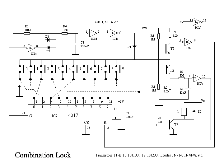

Attached is an electronic one that I designed some years ago.
L is the door solenoid.
The counter is advanced each time the correct button is pressed. If the wrong button is pressed, the counter is reset.

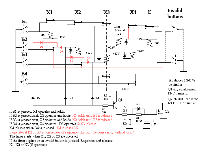

Here is how I would do it with relays.

The "total operation time" in my circuit is done by R1 & C1 & Q2. The timing starts if X1, X2 or X3 are operated. I noticed that your circuit has a delay in the operation of the Door Solenoid. I do not think that is necessary, but this may be one of your "traps" intended to make it difficult to circumvent the system. Such a delay could be added to my circuit if necessary.
Yes, your point about the invalid buttons is a good one.
In my first design, I had an extra relay labelled E (for error) that operated if an invalid button was pressed. But I felt it was unnecessary, so I removed it and made double use of X4.
However, this leads to the problem you have mentioned.

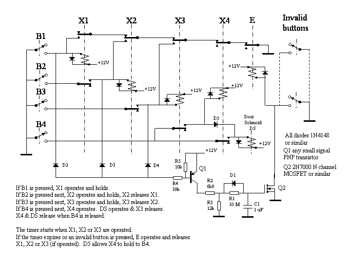

Here is my first design.

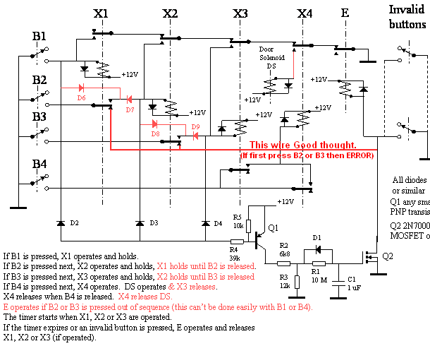

Ok...
So , please see your in shema error.
What error?

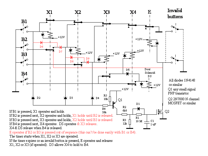

Note that I have just edited my previous post as there was a minor error in the circuit. (D4 should have been D5)
You responded to this post while I was editing it. So you have not read some of my comments,
I don't see what the problem is.
Your "Error connect" drawing is not correct. DS is not operated directly by B4.
X4 operates when B4 is pressed. DS operates when X4 operates, ie. B4 AND X4 must be operated to operate DS..
When B4 is released, both X4 and DS release.
This is exactly what I intended.
I have made a minor improvement to my circuit.
I have changed it so that if B2 or B3 is pressed out of sequence, relay E operates and releases any X relay that is operated.

Answers and questions in response to your points:-
1. I'm not sure what you mean. Do you mean that the N/O contact opens 2 ~ 5 ms after the coil circuit is opened, ie. the relay release time? Why is this an issue?
Also, remember that the diode across the coil will increase the release time.
2. X3 is supposed to release when X4 operates.
3, 4. Yes, the current through the X4 contact is Ir + Ids. That is how it is meant to be.Why is this an issue?
I explained how it works in my previous post, ie. X4 operates when B4 is pressed. DS operates when X4 operates, ie. B4 AND X4 must be operated to operate DS.
Hence, X4 and DS both release when B4 is released and the circuit returns to its initial state.
Now I understand.
The coil current of DS is too much for the B4 contacts.
Here is a simple solution and it has the additional advantage that D5 is not required.
ljcox said:
Now I understand.
Yes...Now DS-B4 problem is OK...
