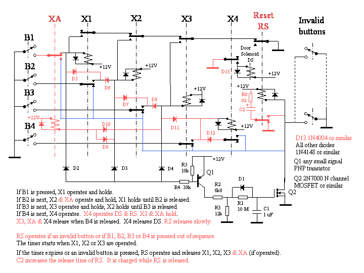

Basic , with Relay's Code Circuit Diagram...
Hayrettin Demir said:
Firstly , Error Relay Coil parallel appr. 4700uF Condensator required.
Why do you need a capacitor that large?
What is the resistance of the relay coil?
If any Error Buttons press.For this is delay time required...
(appr.2200-4700uF--> For 5sn (appr.) delay time to get).
Here is the circuit with additional error logic so that circuit will be reset if B1 or B4 are pressed out of sequence.
I have changed the name of relay E to RS as it now does a reset function even when the correct sequence of buttons is pressed.
The release time of RS (determined by C2) allows time for the release of any operated relays.

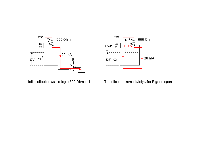

Ok...
Now identically for X4 Relays delay time required.(approx. 1-3sn)...
X4 is operated for the time that the B4 button is pressed, so I don't see why you need to increase its release delay.
If B4 button 0,1sn pressed...
Then X4 0,1sn operated and DS 0,1sn active.
(DS --> 1-3sn active to be). So you want to limit the time that DS is energised regardless of how long B4 is pressed. If so, then you will need to do more than just making X4 slow to release....
So ;
If B4 button 10sn or more pressed...
Then X4 10sn or more operated and DS 10sn or more active...
This is a problem for DS...(DS is break down !). Yes, DS is likely to over heat and burn....
Series resistor (82 Ohm) is only for charge required. Yes, but it makes little difference to the release time. As I said previously, this is a standard technique used to increase relay release time.
I have never seen a diode across the resistor.
What you are missing is that the resistor increases the time constant and may in fact sligthy increase the release time compared to the case where the diode is included.
It is a complex situation. The initial voltage across the coil will be 12 Volt, not 11.3 as you have shown since, due to the coil inductance, the current does not change when the button is released.
In your second diagram, ie. where there is no diode, the voltage across the coil will be 12 Volt and the voltage across the resistor will be I * R where I is the coil current and R is the resistance of the resistor. For example, if the coil resistance is 600 Ohm, the current will be 12/0.6 = 20 mA.
If R = 82 Ohm, the voltage across it will be 20/1000 * 82 = 1.64 volt.
This is what I mean
Oops I made an error. See the revised diagram.

You did not look at my latest edit. The initial relay current is 20 mA.
My error was that I forgot to adjust the relay coil voltage.
It is 10.36 Volt which obeys Kirchoff.
I expect your next point will be - that is not 12 Volt, so the relay delay will be less.
But the magnetic force on the armature is proportional to the current, not the voltage.
My diagram shows that the current does not change (due to the nature of inductance) when the switch is opened. It decays from 20 mA.
So there will be little difference in the release delay. In fact it may be slightly longer since the capacitive time constant is a little greater due to the 82 Ohm resistor.

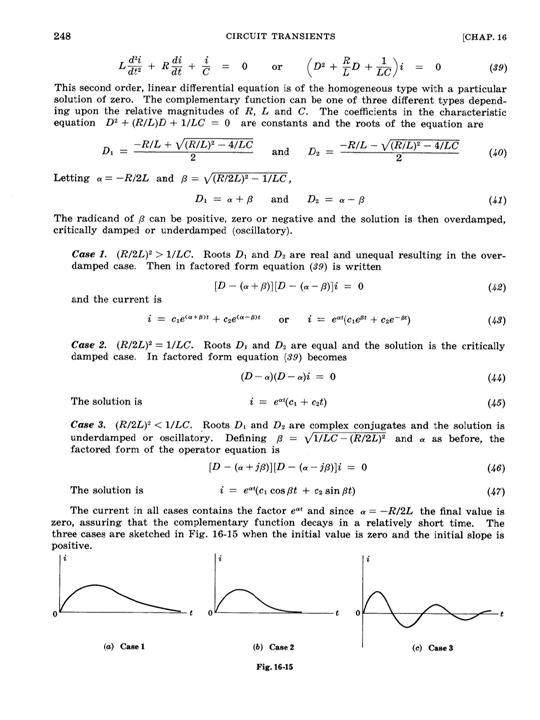

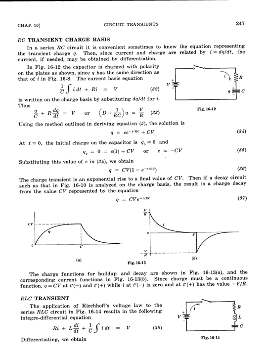

It is not possible to do this by intuition. You need to solve a second order differential equation and include the relevant initial conditions.
See the attachments. Start at the heading "RLC Transient" near the bottom of page 247.
This gives you an idea of what I'm trying to say. In your case, the initial conditions are:-
1. the capacitor has an initial charge of 12 Volt
2. the inductance of the relay coil has an initial current of 20 mA (assuming a 600 Ohm coil resistance).
So these need to be included in the mathematics.

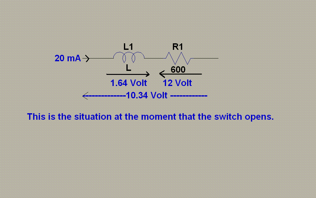

Please check again...
You have added the capacitor and resistor voltages.
The arrows show the polarity. Therefore the voltage across C1 is 10.36 + 1.64 = 12 Volt. As I said previously.
The point you're missing is that the back EMF of the coil is 1.64 Volt

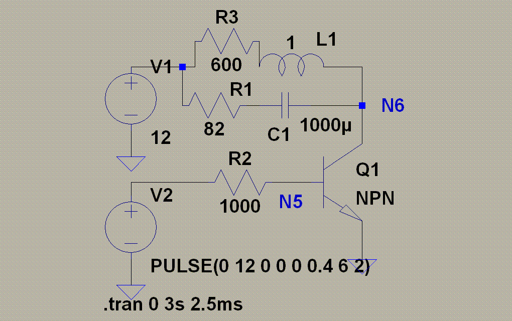

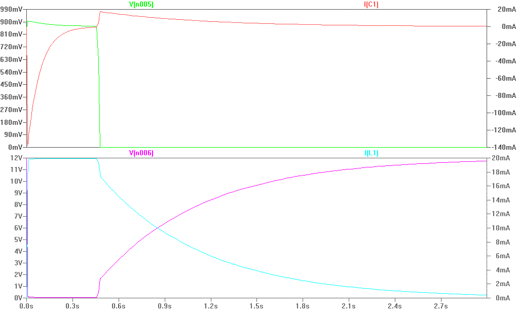

I have simulated the circuit using Switcher CAD III.
The relay coil is simulated by R3 and L1. I have assumed that the inductance is 1 Henry. I have use a transistor to simulate the switch.
The Red curve is the current through C1. It is negative when the capacitor is charging.
The Green curve is the transistor base voltage.
The Blue curve is the current through the coil.
The Pink curve is the collector voltage.
Note that, while the transistor is on, the coil current is 20 mA and the C1 charges to 12 Volt.
When the transistor is turned off, the coil current decays from 20 mA.

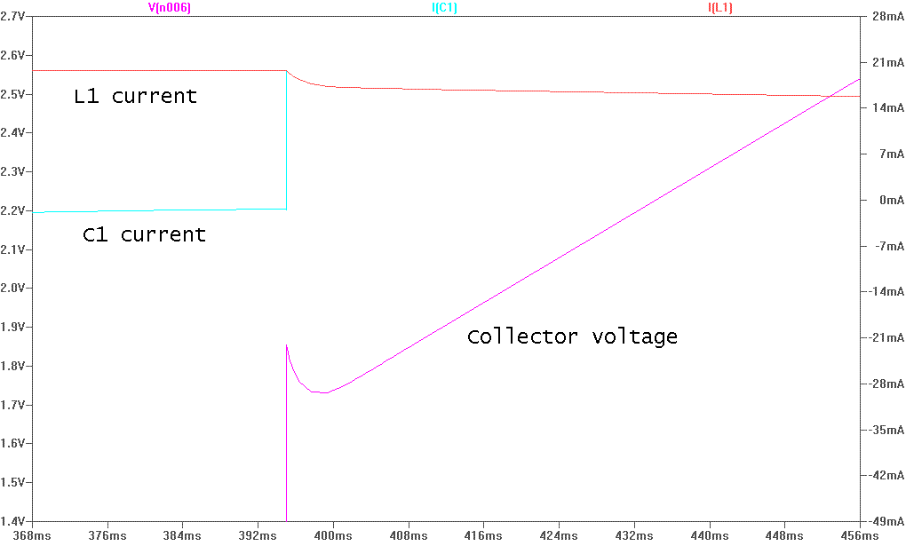

Here is a diagram showing the relay coil voltages at the instant that the switch is opened.
For simplicity, I have not shown the capacitor and 82 Ohm resistor that are connected across the coil.
It shows that the back EMF is 1.64 Volt and this is driving the current. The back EMF is of such a value as to keep the same current flowing that was flowing just before the switch opens,
The coil can be considered to be an inductance in series with a resistance.
EDIT:
Here is a more accurate wave form chart. The transistor was not switching fast enough, so I had to change some parameters in the simulation.
Notr that the C1 current is equal to the L1 current immediately the transistor is turned off - as expected. They both decay from 20 mA.
