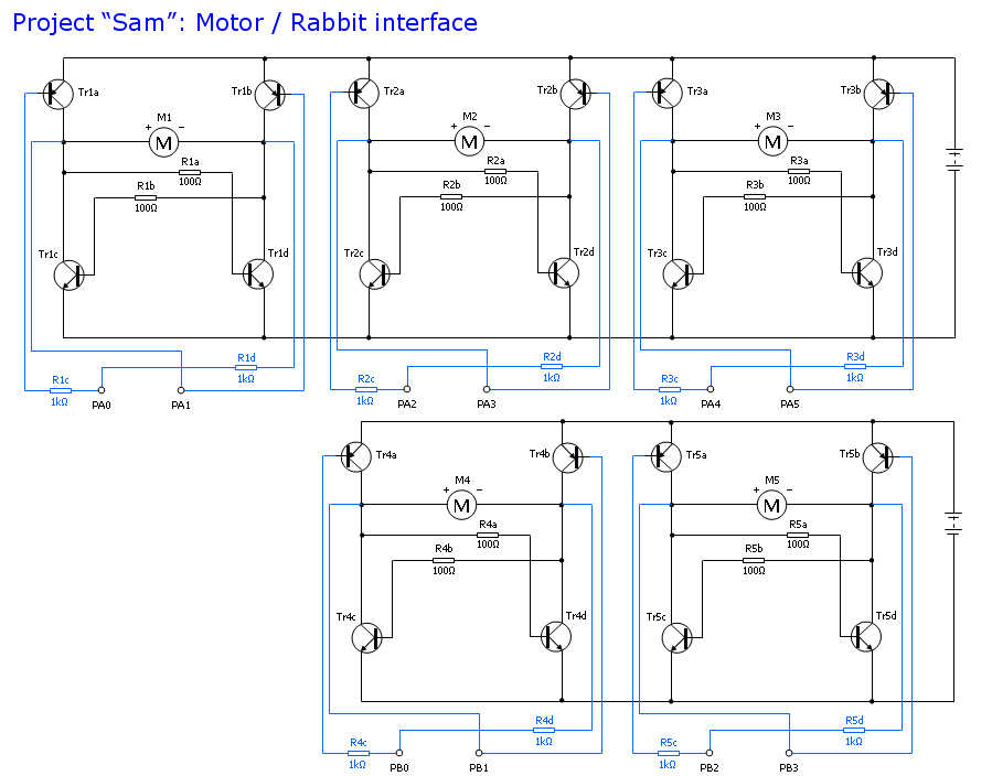

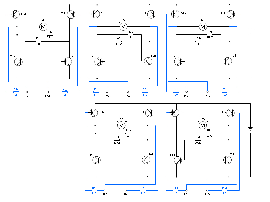

By 'bridging', I mean 'connecting'. I am passing a current between PA0 and PA1 (or vice verca) to activate the top BJTs.
It just struck me that I could simplify the circuit to remove D(n)b and D(n)c diodes now that only two of the transistors are being activated by the µP directly though; I should now be able to simply connect PA1 to the emitter of Tr1a, and PA0 to the emitter of Tr1b, which wasn't possible with the previous schematic. And of course, follow the same procedure for the others.
In fact, that should remove the need for any of the diodes... eureka :D it appears hero's modification to my original idea has made my ground return much simpler. I'll post a new schematic shortly.
Thanks to hero's schematic, my original idea (before needing to come up with the complicated plan involving Schottkys and whatnot) should work, I think - comments are welcome. This has saved me money on diodes and voltage by avoiding the diodes - thanks Hero! :D
Again, comments, suggestions, and questions are welcome. :)
The transistors which need to be activated have essentially just been placed between PA0 and PA1 (and the corresponding ports for the other 4 h-bridges), such that neither are on when PA0 = PA1, and otherwise the correct transistor comes on. My only remaining worry is whether the transistor will pass current from emitter to base - however, based on my understanding of transistors base -> emitter should essentially act as a diode and will therefore not allow a reverse current across these terminals. The other note is that the motor itself has also been placed directly between the two uP terminals, causing a short... but if I move the resistors RXd to the wire immediately above where they're currently situated (I will change the schematic later) the current should be reduced to ~3mA here anyway.

Your latest schematic in post #266 does not look like Hero999's schematic in post #256.
You left out two very important transistors, six resistors, and one Schottky diode per circuit.
I think we are all glad you have saved the 'organic ground' invention for later.
I don't understand what you mean. That's the complete schematic. What is missing? :confused:
Any connection to a micro to make it work, plus resistors I would consider pretty well essential.

And does that work?, lack of a common ground makes it look like it wouldn't.
Again, does it work? - nothing in the minimal circuit (or the previous one for that matter) inspires me to think so.

I don't care. I've given up. I haven't listened to half of what you've said because the only one who's listened to half of what *I've* said has been marcbarker. I'm not interested in completing this project anymore, it's already taken up enough of my time and been shot down repeatedly. Clearly it's beyond my ability. If it was possible to delete owned threads in this forum I would have done so already.
Feel free to continue replying to the thread if you really want but I'm unsubscribing from it now.
I don't see why you should feel like that: no one's shot down your project, just the way you've intended to build the h-bridge.
To me it seems like you've got too much pride in your original idea that you won't accept anyone else's.
I've already solved the problem for you, just use the schematic I previously posted and the transistors I suggested and it will work.
There's no point in asking for help and advice if you're too proud to accept it.

I understand how your previous schematic works or at least this one.
https://www.electro-tech-online.com/attachments/sam-motor-proto1c-jpg.32016/
It will work is a base resistor is added to each low side transistor and the 12R resitor is removed.
The top transistors are configured as emitter followers which will loose 0.7V plus the saturation voltage. The bottom transistors are configured as common emitter switches.
The diodes direct the voltages from the I/O ports to the MCU 0V via the port which is at 0V.
When both inputs are high, no transistors will turn on because there is no potential difference.
The problem is the high saturation loss on the high side, and if there are other h-bridges in the circuit the double high protection won't work because other inputs might be low which will create a 0V for the current to flow to.
Try analysing my circuit.

I don't understand why my grounding circuitry won't work. If you're all so certain it won't, then could one of you explain why not?
Just to be clear, I have included the schematic to which I'm referring in this post.
And just to be completely clear, as marcbarker pointed out earlier, if any of the ports are H they're connected to the 3.3V µP supply, if they're L they're connected to the µP's 0V GND. So there is a common µP ground.
If you think my circuit won't work but won't provide a reason better than that it doesn't all connect directly to the µP's GND pin, then I don't want to know.
This where most of us parted ways.
You footnoted your 'final' circuit with something like - the motor is shorted to PA0 and PA1 but we'll handle that later. I pointed out that the transistors that you removed from Hero999's offering were too important to leave out.
I look back and see that I was harsh in the way that I expressed this, and I didn't give a specific electronic/physics reason. I thought it was covered. Summarized here:
Connecting PA0 and PA1 (8mA) to the motor (1A) shouldn't be done. I don't know how to fix that without the two removed transistors. Similarly, reverse/forward protection is missing. The Schottky diode is the simplest way. Further, the bases should to have stray charges drained (not essential, but cheap insurance). Hence the resistors added from bases to emitters. Collector resistors are needed on the 2 driver transistors to limit their collector current. And, early in the thread, if you are avoiding protection diodes, 0.1 uf across the motors to limit the inductive kickback and noise.
As for ground, suit yourself. It's so fundamental to most of us that maybe we've lost our ability to consider just leaving it open. Your small system will work most of the time. Maybe for a toy we've just set our standard too high.
I believe that marcbarker is enthusiastic about your circuit, but I would still like to see it work.
