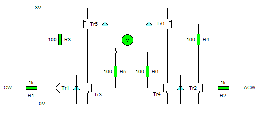

I have one more silly question before I draw up my final schematic. Hero999, on the schematic you posted (reattached here); when Tr5 is activated, why does current not flow thorugh Tr5, through the motors, and through R5 to activate Tr3 and cause a battery short-circuit across Tr3 and Tr5? What prevents some of the current being able to make it to here? :confused:
Both TR5 and TR6 (at least) require resistors between base and emitter, to ensure they aren't turned on by any slight leakage.
That schematic was taken before I added the short protection circuitry.
Nigel is right that it noise could forward bias the transistors turning them on and allowing leakage.
I've built similar circuits without a problem before and haven't had a problem by resistors are cheap so you might as well include them. The value isn't critical, 10k will do.
The transistors that interface directly to the MCU don't need any base emitter resistors as the MCU has a push pull output so will connect them to 0V.

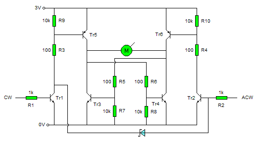

Okay, here goes... if I end up having to make major adjustments to this one I may have a nervous breakdown.
Transistors Tr(n)a and Tr(n)b are ZTX790A high-gain transistors, Tr(n)c and Tr(n)d will be 'standard' transistors. Schottky Diodes D(n)a will be 2A diodes to prevent them being damaged if the current rises above 1A when a motor stalls.
Comments, suggestions, improvements, and questions are welcome.

What's with the Schottky diodes?
They'll drop extra voltage.
The Schottky diodes are there to control the ground return from the microprocessor, so that the current can be controlled by pairs of terminals PA0/1, PA2/3, and so forth. The design is such that a HH state in a pair of controlling bits will have the same effect as a LL state, which will prevent a software error from accidentally turning both PA0 and PA1 high, for example, which would activate all of Tr1a-d, causing a short circuit which would damage a good chunk of the circuitry.
I think the added voltage drop is a worthwhile trade-off to add this protection feature. Though I may have to raise the voltage of the batteries used to compensate for this loss.
Perhaps it's just me?, or you've not shown all of the circuit?, but I fail to see how the diodes offer protection.
