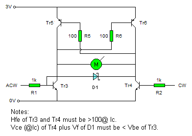

Just a thought, have you looked into using high gain transistors?
The ZTX690 (NPN) has a maximum saturation voltage of 0.5V with a collector current of 1A and base current of just 5mA.
The ZTX790 (PNP) has a maximum saturation voltage of just 0.45V with a collector current of 1A and a base current of just 10mA.
If you use high gain transistors (at least for the low side) you can eliminate Tr1 and Tr2 in my original circuit.
The above transistors are also very tough and will probably withstand the stall current. Just make sure the motor can handle being stalled so doesn't catch fire. :D
A simple 0.5A polyfuse is all that's needed to protect the motor assuming that it stalling could cause it to burn out; it might be all right.
The circuit posted below uses the high gain transistors for Tr3 and Tr4 and normal transistors for Tr5 and Tr6.
If you use high gain transistors for Tr5 and Tr6, R5 and R6 can be increased to 1k which will save power.
At 200mA the saturation voltage of Tr4, plus the turn on voltage of the Schottky should be < Tr3's turn on voltage, so the protection for both inputs being high should still work.

It appears that the schematic is slowly creeping back in the direction of my original schematic, with the addition of the high-gain transistors. I'll check out the link you gave me in a sec.

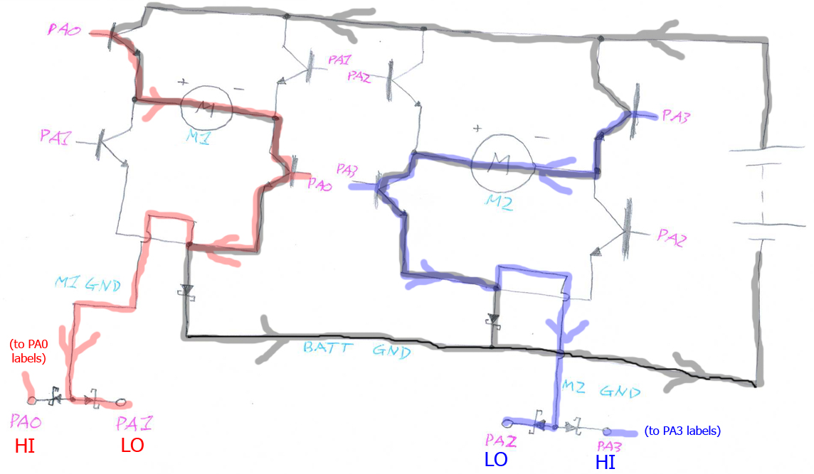

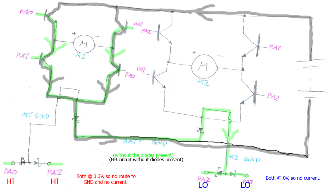

(Open-forum-mode on) What's the issue with diodes in the ground side?
These are annotated schematic diagrams which marcbarker requested to explain my diodes in the ground part of the circuits, perhaps other people can comment on them also.
Note that the lack of resistors / the fact that the BJTs won't work correctly isn't important, I'm just using the basic H-Bridge construct to simplify the diagram and focus the attention on the earth wiring. If this ground-side wiring works the way I expect it to, I can apply the concept to hero's schematic, thus obtaining perfection :D okay not quite, but it'll be a good composite of the two :p
Please excuse the rough hand-drawing of the circuits. Red shows current for the uP circuits of M1, blue for the same for M2, and black for the motor driving current. The green in the second circuit shows what would happen if not for the schottky isolation diodes I used, and black in that schematic shows the short-circuit in the battery circuit which would result.

OK, I see where you're coming from now....
The sketches you'd posted is a concept only to illustrate a point, and not a practical circuit design. A lot of detail is ommitted, to improve clarity.
Looking at the righthand sketch. In this theorectical scheme, the current which activates the BJTs, originates from the IC, flows into the bases and out the emitters, going towards a logic L output where it returns back to the IC. There is no hard-wired ground between uC and battery ground. Presumably this would be to save wiring.
The right hand skech showing both PA0 and PA1 are both = HH. This could happen due to a uC start-up condition. If there was no protection present in the hardware, the H-bridge would go into 'shoot-thru' and that's not good.
The current flows in the green coloured path, however, the right hand diode underneath M2 will block this current from reaching the PA2 and PA3 (labelled M2 gnd). Therefore the transistors are starved of current (because of the diode) and they can't switch on very well, if at all.
So protection is offered, but it costs the voltage drop in the motor circuit, which is probably acceptable.
Like the saying goes "there's more than one way to skin a cat". There are probably more ways to implement shoot-thru protection and this is just one of them.
