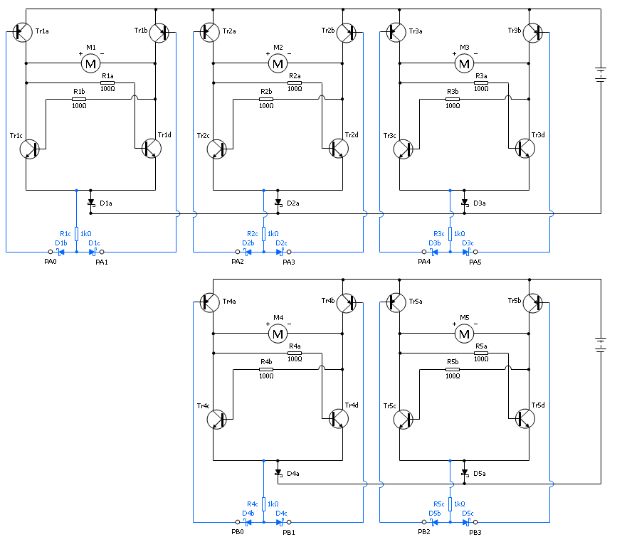

That won't work at all.
For a start, there's no base resistors on PA1.
The high side transistors are now PNP so are turned on when their bases are connected to 0V.
When PA1 is high and PA0 is low no transistors will turn on because the collectors will be higher than the bases.
I pointed out that the transistors that you removed from Hero999's offering were too important to leave out.
I didn't leave out any transistors, though. Hero's updated schematic removed two of the transistors and simply made the top two transistors high-gain. This is the schematic on which I based mine.
I see your point: I had overlooked that. Perhaps a couple of diodes will still be required to make my system work the way I wanted.
Essentially all I'm trying to do is put the base-emitter of Tr1a across PA0-PA1, and the base-emitter of Tr1b across PA1-PA0, and eliminate any alternative routes by which the current might flow. In my haste to amend my over-schottkied circuit though, I may have overlooked a few things.
If anyone can suggest the best way of wiring it to produce this effect, it will be very much appreciated.

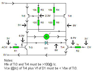

Here's a picture that illustrates the conventional current flow in the circuit. It shows you how the Schottky diode protects the h-bridge from both inputs going high.
The 0V of this circuit must be joined to the 0V rail of microcontroller or else it won't work.
Do you understand that the problem with your phantom ground idea is that won't work with more than one h-bridge in the circuit?
Do you now understand how the Schottky diode works in my circuit?
Do you understand that if both the inputs are 0 on a neighbouring h-bridge the other h-bridge won't be protected from both inputs being high because the lows on its neighbour will provide a ground?
I got around these problems before by adding extra schottky diodes to further isolate the groundwork, as you could see in my earlier schematics. But if your way does provide this protection, then I apologise as I didn't realise that this was the case; I thought the only H-H protection your circuit offered was to limit the current to a low enough value that it won't cause damage. I'll take a look at the diagram you posted now and maybe it'll shed some light. It was the H-H protection that all of my 'phantom ground' (in your words) circuitry was designed for, but if your schematic does the job in a simpler way that I'll adopt the schematic.

It's not that grounding through the 'low' outputs "won't work". It's about how well it will work, and what problem does it solve. What are the trade offs?
Your logic levels are degraded. The 3.3V "high" (which was really less than 3.3V) is robbed of a diode drop or a Vbe, or both.
If you do have two outputs such as PA0, PA1 high, then their 8mA+8mA will both want to flow somewhere else such as PA3 (which is already carrying 8mA from PA2).
If somebody walks across a carpet on a dry day and generates a 1kV spark (well below what you would notice) on the robot, it will flow through PA0..PA7 towards the earth on the microcontroller chassis and the wall wart. Microcontroller inputs are likely to get fried.
Incoming electromagnetic noise such as from nearby (1km) radio and television broadcasters (or very nearby cell phones) may cause unexplained upsets. Similarly, an Earth accompanying signals can reduce the likelihood of causing interference to others.
Advantage: If all of the PA0..PA7 lines are driven high (or floating), the motors will shut off. This protection is defeated if any line is driven low, in which case the sole low PA signal is overloaded.
I'm not quite sure - is it simply that when Tr4 is activated, it draws away enough of the current from the CW terminal through Tr4 and to ground, that the current through Tr3's base isn't enough to activate it?
If that's all it is, then I shall slap my forehead in disgust that all of my careful and unfortunately inefficient designs could have been avoided by something that simple all this time...
Of course, if someone had explained this at the start the schematic war could have been avoided ;)
If Tr6 is already turned on Tr4 will not be able to turn Tr3 off to protect the circuit.
In this case you might need a transistor instead of the Schottky. I am looking bacck for the post where I showed this.
Then there's the issue of the extra voltage loss caused by the Schottky which wouldn't solve the problem of other ports grounding neighbouring h-bridges.
I went over the schematic very carefully and I'm fairly sure that the schottky diodes would have solved the problem of other ports grounding neighbouring H-Bridges, that was the reason for using a Schottky to connect each H-Bridge to the battery ground. But as you have shown, it can be done in a simpler way so that works for me.
If the saturation voltage of Tr4 (with the motor or Tr6 as load) is a problem in trying to shut off Tr3, the concept that I posted in #215 can be adapted.
Yes you're right, the Schottky diodes will solve the problem of neighbouring h-bridges grounding it.
The problem is the extra voltage drop and that your phantom grounding method does not work with PNP high side transistors.
Yes, you're right.
It takes about 0.7V to turn on a BJT but the Schottky diode will drop just 0.3V.
Don't get me wrong, your original design idea would work, just not very well.
I tried to explain it to you on several occasions, obviously a verbal description wasn't good enough and needed illustrating.

In any case, the top transistor isn't strictly an emitter follower in the usual way because it's 'bootstrapped' in a sense. This is because the base drive voltage (up to 3.3 V) is higher than its collector voltage (2.4 V). This means that the loss is not ~0.9 V, but a lot lower. The simulations I did confirm this.
I get it now, because of the phantom ground, the MCU voltage is partly in series with the motor's power supply.
Sorry Hero, when you mentioned protection before, it seemed you were talking about a current limiter to simply limit the current which can flow through when both Tr3 and Tr4 were activated; now I see how the schottky does more or less the same job that my rather less efficient design did...
