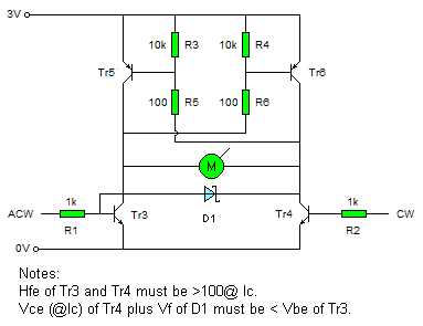

3v-h-bridge-hi-hfe-gif.32335
I'd recommend the BC64 for Tr5 and TRr6 (total cost of £1.18 for 5, from RS) and the ZTX690B (see my previous post) for Tr3 and Tr4.
NXP | Semiconductors | Discretes | Bipolar Transistors | PNP Small Signal
For the diode I'd recommend the BAT43, £4.23 for a pack of 10.
STMicroelectronics | Semiconductors | Discretes | Rectifier | Small Signal Diodes
I've avoided SMT components but if you don't mind soldering, they're cheaper.
I know buying multi-packs might seem like a pain but it'll build up your inventory.

The total cost of components comes to just over £10 which I don't think is expensive.

I forgot earlier that you're building five h-bridges which takes the total budget for all the components to £15.40 which still isn't bad in my opinion.
