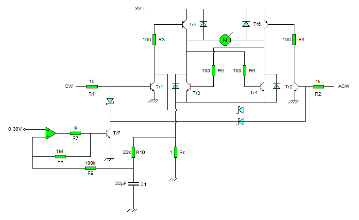

The stalled current of a DC motor is calculated by the voltage across it divided by its resistance. But the bipolar transistor cannot supply much current because its base current is too low.
So now it appears I'll need a way of limiting this current so that it doesn't draw a massive current while the motor is stalled, which could potentially damage both the transistors and the battery... I've used up all of my fingers and toes counting all of the problems that have been spawned by this 'basic' problem :eek:
You could use a PTC resistor (polyfuse/switch), I'd recommend 500mA.
Or there's the complex solution I posted before.
https://www.electro-tech-online.com/attachments/3v-h-bridge-ilimit-gif.32224/

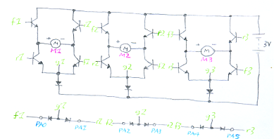

I'm fairly sure I just solved this problem with a schematic I just drew up; a diode will connect the ground portion of each H-Bridge to the actual ground, as well as to the two diodes leading to the uC ports for that motor. The H-Bridge current can simply pass through the diode to the battery ground, but each H-Bridge is isolated from the others since they each have a diode between them and ground.
I sent the (simplified) schematic to marcbarker since he seems to be the only one who has reviewed my original ground plan, but I'll attach it here as well.
Please bear in mind I used the original much simpler, but obviously non-functioning circuit to demonstrate the principle, but I will apply it to the working H-Bridges if the concept is sound.
fx, rx, gx labels refer to forward, reverse, and ground respectively, x from 1 to 3 referring to each motor's h-bridge. The labels are used to simplify the schematic. Sorry if the light green writing's a little unclear, it didn't scan as well as I had hoped.
You only have a 3V supply, you're losing a LOT of that in the H-bridge, you can't afford to lose the little that's left through an extra diode.
Won't all those diodes drop too much voltage for a 3V supply?
Hmm... how much voltage would I lose through the diodes? Maybe there's a way I can cut out a diode somewhere, there are a lot of diodes used... I can't see a way though.
You lose at least 0.7V with a normal silicon diode, more under heavy load.

By the way, 0.7V voltage loss per silicon diode = ouch :(
You could use Schottky diodes of course.

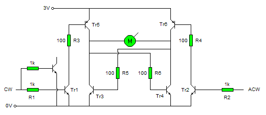

Here's how I would solve the shoot-through (forward and reverse at the same time) problem. One resistor, one transistor. It assumes that for a moment (a few nanoseconds) in a fault condition, that the fault current is beta limited.
Connect the collector of the 'new' transistor to the base of TR2. The base resistor of the 'new' transistor may be 10K.
I already solved that problem by adding a Schottky diode which uses less parts than your suggestion.
https://www.electro-tech-online.com/attachments/3v-h-bridge-gif.32205/
Your circuit does the same thing using a transistor. If you want to do it that way then I'd recommend increasing the base resistor on the new transistor to 10k.

Sorry hero, I didn't get a proper chance to look into the current-limiting addition you added to your schematic earlier, and I have a feeling it may take me a while to get my head around it anyway. If my grounding theory works the way it should the both-high problem should be solved though, and with any luck mneary may be correct about the motor's stall current not being a problem - I'll check that when possible.
I saw post #165. I missed that the diode was Schottky so I missed the significance. Vcesat of Tr1 and Vfd of the diode are less than the base turn-on of Tr2.
Your circuit is better because it uses fewer parts. My circuit uses parts the OP probably already has on hand.
