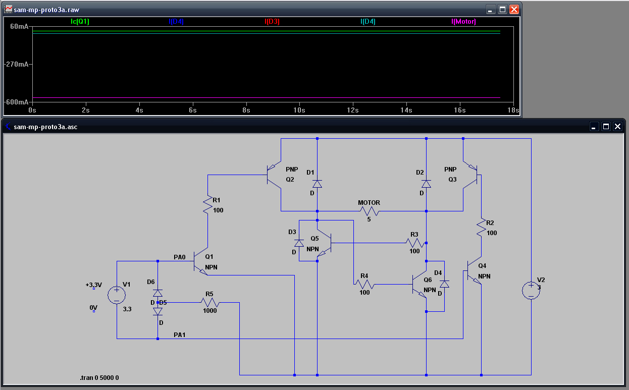

Okay I've modelled my modified version of Hero's schematic as best I can with LTSpice, but how do I monitor it using the simulation? :confused: I just get an empty graph with nothing marked on it when I try to simulate.

You need to press the Run button, then add Probes.

I've attached a screenshot of my attempt to adjust Hero's schematic and simulate it using LTSpice... probably unsuccessfully, on one or the other, or maybe both counts :eek:

You're missing a Ground symbol. All the voltage readings have to be referenced somewhere. Some simulators even crash without a ground.
Post the ASC file here if you like.

First big mistake is the input - you're assuming high voltages and big current capacity from the source - neither are likely to be the case.

Well that is the potential problem with simulations. Unless every characteristic is specifically included, they don't simulate PCBs, stray capacitance and manufacturing tolerances. Seasoned engineers know that for a simulation to fully represent realilty, some extra components (such as capacitance, inductance etc. are added to the simulation)
So what would can you suggest please Nigel, in order to make the simulation 'closer to reality' ? :)
I'm thinking of lumped resistance inserted in the 2.4 V source, how many milliohms do you think?
Here's the .ASC file attached

Do you think the nicad power source I simulated in brid.asc is good enough?
Anything you can think of how the simulation can be made closer to reality?
If Nigel + anyone else kindly adds whatever is needed to make the "2bjt/2fet" simulation (brid.asc) closer to reality, then what has been done here can be also applied to the hero999 circuit (sam-mp-proto3a.asc) which Giftiger is working with to improve it also. :)

The transistor with 150mA collector current and only 0.95mA base current will not saturate with only 0.14V Vce. It will have a loss of about 1V typically and might be worse.
If the base current for the transistor is increased so it can saturate with less loss then the output voltage of the resistance of the micro will have an increased voltage drop.
I don't know if the motor will start and run with only 1.2V or less.
I think the transistor should be an NPN common-emitter type driving a PNP common emitter type for plenty of current gain and low voltage loss.

I never use simulators, as you commonly have to modify circuits to make them simulate properly, I don't see as they are accurate anough for use.
It's the input from the processor that is completely wrong, you need to add the correct voltage output and impedance to drive the H-Bridge.
Notice the commercial H-Bridge I posted earlier uses driver transistors, this allows suitable voltage and current to switch the transistors sufficiently. One crucial part for that simple design is NOT to use NICAD's, as it relies on the internal resistance of the batteries to limit current to the motors. In simple tests I did (using a PJ996 battery) the motor took over 6A when stalled - and I'm pretty sure that was limited by the battery, NICAD's would be MUCH higher.
